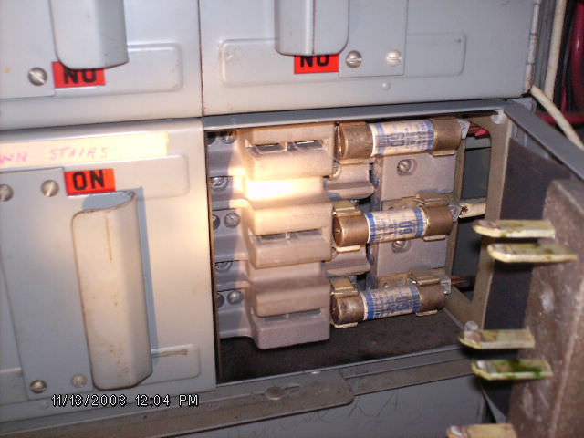

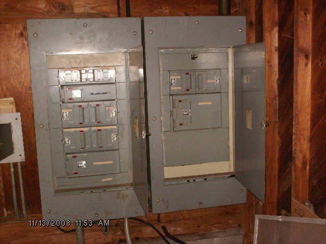

Phillip Posted November 14, 2008 Report Share Posted November 14, 2008 I have done 3 phase before but I have never seen panels like this in a home. Image Insert: 91.91 KB Image Insert: 117.73 KB Image Insert: 85.57 KB I have no question about them; I put them up for others to see. Quote Link to comment Share on other sites More sharing options...
qhinspect Posted November 14, 2008 Report Share Posted November 14, 2008 Looks straight forward for 3 phase but what were they supplying power to in a house? Quote Link to comment Share on other sites More sharing options...

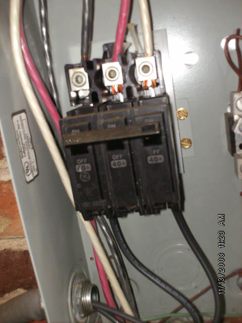

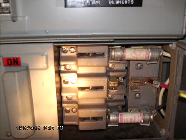

Phillip Posted November 14, 2008 Author Report Share Posted November 14, 2008 The only thing that was using 3 phase at this time was one of the AC units. Here are some of the ways they made changes. This is at the newer Heat pump unit which did not work. Image Insert: 81.84 KB Here is how they done it in the panel. Image Insert: 80.83 KB Quote Link to comment Share on other sites More sharing options...

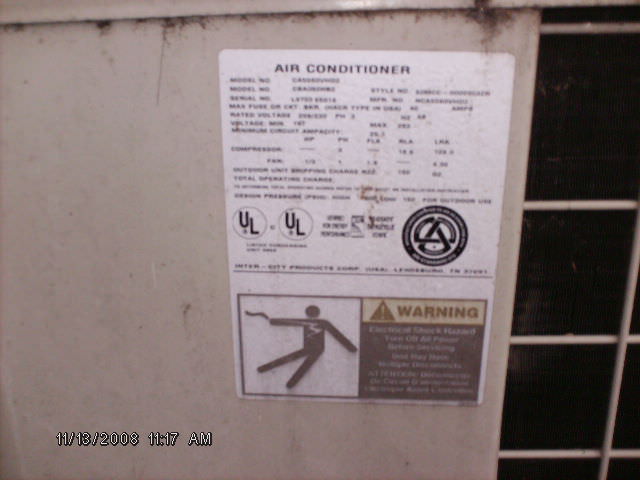

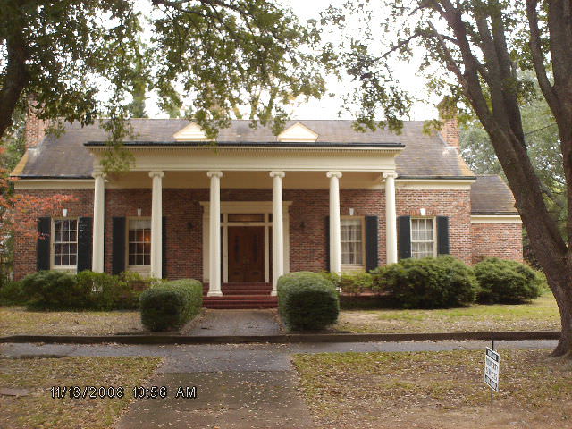

Phillip Posted November 14, 2008 Author Report Share Posted November 14, 2008 Here is the home. 6000 sq. feet built in 1958. Image Insert: 154.57 KB Here is the data tag from the unit. Image Insert: 66.9 KB Quote Link to comment Share on other sites More sharing options...
Phillip Posted November 14, 2008 Author Report Share Posted November 14, 2008 There is one older neighbor hood that the homes range for 1800 to 3000 sq. ft. that all 3 phase in my area. Quote Link to comment Share on other sites More sharing options...
Bain Posted November 14, 2008 Report Share Posted November 14, 2008 That data-plate's too fuzzy to read, but surely there's nothing in the house that requires three-phase power. Is it possible the installation of a three-phase service was intended to supply more juice to the house than the 60- or 100-amp service that was typical for 1958? Quote Link to comment Share on other sites More sharing options...
Neal Lewis Posted November 15, 2008 Report Share Posted November 15, 2008 Originally posted by Bain surely there's nothing in the house that requires three-phase power. The data plate says it's rated for 3 phase. Quote Link to comment Share on other sites More sharing options...
SonOfSwamp Posted November 15, 2008 Report Share Posted November 15, 2008 Might be a mechanic or wood shop on the property. I say this because my childhood house (1200 sq ft w/fuel oil heat) had a metal shop out back. The shop had 3 phase... WJ Quote Link to comment Share on other sites More sharing options...
Phillip Posted November 15, 2008 Author Report Share Posted November 15, 2008 No shop on the grounds. It was installed for the heating and cooling systems. There are lumber mills close by. This may be why there is 3 phase to the home. Quote Link to comment Share on other sites More sharing options...
qhinspect Posted November 15, 2008 Report Share Posted November 15, 2008 Originally posted by Phillip No shop on the grounds. It was installed for the heating and cooling systems. There are lumber mills close by. This may be why there is 3 phase to the home. That's surprising since back in the 50's the houses didn't require that much power. No air conditioners, maybe one TV, no computers, printers, etc. It sounds like the house doesn't have electric water heater, stove and furnace. I'm surprised nobody has switched completely over to single phase since then. Quote Link to comment Share on other sites More sharing options...
truevalue Posted November 17, 2008 Report Share Posted November 17, 2008 hi I live in lower westchester area and I live in a house was built in 1952 so is the rest of the houses on the block, all of them has 3 phase pannel, I was told by a con edison worker that around that time it was common in some areas to provide the 3 phase power was no code for it then. Quote Link to comment Share on other sites More sharing options...
Bill in Georgia Posted May 18, 2009 Report Share Posted May 18, 2009 Three phase power is more economical for motors than single phase. I wish I had it for my A/C. Lots of homes in Albany, Ga have three phase for their A/Cs. Some are in single phase panels with a three phase style breaker which has an input for the third leg and outputs for all three phases. I put a label in these types of panels that this breaker and the main breaker need to be turned off to remove all power from the building. Quote Link to comment Share on other sites More sharing options...

ghentjr Posted May 19, 2009 Report Share Posted May 19, 2009 So now that you all commented on the various aspects of 3 phase, how many of you picked up the white wire being used as a hot leg? The tripple 40 amp breaker only has two legs on one side, three on the other. Quote Link to comment Share on other sites More sharing options...
Norcal Posted December 20, 2009 Report Share Posted December 20, 2009 Three phase power is more economical for motors than single phase. I wish I had it for my A/C. Lots of homes in Albany, Ga have three phase for their A/Cs. Some are in single phase panels with a three phase style breaker which has an input for the third leg and outputs for all three phases. I put a label in these types of panels that this breaker and the main breaker need to be turned off to remove all power from the building. This is dredging up a ancient thread but what is being described in the above post is called a Delta Breaker & it is now prohibited by NEC section 408.36(E) (2005 edition) it 1st showed up as 384-16(e) in the 1978 NEC. The breaker pictured is a Cutler-Hammer CH360D. Quote Link to comment Share on other sites More sharing options...
