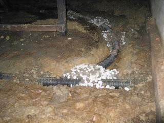

Richard Moore Posted February 18, 2009 Report Share Posted February 18, 2009 I have this 1992 townhouse inspection upcoming this weekend. Seller disclosed a crawl problem discovered during a previous inspection some months ago (deal fell through), and provided a series of photos, supposedly documenting the fix to a wet crawl discovered during a previous inspection some months ago (deal fell through). Buyer's agent sent me the photos. The agent didn't know all the details, but mentioned that what used to be a single pair of townhouses sitting alone are now surrounded closely by new construction. Also said there was something in the disclosure about "support issues"(?). I told the agent and client that they need to get full documentation on what was done, by who, and who is warranting the work, etc, etc. There's more photos, but I just posted the clearer ones (none higher res). It appears there was a sump pump originally (dunno if it was working). Wierd framing and what the hell is the black stuff on the posts. From the photos it looks like something applied rather than "mold". I'm very concerned that the footings seem to be level with the dirt and didn't get cleared before they laid down the moisture barrier. I'll be probing but I'm already not happy. And I have no idea about the adjoining home. Click to Enlarge 21.86 KB Click to Enlarge 23.39 KB Click to Enlarge 20.78 KB Click to Enlarge 22.18 KB Click to Enlarge 24.76 KB Click to Enlarge 18.66 KB Click to Enlarge 18.46 KB Quote Link to comment Share on other sites More sharing options...

Richard Moore Posted February 18, 2009 Author Report Share Posted February 18, 2009 What do they want you to do; bless it sight-unseen based on photos? No, it was a heads-up for a "normal" buyer's inspection. (Everett, not Burien) The referring agents (a couple) are good guys and I suspect they are actually concerned for the client. I'll see what I can see, but I doubt I'm going to bless much, if anything. I can't remember ever seeing creosote dipped posts around here. And...in at least one photo it looks brushed on rather than dipped. Do these hold up? Quote Link to comment Share on other sites More sharing options...

Richard Moore Posted February 18, 2009 Author Report Share Posted February 18, 2009 Those aren't good quality pressure treated, though. Them's a nasty pile o' rot in a few years. I'm definitely leaning that way. If you look at the photo below, you can see the black on the bracing. It's like the "creosote" was slopped on as an afterthought...which doesn't bode well for it being at the cut ends. Add the flush footings, the soaked soil, etc, etc and...well, this may be my first premeditated kill. I'll update in a few days. Click to Enlarge 34.57 KB Quote Link to comment Share on other sites More sharing options...
hausdok Posted February 18, 2009 Report Share Posted February 18, 2009 Afterthought is right. Check out the water line on the wall in the right of the 4th picture, on the far wall in the 6th picture and where it runs even with the top of the grade beam in the 7th picture. They had major flooding under that building in the past. ONE TEAM - ONE FIGHT!!! Mike Quote Link to comment Share on other sites More sharing options...

Jeremy Posted February 18, 2009 Report Share Posted February 18, 2009 Has anything been done to stop water from coming in? Can you see the drain outlet clearly? How many post are there? Are they on top of or sunk into footings? Is there damage to the floor structure? I know...You'll have more for us this weekend. If (may be a big IF) there is no floor structure damage and drainage is taken care of, maybe just the post will need addressing(replacing). May not be cheap, but sure enough, can be done. Have fun...You may not want to premeditate too far, just yet. Quote Link to comment Share on other sites More sharing options...

Garet Posted February 19, 2009 Report Share Posted February 19, 2009 How have they detailed the plastic around the base of the columns? Just wrapped it around the base of the wood? With large amounts of moisture in the ground, the moisture will be concentrated at the opening as air moves up out of the soil into the space above (stack effect). We mostly have steel posts in my market and a common problem is severe corrosion at the base. Wood will rot much faster, especially if the black goop was painted on as an afterthought and does not cover the bottom of the posts. Quote Link to comment Share on other sites More sharing options...
