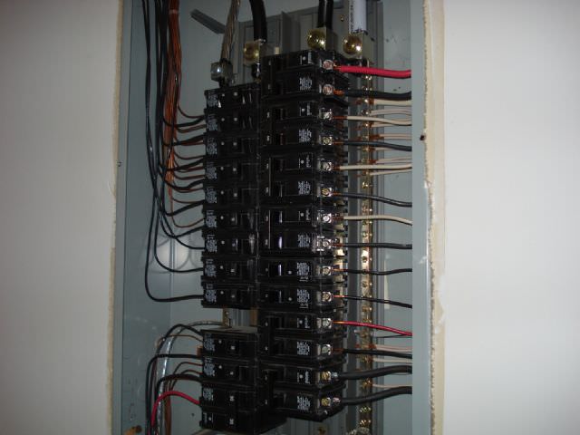

Bain Posted February 23, 2009 Report Share Posted February 23, 2009 I learned many years ago from a commercial electrician I'd subbed work out to that leaving too much copper exposed near breaker screws can lead to arcing and panel fires. Thing is, I've never learned if this is simply a best practice thing or if it's mandated by the NEC or the breaker manufacturers. I checked out the data-sticker on the panel from the below photo, but nothing was mentioned. So anyhow, I came across this panel this afternoon and thought I'd ask you guys rather than spend lots of time Googling. I know, I know. You gotta love my work ethic . . . Click to Enlarge 39.15 KB Quote Link to comment Share on other sites More sharing options...
Richard Moore Posted February 23, 2009 Report Share Posted February 23, 2009 It's not ideal, but your panel wouldn't worry me that much. You would have to have the exposed conductors an awful lot closer to each other or something else to create arcing. It does make working on the panel a bit more hazardous though as it negates the recessing of the live bits. Too easy to drop a grounding wire onto the exposed parts for instance. Quote Link to comment Share on other sites More sharing options...

Jim Katen Posted February 24, 2009 Report Share Posted February 24, 2009 Do you think it was incorrect to say the wires in the panel photo should have their ends trimmed, Jim? I don't think it's incorrect. It might be a tad anal, though. On the other hand, there are also the doubled-up neutrals in there. I mean, jeez, the guy has about 10,000 spare, unused neutral terminal screws (ok, I'm exaggerating). Why'd he have to double them up? Woof! If there's going to be an electrician around anyway to fix something else, I might advise cleaning up the crummy workmanship while he's there. Most electricians will charge a minimum 1 hr fee anyway and these things will give him something to do for the other 30 minutes. - Jim Katen, Oregon Quote Link to comment Share on other sites More sharing options...
