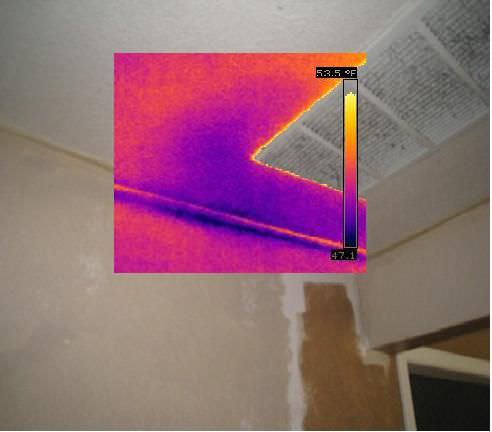

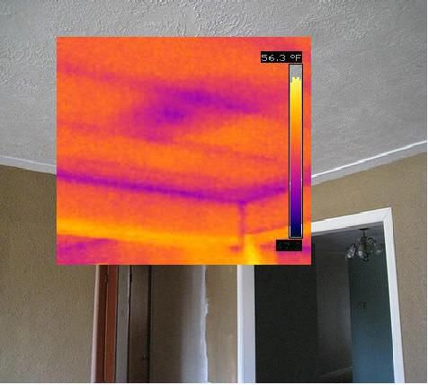

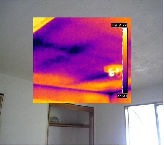

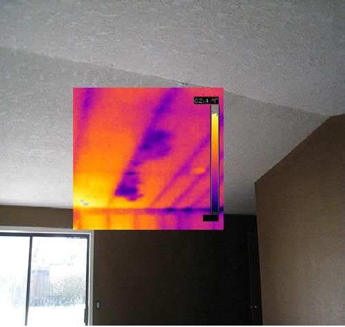

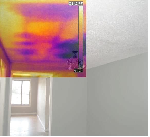

Chris Bernhardt Posted April 7, 2009 Report Share Posted April 7, 2009 Some IR pics of wet ceilings in a POS house. They only knew of the leaking at the skylight not the leaks over the kitchen, dining, living, hallway and bedrooms. There was no visible wetness on the roof decking and framing in the attic although there was some staining. I probed the decking and framing with my moisture meter, which indicated about 14% MC in my small sample. Other than the stains at the skylight, there was no visible evidence from the interior that the ceilings were damp. Even looking at the insulation from the attic, it wasn't readily apparent to me things were damp. Click to Enlarge 27.34 KB Click to Enlarge 32.44 KB Click to Enlarge 45.22 KB Click to Enlarge 26.29 KB Click to Enlarge 32.02 KB Click to Enlarge 29.27 KB Click to Enlarge 31.14 KB Click to Enlarge 30.32 KB Click to Enlarge 23.16 KB The interesting thing was that I scanned the interior first before I turned the heat on (interior temps started at around 45 degrees) and found some things, but after I stepped the temperature up to 60 degrees, a bunch more damp areas popped out. It was great example of moisture's thermal lag. Also I did not feel any humidity, but the vapor pressure was up over 14 millibars. Chris, Oregon Quote Link to comment Share on other sites More sharing options...
Terence McCann Posted April 7, 2009 Report Share Posted April 7, 2009 Chris: Are all those areas active leaks or just temperature differences due to the home being at 45 degrees at the beginning of the inspection? Is it possible that the framing members just warm up slower than drywall? Last question, if in fact all those areas are wet did you cross check with your moisture meter? Findings? I lied, one more question, do you present this to the buyer and inform them that they have active leaks in all these areas? Not having been through IR training I'm out of my comfort zone. Quote Link to comment Share on other sites More sharing options...
Chris Bernhardt Posted April 7, 2009 Author Report Share Posted April 7, 2009 Are all those areas active leaks or just temperature differences due to the home being at 45 degrees at the beginning of the inspection? When I pulled up to the house, the roofer was just finishing up on the new roof. Is it possible that the framing members just warm up slower than drywall? Yes and no. There's a larger temp diff across the framing then the drywall. If you step temps you'll also see differences due to the thermal mass of the assemblies you're looking at. If the temp diff on the inside and the outside is the same and stays the same then the different masses will eventually come to same temperature and you won't be able to distinguish anything. Last question, if in fact all those areas are wet did you cross check with your moisture meter? Findings? Yes. What I have found is that if the back of the drywall is wet, a surveymaster or an Aquant will barely detect it, but a tramex moisture encounter plus will peg the meter. In this case the drywall was so damp my Aquant was pegging. I lied, one more question, do you present this to the buyer and inform them that they have active leaks in all these areas? All that anyone knew about was leaking at the skylight. They had no idea that the roof had been leaking all over the place. Not having been through IR training I'm out of my comfort zone. I have not been thru the $1800 ($3600 if you add cert II) training either. I'm waiting to get it for free or when the unrealistic pricing drops to something more reasonable. Chris, Oregon Quote Link to comment Share on other sites More sharing options...
