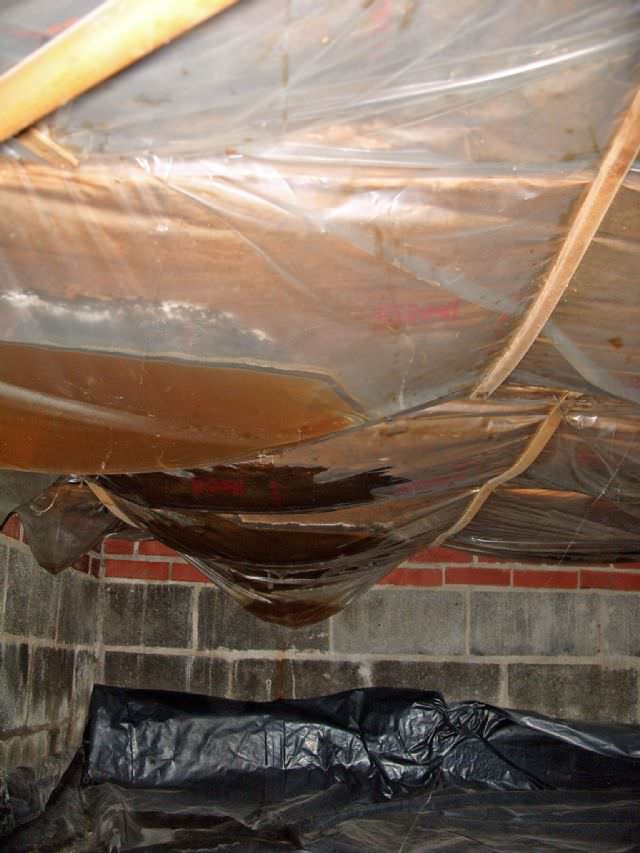

elgato Posted April 13, 2009 Report Share Posted April 13, 2009 The sellers said that they had a small leak in a radiator pipe. They fixed it, and refinished the floor. All is well........then I made my way to the crawlspce. Click to Enlarge 84.79 KB Quote Link to comment Share on other sites More sharing options...
Scottpat Posted April 13, 2009 Report Share Posted April 13, 2009 That is another good reason not to put plastic up on the joist, instead of the ground! Quote Link to comment Share on other sites More sharing options...
Mike Lamb Posted April 15, 2009 Report Share Posted April 15, 2009 Was all of the water isolated in this area? Condensation, not a plumbing leak, could account for gallons of water. As Scott intimates, plastic under the joists is a hugely bad idea. Quote Link to comment Share on other sites More sharing options...
AHI in AR Posted April 15, 2009 Report Share Posted April 15, 2009 I can't see how condensation would account for that amount of moisture under the floor. In fact, I would say that it can't. It's hard to imagine that the flooring was laying flat unless the refinishing was very, very recent. The absurd amount of moisture present under the flooring would cause a floor to swell, leaving a concave surface on the top side. Quote Link to comment Share on other sites More sharing options...
Mike Lamb Posted April 15, 2009 Report Share Posted April 15, 2009 I have seen absurd amounts of water sitting on plastic in a crawl space. All from condensation. It's a wrinkle that shouldn't be discounted. I was wondering if the water was isolated. Quote Link to comment Share on other sites More sharing options...
