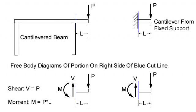

Jim Katen Posted June 29, 2009 Author Report Share Posted June 29, 2009 Try looking at it this way: The following two diagrams represent two different types of beams. Let's call them A & B. They both have sections that project beyond their supports and that bear weight out at the unsupported end but they resist that weight in different ways. Click to Enlarge 35.53 KB Click to Enlarge 29.35 KB Would you agree with me that these two different types of beams ought to have different names? Oddly enough, pretty much everyone calls them both "B", even though B is far more rarely used than A. I find that curious. Does anyone else? After some consideration, I think that the word cantilever has gained wider accepetance mostly because it sounds cool. Kurt asked about cantilever bridges. In my lexicon, there are two types. Some are made up of genuine cantilevers that are embedded in the earth at the banks. Others use overhangs at each side to support a center section. But all of them are called cantilever bridges. Might it be because no one would want to spend $250 million on something as dorky sounding as an "overhanging bridge?" I'd like to hear some opinions from the engineers & architects on this forum. How do you explain the disconnect between the beam diagrams and the common broad brush use of the word cantilever? - Jim Katen, Oregon Quote Link to comment Share on other sites More sharing options...

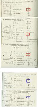

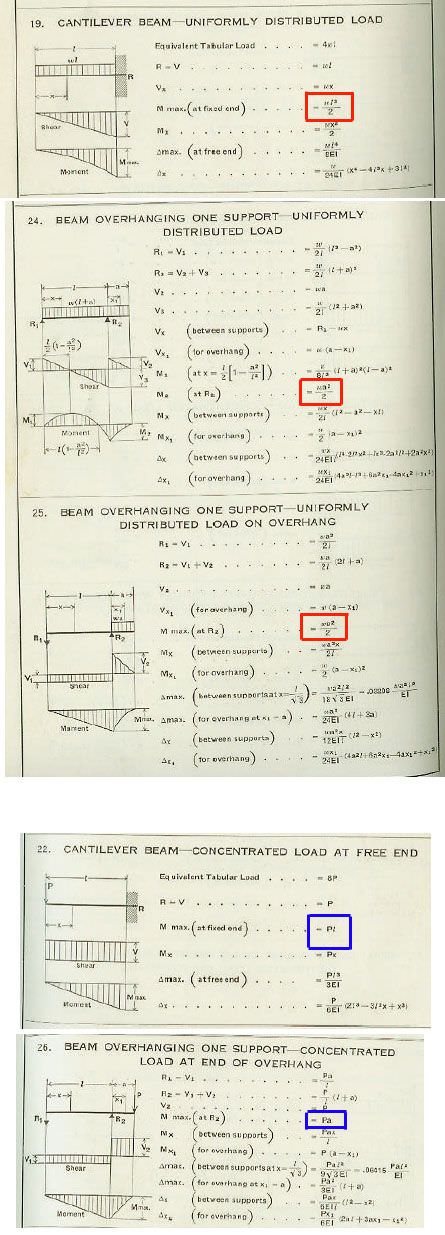

Brandon Whitmore Posted June 29, 2009 Report Share Posted June 29, 2009 BTW, I disagree with Jimmy about the AWC's stance on deck attachment. I think that when they say cantilever, they really mean what he & I call an overhang. (Even though they publish a set of beam diagrams that defines a clear distinction between the two.) The AWC disagree as well. They specifically call the thingymajigs overhangs in this: http://awc.org/Publications/DCA/DCA6/DCA6.pdf , and specifically indicate that overhangs should not support a deck. By the way Jim, now I need to learn how to read engineering shear/ moment diagrams. My head is gonna hurt the rest of the night-- thanks a bunch. Quote Link to comment Share on other sites More sharing options...

Jim Katen Posted June 30, 2009 Author Report Share Posted June 30, 2009 . . . The myriad of equations Jim posted define loads and deflections both in the cantilevered portion and within the span between the supports of the extended version. If you look only at the loads, and look only at the cantilever/overhang portion, that seething mass of mathematics simplifies to the same values for both configurations (as I've highlighted below). . . . But of course they're the same. I never said that they were different. My point is that the supports are different. - Jim Katen, Oregon Quote Link to comment Share on other sites More sharing options...

FrankWoeste Posted July 5, 2009 Report Share Posted July 5, 2009 Perhaps we could get Dr. Woeste to offer his opinion? Turns out he already has. See June '09 JLC, p19. BTW, he uses the term 'cantilever' when the joist extends out beyond the foundation. (neener neener neener!) Actually, there is a technical difference. In the case of a cantilever structural model, the "slope of the elastic curve" at the support point is zero (no rotation). In the case of a beam overhang, the slope of the elastic curve at the bearing location next to the overhang is, in general, non-zero. At the bearing location, the rotation of the beam or (elastic curve) can be counterclockwise, zero, or clockwise depending upon the loads on the entire beam. The term cantilever seems to convey the issue easier when talking about or writing about a deck being attached to one. Quote Link to comment Share on other sites More sharing options...
