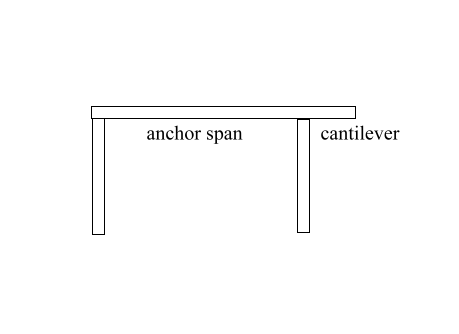

Bill Kibbel Posted June 27, 2009 Report Share Posted June 27, 2009 I'm not sure if butting in will put an end to Jim & Kurt's playtime, but their debates always go over my head. In engineering, the term cantilever originally was used to describe a projecting beam, anchored at one end. In architecture, cantilever was also used to describe a projecting beam used as a bracket to support another structure or member. Since well over a century ago, the portion of a beam (or truss) extending beyond a support has been commonly referred to as a cantilever (or cantilever arm). If the beam is supported at two points but extends beyond one of the supports, the portion extending beyond a support is still a cantilever (or cantilever arm). The portion of that beam spanning the two supports is then called the "anchor span". Mod - This thread should be split. Quote Link to comment Share on other sites More sharing options...

hmiller Posted June 27, 2009 Report Share Posted June 27, 2009 I am certainly missing something in this discussion. And thinking that maybe I could learn something. So I will ask, if Bills' diagram above is that of a cantilevered floor joist system, then what does an overhanging floor system look like? The tree branch concept has me perplexed, as it relates to nothing I can think of in home construction. Quote Link to comment Share on other sites More sharing options...
Jim Katen Posted June 27, 2009 Author Report Share Posted June 27, 2009 I am certainly missing something in this discussion. And thinking that maybe I could learn something. So I will ask, if Bills' diagram above is that of a cantilevered floor joist system, then what does an overhanging floor system look like? The tree branch concept has me perplexed, as it relates to nothing I can think of in home construction. Bill's diagram shows an overhanging beam. It has a negative reaction at the end opposite the load. He -- and pretty much everyone else in the English-speaking world -- refers to the overhanging portion as a cantilever. A real cantilever, however doesn't overhang anything. Look at the beam diagrams in my previous attachment. The end of a cantilevered beam is entirely captured inside a support. A tree branch, an extended human arm, and a flagpole are examples of cantilevered beams. Some spiral staircases have cantilevered supports under each tread; the supports are only attached to the center column. You'll find very few true cantilevered beams in wood-frame construction. - Jim Katen, Oregon Quote Link to comment Share on other sites More sharing options...
Bill Kibbel Posted June 27, 2009 Report Share Posted June 27, 2009 I believe that Jim and Jim are only sticking with the strict engineering definition of cantilever. Click to Enlarge 44.48 KB I've pointed out that the term cantilever, in building architecture, has been used as the name of the overhanging portion of a beam or truss for over 100 years. This includes well-known early published architects, engineers, university professors and Fellows of AIA, all considered experts by their piers and contemporaries. I hardly think they are among those of us who "jumbles up the terms". I've noticed a few words in the English language that have more than one definition. I've also noticed a few words now used in architecture, were earlier used to describe something completely different. Quote Link to comment Share on other sites More sharing options...

Jim Katen Posted June 27, 2009 Author Report Share Posted June 27, 2009 Architecturally, which is what I thought we talk about in TIJ, these mean mean different things than in bridge building or high steel construction. No. They don't. People use and misuse the term cantilever on bridges & high steel construction in the same way they use it and misuse it for residential architecture. The beam diagrams apply to all beams, whether they're in a high rise or in a kitchen countertop. It's all the same terminology and the same principles, just on a different scale. Historically, as shown by Bill, these terms are used in ways that are markedly different. I don't know how one can take definitions from one field of study and apply them to another in the way they're being applied here, implying that any idea different than that proposed by some professor from long ago and far away is jumbled. I think you're missing my point. Let me explain more clearly. 1. (Fact.) A cantilevered beam and an overhanging beam are two different structural entities. Each reacts to loads in a different way. It doesn't matter if the beams are part of a bridge, a high rise building, a residential building, or a doghouse. This isn't a matter of opinion or conjecture. This is a simple fact. Anyone who designs these beams will have to understand their different properties. 2. (Fact.) At one time, someone (I don't know who, very likely the Astronomer Royal) decided that one should be called a "cantilevered beam" and the other an "overhanging beam." These terms have been used consistently for a long time -- well over 100 years anyway. (BTW, I found an excellent collection of beam diagrams here: http://www.awc.org/pdf/DA6-BeamFormulas.pdf ) 3. (Fact.) During this same period of time, people have used the term, "cantilever" to describe any portion of a beam that extends past it's suppport. They do this regardless of whether the beam is a cantilever or an overhang. 4. (My opinion.) Using one term to describe two entities can be confusing and inaccurate, especially when each entity has its own perfectly good term. I find it similar to the misuse of the term "tuckpoint" -- hey, everyone knows what you mean, so what's the problem? I've met masons who've been working with brick & mortar their whole lives and they use (misuse) the term tuckpoint. Surely it must be ok. Or the term "telephone tile" in lieu of "structural terra cotta." Hey, everyone says telephone tile. How about "neutral wire?" Or "cinder" block? Copper "pipe?" How about "level" when they mean "plumb." Construction is full to the brim with words that are used inaccurately. For the most part, everyone understands what people really mean. But it's important to remember what the real terms are. - Jim Katen, Oregon Quote Link to comment Share on other sites More sharing options...
