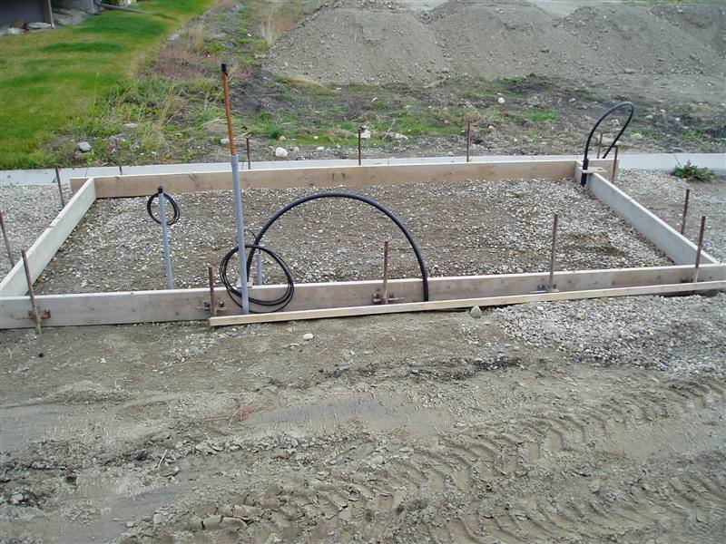

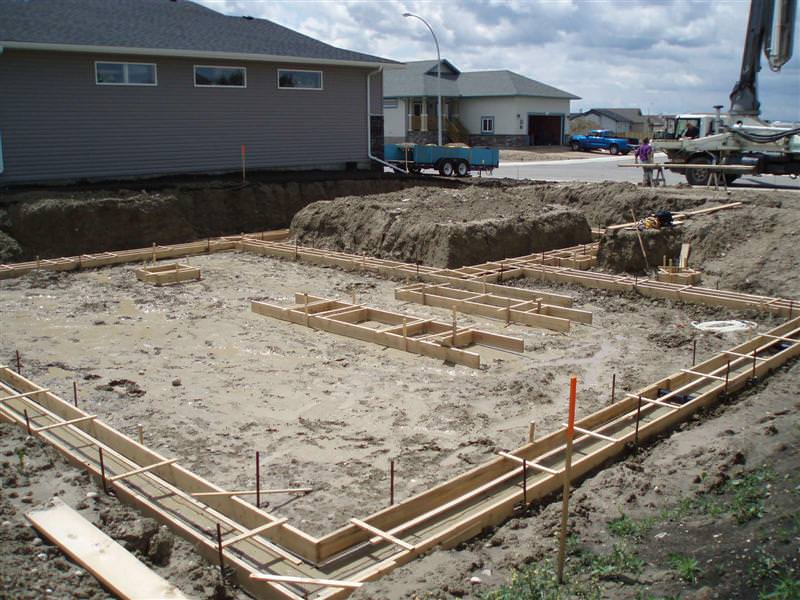

RobC Posted August 18, 2009 Report Share Posted August 18, 2009 This is how I form my strip footings The piece of wood suspended in the middle top of the form is the keyway that we are talking about. It is beveled for easy removal. Download Attachment: FdnStripFormsKeyway (Medium).jpg 116.65 KB This is what it looks like when stripped. Download Attachment: FdnStripKeyway (Medium).JPG 134.13 KB I feel your pain, this project is getting off to a poor start and you need to get proactive NOW before it escalates into a complete dogs' breakfast. Quote Link to comment Share on other sites More sharing options...
gtblum Posted August 18, 2009 Report Share Posted August 18, 2009 This is how I form my strip footings The piece of wood suspended in the middle top of the form is the keyway that we are talking about. It is beveled for easy removal. Download Attachment: FdnStripFormsKeyway (Medium).jpg 116.65 KB This is what it looks like when stripped. Download Attachment: FdnStripKeyway (Medium).JPG 134.13 KB I feel your pain, this project is getting off to a poor start and you need to get proactive NOW before it escalates into a complete dogs' breakfast. Never seen that done that way before. You must have to take an awful lot of time setting those forms so the top is exactly at the grade line. I've always set the forms, snapped a grade line, and dropped the key after the pour. It sure is pretty though. Quote Link to comment Share on other sites More sharing options...
RobC Posted August 18, 2009 Author Report Share Posted August 18, 2009 Once you shoot your forms, placing the concrete is a breeze, just fill em and strike. I'd rather set the keys in their exact locations, I find that if you set the keys after they tend to float or move about. Accuracy is important if you do this Download Attachment: Logix3Rows (Medium).JPG 96.29 KB Quote Link to comment Share on other sites More sharing options...

Jeff Remas Posted August 19, 2009 Report Share Posted August 19, 2009 Wow, nice form job. I can't believe you took the time to get the top of the form to exact elevation. Normally we use finish nails to mark the elevation where we snapped a chalk line inside the oversized forms. No rebar in your seismic zone? Quote Link to comment Share on other sites More sharing options...
Jim Katen Posted August 19, 2009 Report Share Posted August 19, 2009 Wow, nice form job. I can't believe you took the time to get the top of the form to exact elevation. Normally we use finish nails to mark the elevation where we snapped a chalk line inside the oversized forms. Really? I can't recall having ever seen that done in New England or in Oregon. If I'm recalling right, every time I've ever formed up footings, we set them to elevation and used the top of the forms as a screed. This is what I'm accustomed to seeing. Heck, I thought this was a pretty universal method. Click to Enlarge 79.88 KB - Jim Katen, Oregon Quote Link to comment Share on other sites More sharing options...
Tom Raymond Posted August 19, 2009 Report Share Posted August 19, 2009 "This is what I'm accustomed to seeing. Heck, I thought this was a pretty universal method." I have to agree. The trench footings that started this thread are usually reserved for detached garages and small additions, and those are set only loosely to grade, what ever is going on top gets adjusted to meet elevation requirements. Tom Quote Link to comment Share on other sites More sharing options...
RobC Posted August 19, 2009 Author Report Share Posted August 19, 2009 Wow, nice form job. I can't believe you took the time to get the top of the form to exact elevation. Normally we use finish nails to mark the elevation where we snapped a chalk line inside the oversized forms. No rebar in your seismic zone? Thank you, The strip footings are THE most critical portion of the building process. I like to get started on the right foot otherwise the project is a series of patches, compromises and bad problem solving decisions. If you look closely you'll notice two bars hanging from the cross braces and two more resting on grade that will be lifted once the concrete is poured. Generally, builders don't place rebar in footings and only a few in the walls, usually at the top. After all, we want to keep the foundation remediation companies in business. Another story for another time. I treat all foundations with the same respect, care and attention whether it's an addition, garage or shed. You don't want to make a mistake here that will affect the entire project. Download Attachment: ExtLandscapeShedForms(Medium).jpg 132.57 KB Download Attachment: ExtLandscapeShedServices (Medium).jpg 116.69 KB This shed will stand 5" above grade to avoid moisture entry at the sill plate. It includes a gas line, water, electricity and a 4 pair direct burial communication line. Notice the slab thickening at the edges. Quote Link to comment Share on other sites More sharing options...
gtblum Posted August 19, 2009 Report Share Posted August 19, 2009 Nobody said it was wrong. It'$ ju$t more time con$uming than $etting form$ and $napping a grade line. If you used that method on a commercial job, Somebody would be getting your check. Quote Link to comment Share on other sites More sharing options...
kurt Posted August 19, 2009 Report Share Posted August 19, 2009 I guess I'm all mixed up. I thought it was "easier" to do it Rob's way. Reason being, it's more involved on the front end, but it's less involved on the "back end", meaning the rest of the job, because everything starts out on the correct foot(er). Either way, I'm liking seeing the Canadian way. I want to see the insulated forms in process. Quote Link to comment Share on other sites More sharing options...

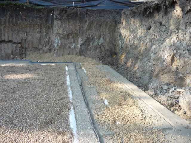

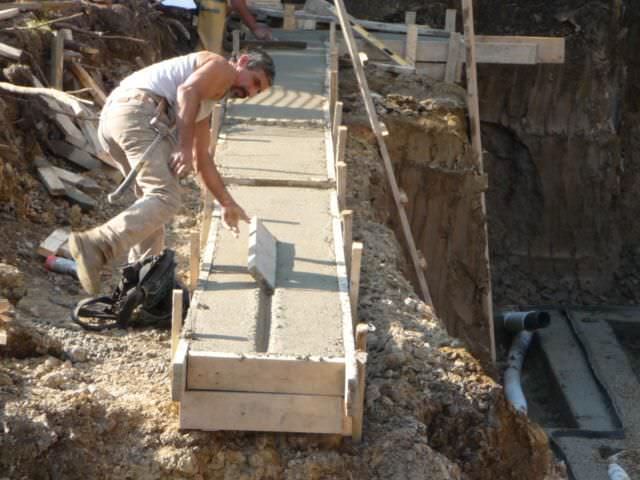

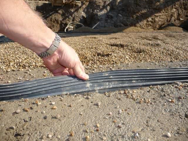

kurt Posted August 19, 2009 Report Share Posted August 19, 2009 Not quite as elegant as Rob's method........ Click to Enlarge 62.69 KB This is the rubber I was talking about. It breaks the capillary path between the footing and the foundation. Click to Enlarge 79.63 KB Close up of the rubber; it's a nice step to provide that additional assurance water won't find it's way in. Interior and exterior drain tile is a nice way to go too. Click to Enlarge 82.3 KB Quote Link to comment Share on other sites More sharing options...
RobC Posted August 20, 2009 Author Report Share Posted August 20, 2009 Not quite as elegant as Rob's method........ Click to Enlarge 62.69 KB Ok! I have to ask the question How is he able to do that without a handle? lol Quote Link to comment Share on other sites More sharing options...
RobC Posted August 20, 2009 Author Report Share Posted August 20, 2009 This is the rubber I was talking about. It breaks the capillary path between the footing and the foundation. Click to Enlarge 79.63 KB Close up of the rubber; it's a nice step to provide that additional assurance water won't find it's way in. Interior and exterior drain tile is a nice way to go too. Click to Enlarge 82.3 KB I've seen this rubber gasket specified at control joints for commercial jobs such as dams, vats or large retaining walls but never on residential. I'm thinking we may get back to this detail as we progress. Quote Link to comment Share on other sites More sharing options...
kurt Posted August 20, 2009 Report Share Posted August 20, 2009 You know, he just kind of hangs on and pulls it down the line. Then they stuff the rubber in there with a wide knife, and touch it up with a masons trowel. Sounds clumsy, but these guys place a nice foundation. This particular house has a very substantial amount of finished space below grade, it's deep) and it's finished very, very nicely. The customer was adamant about no water. Zero. Understood. That means the gasket, interior and exterior drain tile, and that green slime damproofing on the exterior, all the way out over the footing. Lots of redundancy in this one, but it's one of those things you don't want to wish you'd done when you had the chance. Quote Link to comment Share on other sites More sharing options...
RobC Posted August 20, 2009 Author Report Share Posted August 20, 2009 Reason I'm asking cause it looks like someone erased (Photoshop) the handle off the 2x. If you look at his hands you could fit a handle there to make the work easier. But then I would have used a garden hoe. Anyway, that's another method of doing it and perfectly acceptable as long as you have the man power. I placed those footings with one helper and that requires all formwork ready to go when the pumper and concrete truck arrive on site. I wouldn't have had the time to go back and rake in a key at least not in the temperatures I was working in. Does your vertical keyway gasket apply to this kind of construction detail? Download Attachment: 0245 (Medium).JPG 82.25 KB Quote Link to comment Share on other sites More sharing options...
kurt Posted August 20, 2009 Report Share Posted August 20, 2009 I suppose it would apply to any keyway detail, I'd guess...(?). Honestly, I thought it was overkill, but I like overkill. Like I said, the bsmt. was deep (about 10'), and the guy was adamant about absolutely bone dry. I figured the gasket was worth it (it was another $450 for the entire foundation). If you're doing your footings with only one helper, I'm really impressed now. That's an ass kicker. Quote Link to comment Share on other sites More sharing options...
