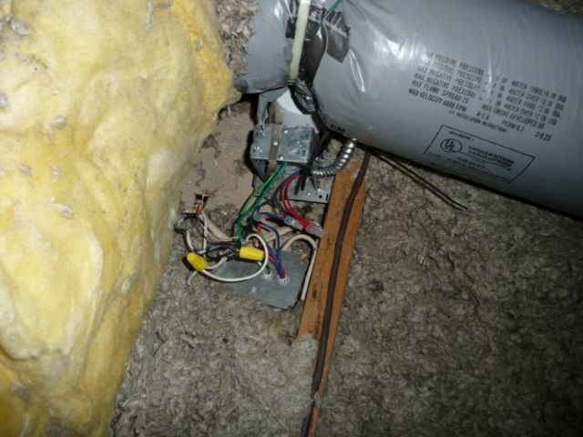

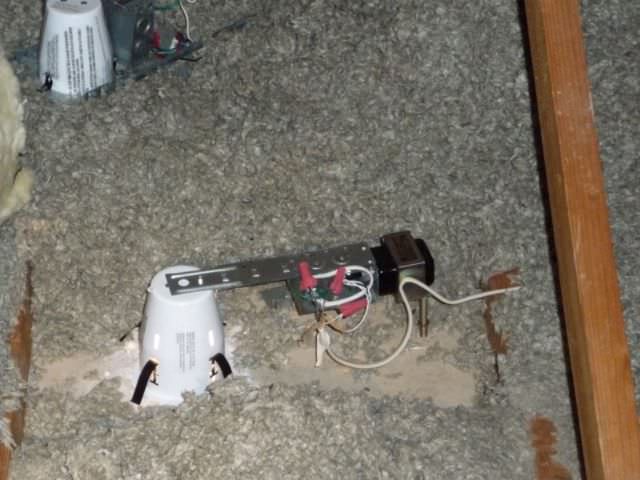

Robert Jones Posted November 5, 2009 Report Share Posted November 5, 2009 Does this install look correct to you? I am reading that connectors are ok. Just seems to me like the wires should be located in a connection box. When the insulation is properly distributed, wouldn't those wires become and issue? Click to Enlarge 66.53 KB Click to Enlarge 60.57 KB Click to Enlarge 54.22 KB Quote Link to comment Share on other sites More sharing options...
resqman Posted November 5, 2009 Report Share Posted November 5, 2009 No, that is not OK. In the first pic, they used electrial tape instead of wire nuts. That is wrong. In the 2nd and 3rd pics you can see that there is an open junction box with the wires sticking out. The wire connections must be inside the box with a cover. Wire connections must always be inside a covered juction box. No open wire splices (except low voltage wiring like HVAC thermostat) Quote Link to comment Share on other sites More sharing options...
Brandon Whitmore Posted November 5, 2009 Report Share Posted November 5, 2009 Nothing about those pictures is correct. There's wiring issues throughout, along with clearance issues to combustibles. My recommendation would be to have an electrician replace those non- IC rated fixtures (I'm guessing that some of the stickers will say "warning, do not install combustible materials within 3" blah, blah, blah, but could be wrong) with IC rated ones, air seal everything, re- wire the mess, add insulation , secure the wires, etc. Quote Link to comment Share on other sites More sharing options...

resqman Posted November 5, 2009 Report Share Posted November 5, 2009 Read the International Residential Code, IRC, instead of DIY stuff from questionable sources. Lots of good information about the way things must be done. Of course for electrical the NEC is a good choice. The IRC electrical section only deals with residential electrical and is basically the NEC condensed. No open wire splices, ever. All wiring must be inside an approved electrical box with a cover. Boxes contain and limit fire. The lights in your photos include integrated electrical boxes. The wiring is required to be completely inside the box with the cover attached. Quote Link to comment Share on other sites More sharing options...
Billy_Bob Posted November 5, 2009 Report Share Posted November 5, 2009 When you connect two wires together, the connection can come loose and then sparks can fly all over the place! Or connections can be "not so good" and they will heat up and get quite hot. For that reason, you MUST have all wiring connections inside an enclosed electrical box. This keeps the sparks/heat inside and away from combustible materials. (That is house 120 volt and higher voltage wiring.) Things like this can happen... Quote Link to comment Share on other sites More sharing options...
Jim Katen Posted November 6, 2009 Report Share Posted November 6, 2009 Clearly, the splices in Rob's pictures are supposed to be contained within the boxes that are included with the can lights. I hope everyone understands that now. It's not quite true, however, that *all* electrical splices have to be contained inside boxes. There are connectors that are UL listed and perfectly acceptable to use with #12 or #14 NM cable and that don't need to be installed inside boxes. In fact, in an existing building, you don't even need to leave them accessible. You can bury them behind wallboard. They've been around for years, check them out here: http://www.ampnetconnect.com/documents/ ... 123%5D.pdf - Jim Katen, Oregon Quote Link to comment Share on other sites More sharing options...
