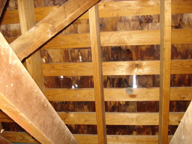

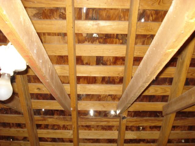

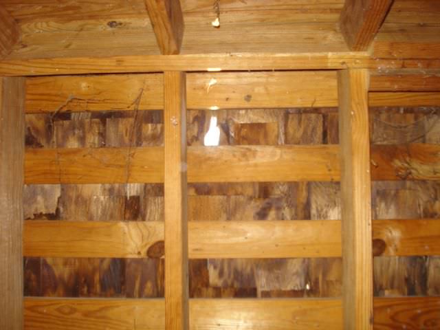

Bain Posted December 1, 2009 Report Share Posted December 1, 2009 I'd never seen this kind of venting before, but apparently it works really well. There were very few signs of moisture problems in the attic. Click to Enlarge 55.63 KB Click to Enlarge 57.87 KB Click to Enlarge 47.43 KB Click to Enlarge 59.19 KB Click to Enlarge 65.04 KB Click to Enlarge 93.06 KB Quote Link to comment Share on other sites More sharing options...

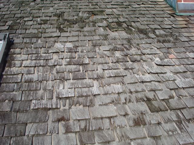

hausdok Posted December 2, 2009 Report Share Posted December 2, 2009 Looks like shingles to me; not shakes. To thin and too consistent in thickness. The lack of underlayment woven into those courses is a dead giveaway. As for the venting method, most squirrels and rats would call those grand entrances and most crows would call them deposit boxes. ONE TEAM - ONE FIGHT!!! Mike Quote Link to comment Share on other sites More sharing options...
kurt Posted December 2, 2009 Report Share Posted December 2, 2009 Yeah, shingles. Sawn, not riven. If they were triple coverage, it might work fine. Since it's not, it's dumpster food. Quote Link to comment Share on other sites More sharing options...

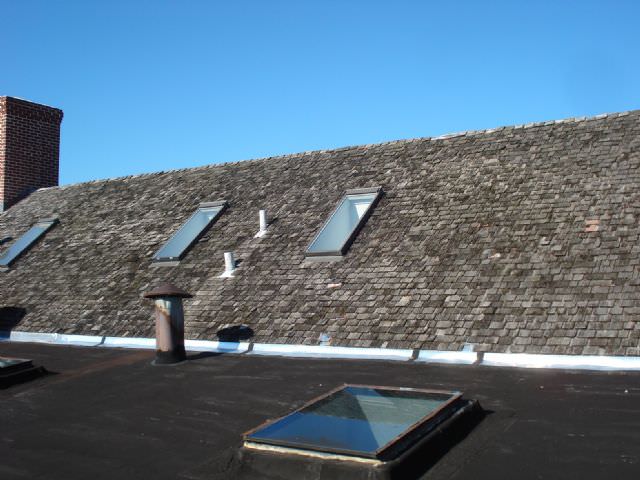

Bain Posted December 2, 2009 Author Report Share Posted December 2, 2009 There aren't a lot of wooden roofs in my area; I look at maybe one a year. When I scheduled this building last week, knowing it had a wooden roof, I fully anticipated posting scads of photos so youse guys could tell me what was going on with it. But then I arrived at the site yesterday, saw the condition of the shakes shingles, and it became a no-brainer. Quote Link to comment Share on other sites More sharing options...
hausdok Posted December 2, 2009 Report Share Posted December 2, 2009 I should have commented on the condition. Shingles can easily last at least two or three times as long as a shake roof that received the same amount (or sees the same lack of) maintenance. Some idjit's been on that roof blasting away with a pressure washer and had stripped a lot of those shingles so badly that they're now paper thin below the butts. That roof is a good example why I think we home inspectors should be issued hunting licenses and be allowed to bag our limit of folks using pressure washers to clean roofs. I can see Les now, careening down the street on the way to the taxidermist with some Larry the Cable Guy type strapped across the hood of his truck. [] ONE TEAM - ONE FIGHT!!! Mike Quote Link to comment Share on other sites More sharing options...

Brandon Whitmore Posted December 2, 2009 Report Share Posted December 2, 2009 But don't think my possession of the manual gets you off the hook for answering questions next time I find myself looking at a wooden roof. Fire away. Just so you know, if you don't see felt paper (interlayment) with no cedar showing from the attic side, you can pretty much bet on the fact that it is a shingle roof or a very messed up shake one. Quote Link to comment Share on other sites More sharing options...
waynesoper Posted December 4, 2009 Report Share Posted December 4, 2009 I bet the broker asked you "well, is it leaking"? That roof is the same age as the house and my guess would be somewhere around 30 years. Quote Link to comment Share on other sites More sharing options...

Paul N Frey Posted December 14, 2009 Report Share Posted December 14, 2009 That roof "has reached the end of it's useful life" as we say here in Oregon. If the RE agent wants to guarantee it let him put it in writing, otherwise stick to your guns and fail it. This roof was a replacement item years ago - missing shingles, etc. There will always be damage to the bottom butt ends after a few years (this is normal aging) but when you can lift up the butt end and break the shingle at the overlap they are done. Looks like a ----- shingle to start. FYI - I have been in many attics where you could read a book from the amount of light coming thru the shingles (they leaked) but the old timer mentioned had it right - the shingles swell after the first rains and do a pretty good job of being weatherproof - as long as they are in reasonably good condition. This roof is not! I wouldn't have even walked it due to the visible damage that you can see. Quote Link to comment Share on other sites More sharing options...
Inspector37620 Posted December 16, 2009 Report Share Posted December 16, 2009 Your lucky you didn't take a fast ride to the ground. Wonder if he had his golf shoes on walking on that roof? From the holes in the roof looks like #2 shingles and the knots popped. I have seen roofs in that bad of shape and they were not ever power washed, just old and worn out. Quote Link to comment Share on other sites More sharing options...
