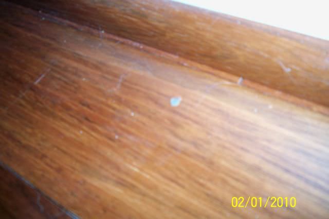

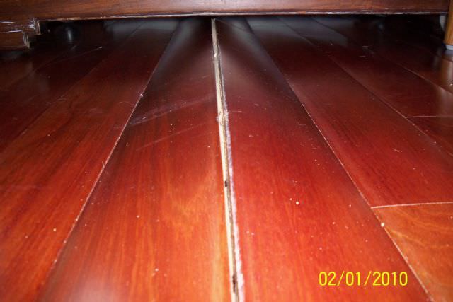

mgbinspect Posted February 2, 2010 Report Share Posted February 2, 2010 And another hearty good morning regarding the same home. Here are some lovely pictures of a floating wood floor system: According to the box it's DURENBC 3/8 X 3 ENGINEERED PREFINISH SCHON 30 BRAZILIAN CHERRY It has developed some wicked buckles. The buyers informed me that the builder's fix-it guys came out and started nailing the floor down to get rid of the buckles, which seemed like an IMMEDIATE red flag to me. I assume the buckles came from not leaving enough expansion/contraction room at the perimeter and face nailing the outer pieces was the exact opposite of what should have been done. They have more material, so I'm recommending they replace the nailed outer pieces and leave ample room for the material to expand and contract. Any additional or contrasting thoughts before I etch this in stone? Click to Enlarge 32.28 KB Click to Enlarge 28.14 KB Click to Enlarge 37.15 KB Click to Enlarge 50.02 KB BTW, I'm really unimpressed with this material. I thought most floating floor material is supposed to be durable, but the dog has marred the everlonvin' crap out of this finish - tragic... Quote Link to comment Share on other sites More sharing options...
kurt Posted February 2, 2010 Report Share Posted February 2, 2010 I thought Schon made floating engineered flooring....(?).....any nails is wrong. There isn't a fix. Tear it all out. Start over. Quote Link to comment Share on other sites More sharing options...
mgbinspect Posted February 2, 2010 Author Report Share Posted February 2, 2010 Yup, I agree, accept they only face nailed the outer three or four pieces similar to a standard hardwood floor install. The rest of the flooring remains un-nailed, so I think once the nailed down peices are removed from the system and ample expansion room is provided, things will be OK. Agreed? Quote Link to comment Share on other sites More sharing options...

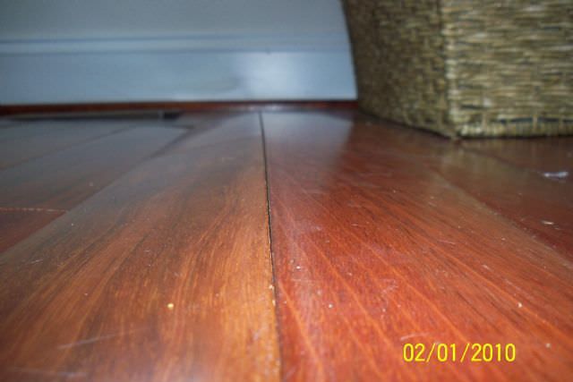

Tom Raymond Posted February 2, 2010 Report Share Posted February 2, 2010 That depends on how the panels are connected to one another. Clips or glue and you might be able to remove and replace panels, click lock type T&G will be damned near impossible to snap in the new planks. Based on the third pic I gotta wonder what else going on there, that looks like water damage not just binding issues. The scratches in the finish are typical. Hard polyurethane finshes have no business on floors, yet they're the staple of the prefinish market. A softer finish won't scratch nearly as easily and is far easier to repair. My personal favorite is antique oil and paste wax, ever see a gym floor with gouges in the finish? Tom Quote Link to comment Share on other sites More sharing options...
mgbinspect Posted February 2, 2010 Author Report Share Posted February 2, 2010 Yup, water damage is on my radar screen, but doesn't seem likely so far... That buckle is behind a brick veneered front exterior wall in the living room, so I'll be paying close attention to that exterior wall surface and roofing above. Quote Link to comment Share on other sites More sharing options...

Marc Posted February 2, 2010 Report Share Posted February 2, 2010 I wouldn't even begin trying to give directions to correct this faulty installation. Rip it all out and start over with a good and thorough reading of the manufacturer's installation instructions. Too many people are doing this wrong. Marc Quote Link to comment Share on other sites More sharing options...

mgbinspect Posted February 2, 2010 Author Report Share Posted February 2, 2010 BTW, Tom, the joists, sub-floor, header joist and sill plate behind the front brick veneer and under that wicked buckle all look perfecto. No visible or apparent moisture - not even efflorescence on the blockwork... Say, I have never realized that it was common to glue tongue and groove flooring like this. Kinda defeats the whole purpose of tongue and groove doesn't it? Shows how much I know technically about the system. For the most part, it usually falls into the cosmetic department until somthing like this rises its ugly head... Quote Link to comment Share on other sites More sharing options...
Tom Raymond Posted February 2, 2010 Report Share Posted February 2, 2010 I was thinking more along the lines of a burst pipe or similar major spill, it generally takes a pretty good soaking to make a wood floor buckle like that. Maybe it's just a combination of factors like missing underlayment, poor fastening from plank to plank, and no room for expansion; they obviously had no clue what they were doing when they laid it. Floating floors are strange animals, especially wooden ones. There are as many different ways of fastening them as there are substrates, cores and surfaces available. The manufacturers instructions are really the only way to know if it was done right or not. Tom Quote Link to comment Share on other sites More sharing options...
