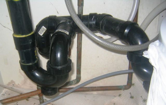

MTL_Inspet_Man Posted March 13, 2010 Report Share Posted March 13, 2010 From todays Inspection. Single family home - Trap underneath the kitchen sink. Double bowl - stainless steel Looks different from what I am used to but still me thinks it's wrong. All intelligent comments are appreciated. Thx Click to Enlarge 36.81 KB Link to comment Share on other sites More sharing options...
Chad Fabry Posted March 13, 2010 Report Share Posted March 13, 2010 Only one trap to an arm. The basins should be connected by a wye or tee and then drain to a single trap. Link to comment Share on other sites More sharing options...
MTL_Inspet_Man Posted March 13, 2010 Author Report Share Posted March 13, 2010 My thoughts exactly Chad thx Link to comment Share on other sites More sharing options...
Darren Posted March 14, 2010 Report Share Posted March 14, 2010 That set-up is allowed here in New Jersey under the National Standard Plumbing Code. Link to comment Share on other sites More sharing options...
Jim Katen Posted March 14, 2010 Report Share Posted March 14, 2010 That set-up is allowed here in New Jersey under the National Standard Plumbing Code. It allows a sanitary tee on it's side? - Jim Katen, Oregon Link to comment Share on other sites More sharing options...
Brandon Whitmore Posted March 14, 2010 Report Share Posted March 14, 2010 That isn't vented properly either-- the trap weir(s) are too high. Link to comment Share on other sites More sharing options...
Darren Posted March 14, 2010 Report Share Posted March 14, 2010 That set-up is allowed here in New Jersey under the National Standard Plumbing Code. It allows a sanitary tee on it's side? - Jim Katen, Oregon I was responding to Chads reply of 'one trap to an arm'. Link to comment Share on other sites More sharing options...
MTL_Inspet_Man Posted March 14, 2010 Author Report Share Posted March 14, 2010 In my 3 yrs - never seen a setup like that. I believe that the one trap to one arm is true As for the venting - yes its wrong too Link to comment Share on other sites More sharing options...
plummen Posted March 15, 2010 Report Share Posted March 15, 2010 1-double traps 2-san-tee onits side 3-90 dropping into another to through wall into another san-tee im guessing [:-crazy] Im sure the guy showing up to snake that drain would have lots of unpleasent words! Link to comment Share on other sites More sharing options...
