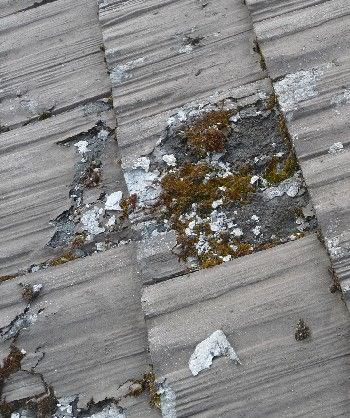

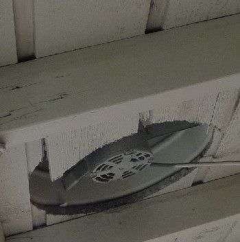

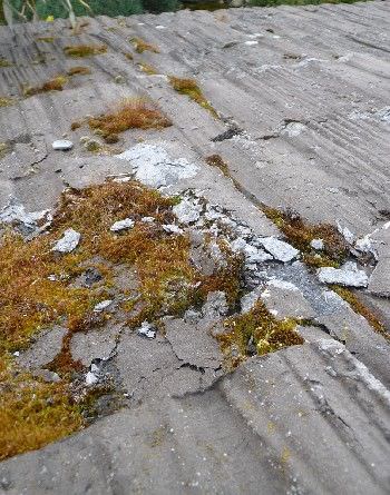

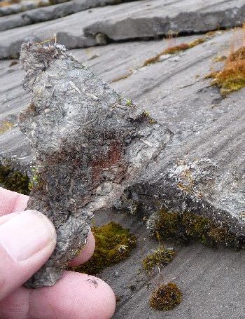

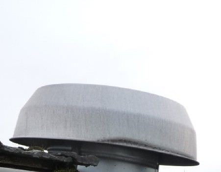

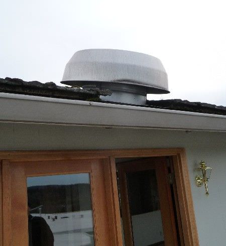

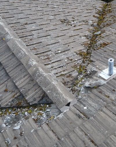

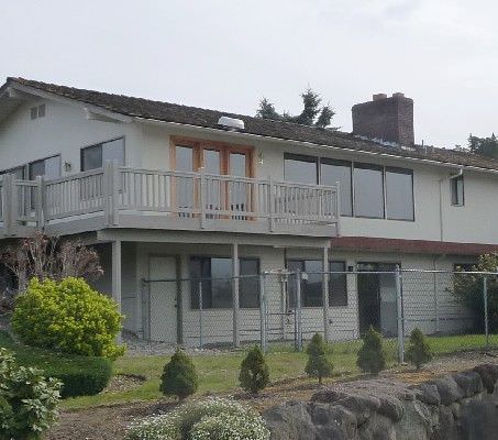

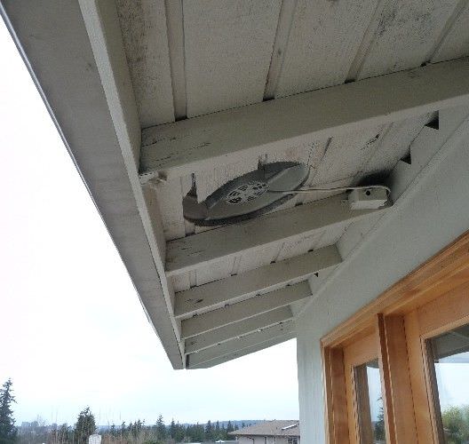

Richard Moore Posted March 15, 2010 Report Share Posted March 15, 2010 What is this in the first two photos? Click to Enlarge 12.19 KB Click to Enlarge 20.16 KB I'll take "whole house fan", "powered attic ventilator", or any combination of those. OK. I know. That was easy! Now try this, In this situation, what is its purpose? Click to Enlarge 40.21 KB Click to Enlarge 27.45 KB Click to Enlarge 42.79 KB Don't expect grades on this one. I have no idea. Final question. Name this roofing material. Hint..."Toast" is not acceptable even if true. Click to Enlarge 55.08 KB Click to Enlarge 53.77 KB Click to Enlarge 57.22 KB Click to Enlarge 75.93 KB Quote Link to comment Share on other sites More sharing options...
Jim Katen Posted March 15, 2010 Report Share Posted March 15, 2010 . . . In this situation, what is its purpose? It serves no purpose. Final question. Name this roofing material. Hint..."Toast" is not acceptable even if true. Those used to be Cemwood Shakes. - Jim Katen, Oregon Quote Link to comment Share on other sites More sharing options...
kurt Posted March 15, 2010 Report Share Posted March 15, 2010 I'm guessing they smoked cigars under it, or something like that. It doesn't have any useful purpose otherwise. Quote Link to comment Share on other sites More sharing options...
Richard Moore Posted March 15, 2010 Author Report Share Posted March 15, 2010 Final question. Name this roofing material. Hint..."Toast" is not acceptable even if true. Those used to be Cemwood Shakes. - Jim Katen, Oregon Thanks Jim. I see that there was a class action settlement (2000 & 2003) regarding Cemwood shakes. Evidently you can still make new claims up until 2/7/2015. I'll pass that on to the client, but its not clear if it would help a new owner. This $500,000+ 1967 bank-owned home had 15 offers (things looking up?). Great view property. The house is solid and dry (despite the roof) but basically hasn't been touched or upgraded inside since new. Typical 60's...plain ugly. Location, location, and, in this case, only location. Quote Link to comment Share on other sites More sharing options...
Richard Saunders Posted March 15, 2010 Report Share Posted March 15, 2010 The fan is an attempt to keep flies out of the house. Quote Link to comment Share on other sites More sharing options...
hausdok Posted March 15, 2010 Report Share Posted March 15, 2010 Ha! xxxx - xxxxx Ave. xx, Bellevue. I was there on the 6th for a fellow. Did a pre-offer consultation for him. Don't know if he made an offer after that or not. I suspect that the fan was to keep the barbeque smoke from wafting into the house when they were outside grilling on the deck. Are you sure they're Cemwood. From up close, it looked like a really badly neglected Monier tile roof that all off the moss was tearing up. There's no doubt it's gotta go, but Rich is right, it's got solid bones and the electro-mechanical has been upgraded and isn't too old. It's perfectly positioned for a premier view of Seattle and the Olympics. ONE TEAM - ONE FIGHT!!! Mike Quote Link to comment Share on other sites More sharing options...

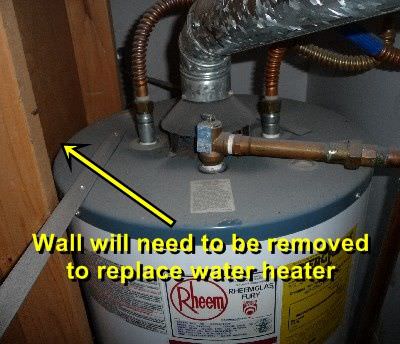

Richard Moore Posted March 15, 2010 Author Report Share Posted March 15, 2010 Hi Mike, I xxx'd out the address. Client confidentiality and all that. But, yeah, same place. Funny, I also had a previous appointment for a pre-offer on this same house, yet another different client. They cancelled as they didn't think the bank would care about removing contingencies. Did you notice a partition wall will have to be removed to change out the 14½ year old water heater? Click to Enlarge 36.49 KB I took a look at online photos of the Monier and Cemwood. Different patterns. I think Jim has it right. I'm not going to be too specific...probably state that they MAY be Cemwood. BTW, the moss may have contributed but the damage seemed more like spalling from trapped moisture freezing. Doesn't really matter at this point. It's FUBAR! Quote Link to comment Share on other sites More sharing options...
Ben H Posted March 15, 2010 Report Share Posted March 15, 2010 I'm guessing they smoked cigars under it, or something like that. It doesn't have any useful purpose otherwise. Thats the first thing that came to my mind. Bongs perhaps? Quote Link to comment Share on other sites More sharing options...
esch Posted March 15, 2010 Report Share Posted March 15, 2010 There's attic fans, then theres roof fans. or eve fans... or.... Those are lichens growing on shingles. Matt Quote Link to comment Share on other sites More sharing options...
Erik Posted March 18, 2010 Report Share Posted March 18, 2010 Could the shingles be Masonite Woodruf? Quote Link to comment Share on other sites More sharing options...
hausdok Posted March 18, 2010 Report Share Posted March 18, 2010 Nope, They weren't woodruf; I'm intimately familiar with that crap. It had a solid deck. Wish it had been decked with skip; then I could have looked at the underside of the tile for a name. It really doesn't make any difference what they are; the roof is toast and has to go - knowing the brand name isn't going to change that one iota. ONE TEAM - ONE FIGHT!!! Mike Quote Link to comment Share on other sites More sharing options...
