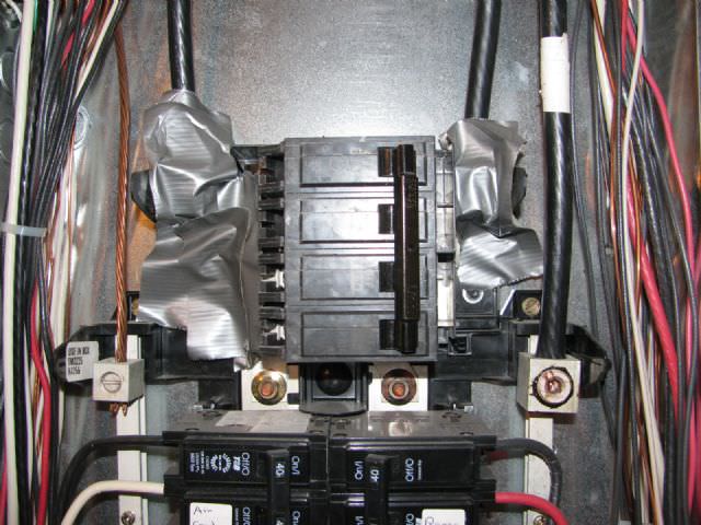

Mark P Posted March 17, 2010 Report Share Posted March 17, 2010 I found this odd. I'm guessing the sparky did it so as to not accedentaly touch them? I was tempted to just pull if off, but did not. Would you have removed it? Click to Enlarge 72 KB Quote Link to comment Share on other sites More sharing options...
Marc Posted March 17, 2010 Report Share Posted March 17, 2010 That old silver duct tape. Doesn't it have some borderline conductive properties? Marc Quote Link to comment Share on other sites More sharing options...
ghentjr Posted March 17, 2010 Report Share Posted March 17, 2010 I Would you have removed it? Click to Enlarge 72 KB No! Quote Link to comment Share on other sites More sharing options...
Jack Davenport Posted March 17, 2010 Report Share Posted March 17, 2010 It may be perfectly safe to just rip it off but ................. can you be 100% positive ?? Are you 100% positive as to why it was installed ? Are you there to do repairs ? I would just write it up as needing removal. Quote Link to comment Share on other sites More sharing options...
Ben H Posted March 17, 2010 Report Share Posted March 17, 2010 Heck yeah, I'd have pulled it off with my teeth.[] Quote Link to comment Share on other sites More sharing options...
randynavarro Posted March 17, 2010 Report Share Posted March 17, 2010 Do it with a tape measure. Quote Link to comment Share on other sites More sharing options...
Brandon Whitmore Posted March 18, 2010 Report Share Posted March 18, 2010 Do it with a tape measure. Good thing I wasn't consuming anything while reading your post. Quote Link to comment Share on other sites More sharing options...
Billy_Bob Posted March 18, 2010 Report Share Posted March 18, 2010 I would not touch it. I would be worried that the tape could be electrically conductive. Or that I might accidentially touch a live metal part behind the tape. That area of the panel would *always* be live, even with the main breaker off. The safe way to remove the tape would be to call the electric company, have them pull the meter to disconnect power, remove the tape, then reinstall the meter. If there is a way to do something with the power off, then that is the best way to go. I would guess that someone placed that there because it is always live and so they would not accidentially touch it while adding a new breaker or whatever. I should think wide electrical tape would have been a better choice... Quote Link to comment Share on other sites More sharing options...
