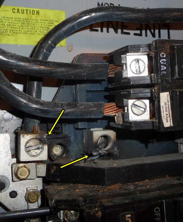

Richard Moore Posted April 2, 2010 Report Share Posted April 2, 2010 Direct short from the neutal lug to bus bar. I don't know how someone managed to do this, or what with (screwdriver?), but I'll bet it was quite exciting at the time. Download Attachment: 0061x.jpg 191.31 KB Quote Link to comment Share on other sites More sharing options...
randynavarro Posted April 2, 2010 Report Share Posted April 2, 2010 So does one call that out as problematic or just some crazy incident from the past? Quote Link to comment Share on other sites More sharing options...

Richard Moore Posted April 2, 2010 Author Report Share Posted April 2, 2010 So does one call that out as problematic or just some crazy incident from the past? There was a grab bag of other issues (panel and other stuff) so I was able to punt. I reported it as "unlikely to be a current problem" but that they should have the electrician contracted to fix the other stuff confirm that. Quote Link to comment Share on other sites More sharing options...

Marc Posted April 2, 2010 Report Share Posted April 2, 2010 The phenolic plastic or whatever hydrocarbon product that was used to construct the insulating components of the bus bar assembly is now carbonized and no longer has the insulating qualities that the manufacturer had intended. Replace the busbar assembly if it is available, otherwise replace the entire panelboard. The area where the arc occurred is not protected by the main breaker, assuming that this panel is a main panel. It is protected only by the utility fuse which protects the utility transformer, which might serve several residences at once. It's a big, super lag fuse. The consequence of the damaged area arcing over again at some point in the future could be enormous if not lethal. Marc Quote Link to comment Share on other sites More sharing options...

Jim Katen Posted April 3, 2010 Report Share Posted April 3, 2010 I agree with Marc. Time for a new panelboard. - Jim Katen, Oregon Quote Link to comment Share on other sites More sharing options...
Richard Moore Posted April 3, 2010 Author Report Share Posted April 3, 2010 The area where the arc occurred is not protected by the main breaker, assuming that this panel is a main panel. It is protected only by the utility fuse which protects the utility transformer.... I won't argue with the rest of your post. You and Jim are probably right about replacement. But...that bus bar lug is protected by the main breaker. Power comes in from the SECs to the main breaker lugs and doesn't go anywhere else until it passes through that "backfed" breaker. Quote Link to comment Share on other sites More sharing options...
