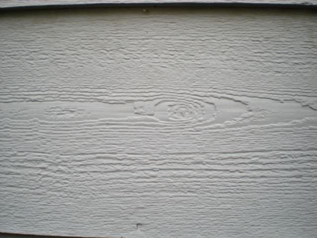

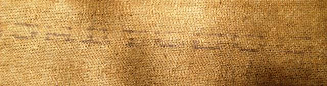

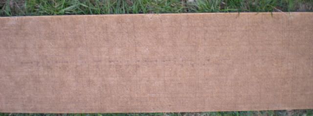

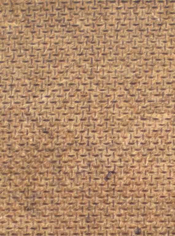

edteach Posted April 12, 2010 Report Share Posted April 12, 2010 I am having a bit of trouble identifing a lap siding product. I think it is either abitibi or masonite but not sure and the ink mard is almost unreadable. Any help would be greatly appreciated. Click to Enlarge 95.16 KB Click to Enlarge 12.15 KB Click to Enlarge 11.06 KB Click to Enlarge 25.62 KB Link to comment Share on other sites More sharing options...
Tim Maxwell Posted April 12, 2010 Report Share Posted April 12, 2010 What does the face of the siding look like? Link to comment Share on other sites More sharing options...

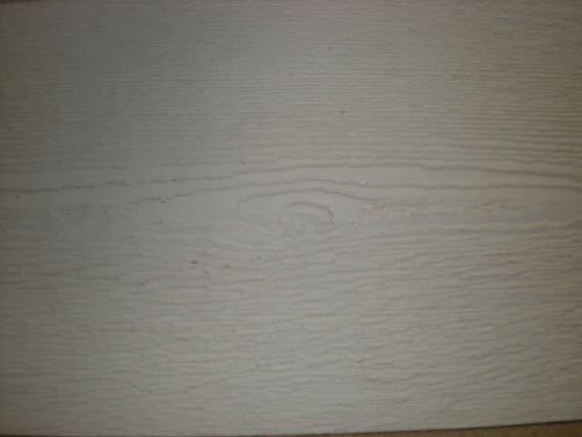

edteach Posted April 12, 2010 Author Report Share Posted April 12, 2010 photo of the face, I called LP and sent them the photos and they said it was abtco/abitibi It looks a lot like the backing and dot matrix writing from that company on their class action web site. They are still open on the class action and I have the forms to fill out. I wish it was readable. And it takes 3 months to get a settlement Click to Enlarge 52.26 KB Click to Enlarge 29.39 KB Link to comment Share on other sites More sharing options...

Jim Katen Posted April 13, 2010 Report Share Posted April 13, 2010 photo of the face, I called LP and sent them the photos and they said it was abtco/abitibi It looks a lot like the backing and dot matrix writing from that company on their class action web site. They are still open on the class action and I have the forms to fill out. I wish it was readable. And it takes 3 months to get a settlement. . . From the pictures you posted, it looks more like Masonite than Abitibi. Masonite was the one that used dot matrix printing. - Jim Katen, Oregon Link to comment Share on other sites More sharing options...

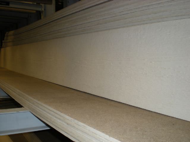

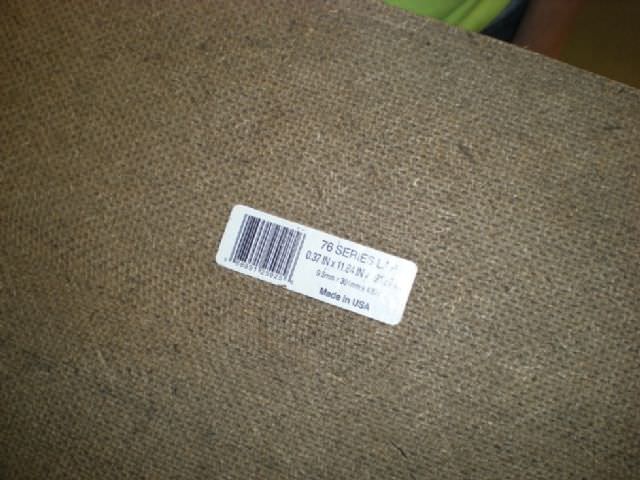

edteach Posted April 13, 2010 Author Report Share Posted April 13, 2010 Its a press board used in many things, depending on the resin used. LP stlll makes this same crap called smart siding. Not really. LP's product is oriented strand board. It's a completely different animal from the hardboard product in your picture. - Jim Katen, Oregon I have done a lot of research, here is a photo taken at my local lowes and this product is LP smart siding,, So the myth that only masonite makes that type of board with the waffeling and fiber is not true. The texture is not exact but it is the closest thing I have seen. And if you look at the page here with the link supplied from the Abtico/abtco class action claims page you will see the same dot matrix writing, my writing is just not that pronounced. http://www.abtcoclaims.com/product_id_A ... codes.html Click to Enlarge 61.76 KB Click to Enlarge 30.52 KB Click to Enlarge 25.3 KB Link to comment Share on other sites More sharing options...
Jim Katen Posted April 13, 2010 Report Share Posted April 13, 2010 . . . I have done a lot of research, here is a photo taken at my local lowes and this product is LP smart siding,, Sort of, but not really. I know that LP has started marketing it as Smartside Foundation Series siding, but the stuff in your picture is really Abtico. LP just bought the line and eliminated the name. Real LP Smartside is still an OSB product. Always has been. So the myth that only masonite makes that type of board with the waffeling and fiber is not true. What myth is that? No one here ever said that. The texture is not exact but it is the closest thing I have seen. And if you look at the page here with the link supplied from the Abtico/abtco class action claims page you will see the same dot matrix writing, my writing is just not that pronounced. http://www.abtcoclaims.com/product_id_A ... codes.html Could be. But to my eye it looks more like Masonite's writing and texture. Why not pull off a few more boards to find one that's legible? - Jim Katen, Oregon Link to comment Share on other sites More sharing options...
edteach Posted April 13, 2010 Author Report Share Posted April 13, 2010 I took off a couple of boards and this is the best mark I can find, I sure looks like ABTCO to me. Click to Enlarge 38.24 KB Link to comment Share on other sites More sharing options...

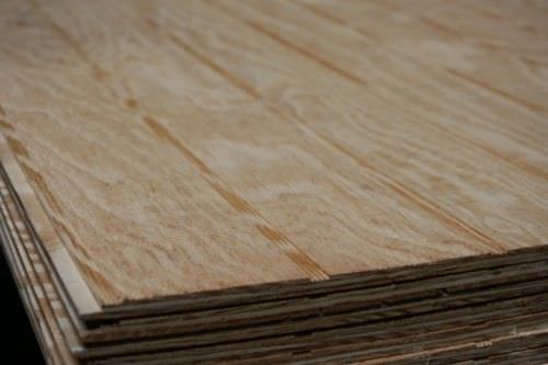

Terence McCann Posted April 13, 2010 Report Share Posted April 13, 2010 Is there anyway to tell from the exterior if it is ABTCO or do you have to see the backside of the siding? Any dates on when this stuff was manufactured? Is it more of a regional thing or is it widespread throughout the US? Is this the same as T1-11? Link to comment Share on other sites More sharing options...
Jim Katen Posted April 13, 2010 Report Share Posted April 13, 2010 I took off a couple of boards and this is the best mark I can find, I sure looks like ABTCO to me. Click to Enlarge 38.24 KB Your eyes are better than mine. Still, if LP is willing to go for it, I wouldn't make waves. They'll probably give you more than masonite would. - Jim Katen, Oregon Link to comment Share on other sites More sharing options...
edteach Posted April 14, 2010 Author Report Share Posted April 14, 2010 Its a press board used in many things, depending on the resin used. LP stlll makes this same crap called smart siding. Not really. LP's product is oriented strand board. It's a completely different animal from the hardboard product in your picture. - Jim Katen, Oregon I just got off the phone with Randy Macie from LP and he said that they still produce fiber board exactly as it looks in my photos and OSB smart board under the brand name SMART siding. I was told that what I saw and photographed at lowes is a current product. I also found that there are still law suits agianst this product "smart siding" I have been told by three techs at LP that this is Abtico that they are 99.9% sure. If you look at the web site I posted abtico used the dot matrix in that form for their markings. Here is the kicker I do not understand, in Kansas Wichita metor area and sourunding subs, 90% of homes have this crap on them. and they act like vinyl siding is some type of garbage. I have worked in Florida, Michigan, Arkansas and other parts of the country and vinly works. The salt in the wound is that cost of hardiboard is 86 cents a SF and the louisiana pacific fiberboard is 1.06 a SF, I have installed both and they both cut with a carbide blade. They paint the same and I have no idea why anyone would put on fiber board even if it was half price not to mention more! Kansas is full of crazy things and people. Link to comment Share on other sites More sharing options...

gtblum Posted May 5, 2012 Report Share Posted May 5, 2012 Is this the same as T1-11? Noooooooo. Not even close. Click to Enlarge 25.82 KB Link to comment Share on other sites More sharing options...

hausdok Posted May 5, 2012 Report Share Posted May 5, 2012 Is this the same as T1-11? T1-11 is a pattern designation for the reversed board on batten pattern of APA 303 plywoods. APA applies the term equally to plywood, OSB or any wood-based structural panel product using that pattern, including any fiber-cement panels that present the same appearance (The "Fiber" in fiber-cement siding is wood). ONE TEAM - ONE FIGHT!!! Mike Link to comment Share on other sites More sharing options...
gtblum Posted May 5, 2012 Report Share Posted May 5, 2012 Is this the same as T1-11? T1-11 is a pattern designation for the reversed board on batten pattern of APA 303 plywoods. APA applies the term equally to plywood, OSB or any wood-based structural panel product using that pattern, including any fiber-cement panels that present the same appearance (The "Fiber" in fiber-cement siding is wood). ONE TEAM - ONE FIGHT!!! Mike I've never seen any but the plywood type. Is the OSB treated or coated? Link to comment Share on other sites More sharing options...
