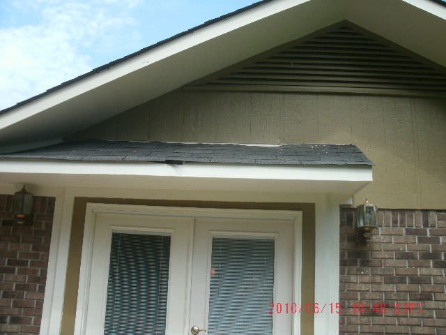

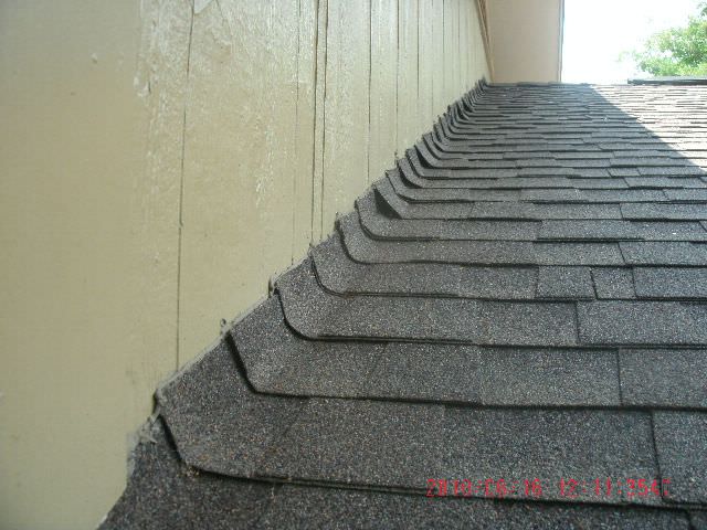

Phillip Posted June 17, 2010 Report Share Posted June 17, 2010 I think we have talked about this before and I haven't took the time to look it up. From the ground it looks like a nice clean cut valley. When I get on the roof I find this. Shingles that turn and run down the valley and then shingle run out on top of these shingles. No cut at all. Click to Enlarge 142.69 KB Click to Enlarge 126.68 KB Quote Link to comment Share on other sites More sharing options...
Chad Fabry Posted June 17, 2010 Report Share Posted June 17, 2010 Yeah, it's a California valley. The NRCA does not endorse it in areas that have heavy rains, snow or high winds. Don't you guys have two out of three of those things? The shingle manufacturers that I'm familiar with don't list the installation in their valley construction methods guidelines. Quote Link to comment Share on other sites More sharing options...
Brandon Whitmore Posted June 17, 2010 Report Share Posted June 17, 2010 Common installation here, and it seems to work fine. Quote Link to comment Share on other sites More sharing options...
Tom Raymond Posted June 17, 2010 Report Share Posted June 17, 2010 I like it. It makes a really nice tight line that looks good. Cut valleys end up leaving a fat black line that draws the eye, especially on lighter colored shingles, and looks irregular on highly dimensional architectural shingles. Then there's the cuts that end up less than straight. This is fast and easy, looks better, and works as well as a cut valley. The only drawback is that the corners of the shingles lapping the valley course should be glued down with mastic, they won't seal themselves. Tom Quote Link to comment Share on other sites More sharing options...
Phillip Posted June 17, 2010 Author Report Share Posted June 17, 2010 That the first time I have seen it in this area and I did not find in in the installment manuals that I looked at. We do get high winds and hard rains at times Quote Link to comment Share on other sites More sharing options...
Jim Katen Posted June 17, 2010 Report Share Posted June 17, 2010 It works fine. If I were installing a new roof on my house tomorrow, I'd use this method. - Jim Katen, Oregon Quote Link to comment Share on other sites More sharing options...

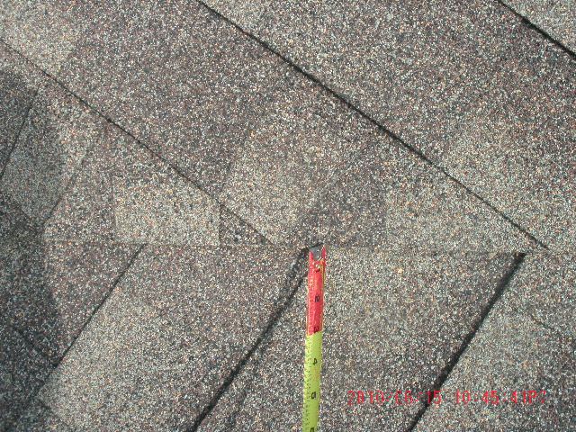

Chad Fabry Posted June 17, 2010 Report Share Posted June 17, 2010 Do any of you guys that support the installation have anything that says it's an approved method? I did some EW support for a client with this style valley on all eight valleys of his house and he ended up not having to pay the contractor because the shingle manufacturer stated, in writing, that the installation voided the warranty. I've never had any issue with burying an electrical box in a wall but I still wouldn't do it. (often) Quote Link to comment Share on other sites More sharing options...
Marc Posted June 17, 2010 Report Share Posted June 17, 2010 We can all do it on our own house if we wish but when we're representing inspection clients, it's a different story. I'm with Chad on this issue. And I wouldn't do it on my house. Marc Quote Link to comment Share on other sites More sharing options...
Tom Raymond Posted June 17, 2010 Report Share Posted June 17, 2010 I don't have any documentation to support my opinion but... 1. I've seen enough valleys with scabs, cut offs and otherwise improprly affixed pieces to know that it makes far better sense to work your way out of a valley (as this approach demands) than it does to work towards one (which is what happens most of the time). 2. Double cut valleys only appear when the materials demand them. Nobody does woven valleys because...well because roofers just aren't smart enough to weave them right, if they were they wouldn't be roofers. Closed cut valleys have become the norm, been that way for decades. If the industry can accept dumbing down the detail this far than the next logical step is to eliminate the cut altogether. 3. If the valley is properly built up with IWS and felt underlay, you'd have to try damned hard to make it leak, and with the extra layers of this (or the closed cut method) even more so. 4. Nobody reads directions anyway. Tom Quote Link to comment Share on other sites More sharing options...
hausdok Posted June 17, 2010 Report Share Posted June 17, 2010 That's used a lot around here. In their master shingle applicator manual (Page 64) Certainteed calls that an "Alternate Closed Valley" application. Certainteed states in the manual that a closed valley is their preferred method of installation for all roofs except Custom Lok 25 and their Super Shangle products. ONE TEAM - ONE FIGHT!!! Mike Quote Link to comment Share on other sites More sharing options...
Brandon Whitmore Posted June 17, 2010 Report Share Posted June 17, 2010 Do any of you guys that support the installation have anything that says it's an approved method? Mike beat me to the main one, but I have seen this valley detail shown by other manufacturers as well. I did some EW support for a client with this style valley on all eight valleys of his house and he ended up not having to pay the contractor Was the contractor given the option/ right to fix the valleys? If I were to start writing this up as an issue on newer roofs, I would probably have to write up about 50% of them, including the last 2 I've inspected. Quote Link to comment Share on other sites More sharing options...

Chad Fabry Posted June 18, 2010 Report Share Posted June 18, 2010 1. I've seen enough valleys with scabs, cut offs and otherwise improprly affixed pieces to know that it makes far better sense to work your way out of a valley (as this approach demands) than it does to work towards one (which is what happens most of the time). Except that approach negates the manufacturer's mandated course offsets. Quote Link to comment Share on other sites More sharing options...
Chad Fabry Posted June 18, 2010 Report Share Posted June 18, 2010 Was the contractor given the option/ right to fix the valleys? There was no fixing it. He started in the valleys and the incorrect offset made the roof pattern look like crap and the fact that it ended up being only about 3-1/2 inches of offset voided the warranty. Quote Link to comment Share on other sites More sharing options...

hausdok Posted June 18, 2010 Report Share Posted June 18, 2010 Now maybe in places that get hard rain and strong winds this kind of valley sucks. But around here, it works just fine. - Jim Katen, Oregon Nope, seems to work fine around here even in the hard driving rains; even when they don't bother to adhere the overlap with mastic - which is most of the time. ONE TEAM - ONE FIGHT!!! Mike Quote Link to comment Share on other sites More sharing options...
