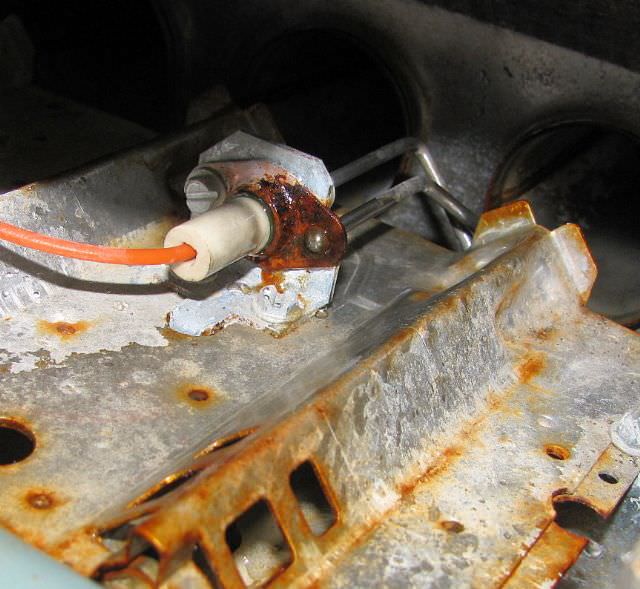

Mark P Posted August 21, 2010 Report Share Posted August 21, 2010 What is the name of this thingy. I believe it is a flame sensor. Condensate was dripping directly on top of it and wanted to use its proper name. Click to Enlarge 74.45 KB Quote Link to comment Share on other sites More sharing options...
mgbinspect Posted August 21, 2010 Report Share Posted August 21, 2010 Isn't that an igniter? It's looks like possibly the two electrodes that a spark jumps between to ignite the pilot. Quote Link to comment Share on other sites More sharing options...
Marc Posted August 21, 2010 Report Share Posted August 21, 2010 Looks like a flame prover to me. When the rod becomes hot enough, it emits electrons like the cathode on those old television vacuum tubes. The other electrode (the cool one) collects them. A circuit then detects that a current is flowing and allows the main gas valve to either open or to remain open when the bypass switch is released. I guess the mention of cathodes on vacuum tubes didn't ring a bell with too many of you, but that's the truth. If you heat up a wire hot enough, it will emit electrons for a suitably charged conductor nearby to collect. Marc Quote Link to comment Share on other sites More sharing options...
Richard Saunders Posted August 22, 2010 Report Share Posted August 22, 2010 It's called a thermocouple. Quote Link to comment Share on other sites More sharing options...
Erby Posted August 22, 2010 Report Share Posted August 22, 2010 The ignitor doesn't usually extend so far into the flame chamber with two rods. Most of the igniters I see are more of a glow plug type. They heat up like an oven element, gas flows over them and ignites. The only sparkers I usually see are on gas log sets with the little pushbutton (piezo-electric ignitor) I'd also go with thermocouple of some type (like Marc says - flame prover). But most of the thermocouples I see are usually immersed in the pilot light flame to keep the valve open as long as the thermocouple is hot. Pilot light goes out, thermocouple cools off, valve closes to keep raw gas from leaking out. ?????? - Quote Link to comment Share on other sites More sharing options...
Bain Posted August 22, 2010 Report Share Posted August 22, 2010 It's a flame prover, as said before. It's sometimes also referred to as a flame sensor. Quote Link to comment Share on other sites More sharing options...
Greg Booth Posted August 23, 2010 Report Share Posted August 23, 2010 It's both. I know it as a single-sense flame prover AND spark igniter. Quote Link to comment Share on other sites More sharing options...
caryseidner Posted August 24, 2010 Report Share Posted August 24, 2010 It's a desert topping & a floor wax. Quote Link to comment Share on other sites More sharing options...
Hearthman Posted August 24, 2010 Report Share Posted August 24, 2010 Direct Spark Ignition or DSI. The flame rod proves existence of a flame by rectification. Electronic ignition systems are generally either DSI, Hot Surface Igniter or HSI, or Intermittent Pilot Ignition or IPI. The HSI is also called a 'glow coil' while the IPI is sometimes referred to as a 'spark to pilot'. All three use flame rectification meaning the flame conducts an electrical signal and rectifies it into a DC signal that the module is 'trained' to see. HTH, Quote Link to comment Share on other sites More sharing options...
