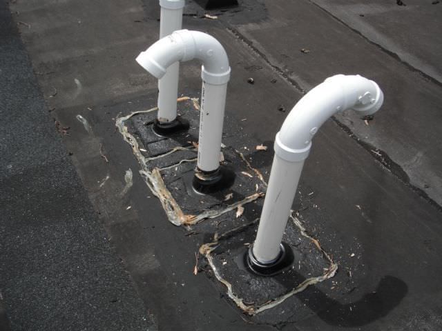

NJinspector Posted September 13, 2010 Report Share Posted September 13, 2010 Does anbody have a diagram or reference i can point to regarding the proper way to flash these vents on this type of roof? Click to Enlarge 48.35 KB Link to comment Share on other sites More sharing options...
mgbinspect Posted September 13, 2010 Report Share Posted September 13, 2010 because... ? Link to comment Share on other sites More sharing options...
NJinspector Posted September 13, 2010 Author Report Share Posted September 13, 2010 Property was flipped. The "flipper" is the one who had it inspected for his buddy who is buying the house. Mortgage company wants it re-inspected. I asked right away what they did about the roof, the said they had no idea what else to do. Link to comment Share on other sites More sharing options...

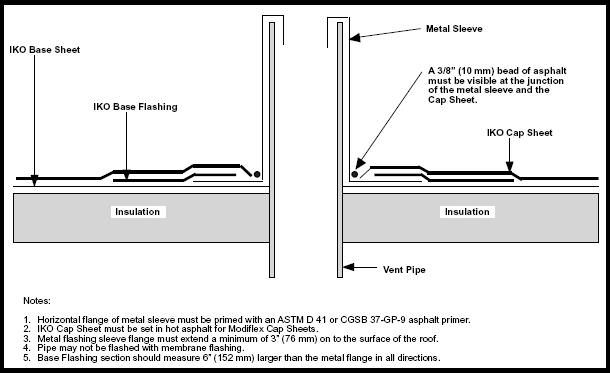

Bill Kibbel Posted September 13, 2010 Report Share Posted September 13, 2010 Specific to mod bit: Click to Enlarge 36.2 KB Link to comment Share on other sites More sharing options...
kurt Posted September 14, 2010 Report Share Posted September 14, 2010 For some reason, I can't get the link to work to the Iko site. They've got the nicest handbook for mod bit flashing details. You can use a lead sleeve like Bill's (Iko) pic, or you can make a cylinder sleeve out of mod bit, and weld it to the base flashing. Try googling modified bitumen flashing; what comes up when I do that is the Iko site at the top. Use their link to download the handbook; it's invaluable. If I could get my link to work, I'd put it up here. Link to comment Share on other sites More sharing options...
Rocon Posted September 14, 2010 Report Share Posted September 14, 2010 Strip in a regular roof jack similarly to the detail Mark and Bill supplied, use sealant from the jack to the pipe, then install a neoprene collar to protect the sealant. Do not use mastic in contact with the PVC pipe. Click to Enlarge 3.24 KB Link to comment Share on other sites More sharing options...

kurt Posted September 14, 2010 Report Share Posted September 14, 2010 Yep, that's it. Just curious Rocon, but why wouldn't you just buy a mod bit boot? GAF has a bunch of accessory flashing boots made for mod bit. No caulk, no mastic to worry about with the PVC, no extra parts, no nothing other than a welded mod bit with a lead sleeve collar. The NRCA doc's usually show a mod bit sleeve with a hose clamp to mechanically fasten the sleeve to the vent pipe. I've never seen the southern Cal method. Link to comment Share on other sites More sharing options...

Rocon Posted September 14, 2010 Report Share Posted September 14, 2010 Kurt, Well I would not call it the Southern Cal method. If you want Ideal then use NRCA details. My repair offers ease of install with off the shelf components that offer redundancy at each of the vulnerable spots. It will also outlive the rest of the roof from what I see in the picture. I just designed a solution that would slide over the PVC elbows. I do not believe most lead jackets I have seen have enough wiggle room to make the curve. (I do not suggest having a roofer cutting the intake and exhaust vent for your mechanical system.) Stripping the flashing in gives a redundant mastic level at the flange, and the shape of the jack keeps the mastic away from the PVC. #8195; Alternate: Download Attachment: Flashing.pdf 68.78 KB Link to comment Share on other sites More sharing options...
kurt Posted September 14, 2010 Report Share Posted September 14, 2010 Actually, my mistake on the boot.....I was thinking plumbing vent instead of the PVC combustion vent. I think your method would work great; I've just never seen it and thought it was a southern cal thing. We usually just torch a mod bit sleeve to a base flashing, and clamp the top. On plumbing vents, I use the GAF accessory stuff. Link to comment Share on other sites More sharing options...
