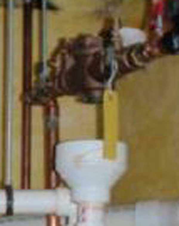

Chad Fabry Posted February 23, 2011 Report Share Posted February 23, 2011 Does anyone know why this is like it is? Click to Enlarge 40.34 KB Quote Link to comment Share on other sites More sharing options...
Inspectorjoe Posted February 23, 2011 Report Share Posted February 23, 2011 Provision for a future water softener. Quote Link to comment Share on other sites More sharing options...
Bill Kibbel Posted February 23, 2011 Report Share Posted February 23, 2011 Provision for a future water softener whole house filter. Quote Link to comment Share on other sites More sharing options...

mthomas1 Posted February 24, 2011 Report Share Posted February 24, 2011 Hard to tell from the picture, but could that receptor be intended to accept water from a valve above it functioning as a drain cock, or some other similar source above the receptor? Click to Enlarge 29.07 KB Now... THIS... is what I would call a "trombone": Click to Enlarge 27.14 KB Quote Link to comment Share on other sites More sharing options...
Chad Fabry Posted February 24, 2011 Author Report Share Posted February 24, 2011 Hi Michael, The receptor is there to drain the irrigation system. I was talking about the three valve copper loop. Quote Link to comment Share on other sites More sharing options...

mthomas1 Posted February 24, 2011 Report Share Posted February 24, 2011 Hi Michael, The receptor is there to drain the irrigation system. I was talking about the three valve copper loop. Thanks, shudda' realized - got sidetracked on the discussion of PVC vs ABS, focused on that portion of the pic, and was thinking you were comparing the receptor to the "bell" of a trombone. Quote Link to comment Share on other sites More sharing options...
MMustola Posted February 24, 2011 Report Share Posted February 24, 2011 In my area 70% of the houses are on private wells. That plumbing configuration is vary common and we refer to it as a water softener bypass. It's intended for a water softener or a whole house filter. If close the two side valves and open the center one you will isolate the appliance from the plumbing system so you can replace or repair it. P.S. PVC has been the standard here since the early 1970's. Quote Link to comment Share on other sites More sharing options...
