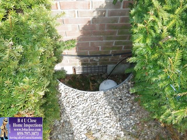

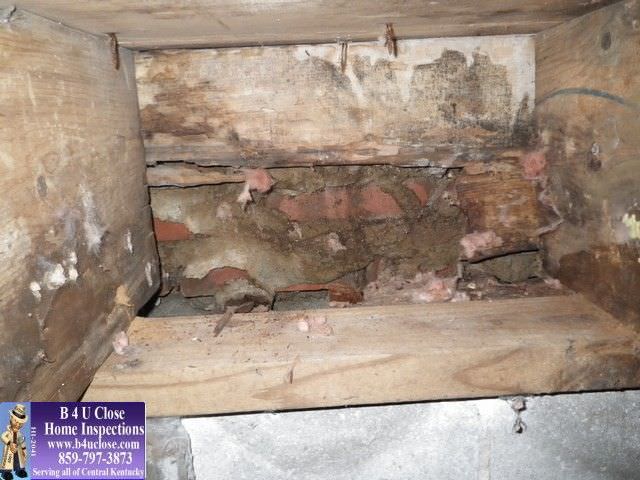

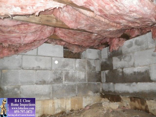

Erby Posted March 5, 2011 Report Share Posted March 5, 2011 From this afternoon's inspection. This was in the crawl space. Click to Enlarge 62.32 KB Notice that, as usual, the wood framing starts immediately above the (blocked) crawl space vent. Click to Enlarge 67.77 KB While the original sill plate, along with most of the bottom of the rim joist was gone, and the ends of the joists were rotting and starting to crush, someone had shoved a 2x4 in there to hold up the joists. That's all ya need, right! Then you walk around to the outside and see this: Click to Enlarge 117.9 KB Well, OK, I guess you can't see it as well in the picture as you could on the ground (wrong camera angle) BUT The grade level was about five bricks ABOVE the top of the foundation. All the moisture seeping thru the brick from the ground had done a number on the wood framing. Grade level was about the same all around the front, left and back of the home. First fix the grading. It needs to be lowered, a LOT. Then fix the structural framing. Then worry about all the other crap in the crawl space, bad vapor barrier, wood debris, sump pump on a block in a hole in the ground, powder post beetles, etc. I'll save the electrical for a different post. Gonna cost somebody some MONEY! Quote Link to comment Share on other sites More sharing options...

ericwlewis Posted March 5, 2011 Report Share Posted March 5, 2011 picture #2 lets you see where the flashing behind the brick veneer is missing and illustrates how much mortar falls behind the brick during installation. makes me wonder if there are weepers under the soil letting water IN. [] Quote Link to comment Share on other sites More sharing options...
Erby Posted March 5, 2011 Author Report Share Posted March 5, 2011 Weep holes or not, water goes right through brick in this situation. Quote Link to comment Share on other sites More sharing options...
