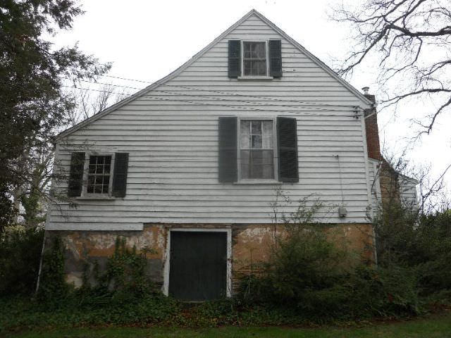

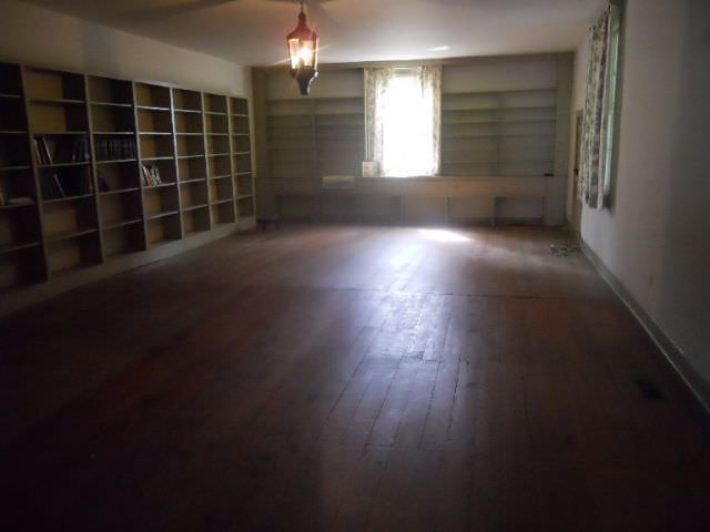

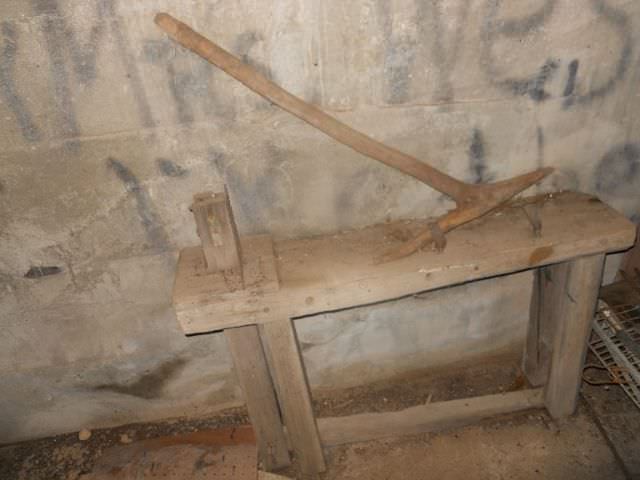

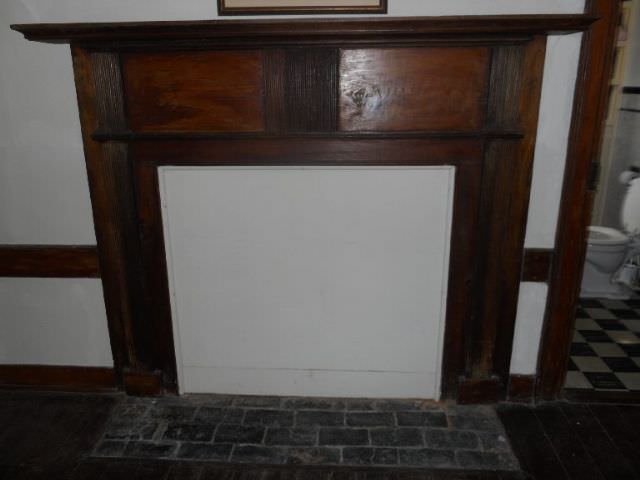

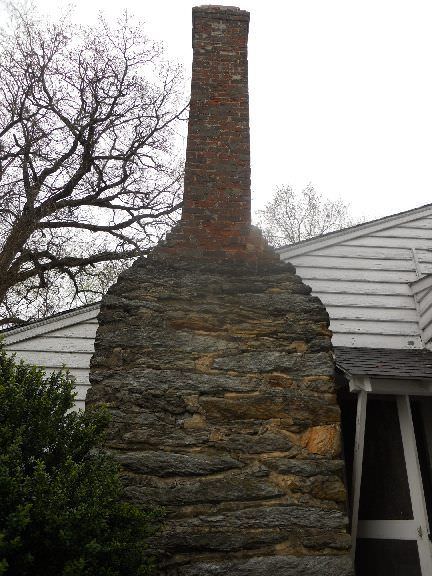

mgbinspect Posted April 9, 2011 Report Share Posted April 9, 2011 This is the original store, post office and residence of Gravel Hill, VA circa 1799. Through a series of additions the structure went from probably 800 SF (in two stories) to about 2400 SF. So, much of what you'll see isn't from 1799. Hoping Bill K might throw in a few comments here and there - especially regarding the bench like tool I photographed in the basement. Click to Enlarge 42.09 KB Above is a document from the Postmaster General of the Confederate States of America declaring the store and tavern at Gravel Hill, Virginia as a Post Office overseen by the fella at the top. It was issued in March of 1864. Click to Enlarge 85.48 KB This photograph of the front elevation is misleading, in that the front porch, shed to the left and the entire right half of the building (incuding the dormer) are not original. One can see the outline of the original building in the siding of the left elevation. Also, all of the field stone chimneys were added later. Click to Enlarge 30.19 KB Click to Enlarge 26.68 KB Click to Enlarge 72.11 KB Click to Enlarge 71.92 KB Click to Enlarge 43.91 KB Hopping Bill can identify this tool. Click to Enlarge 39.7 KB The bottle says HINDS something ALMOND Click to Enlarge 55.89 KB The beam in the background has a tenon, which isn't set in a mortise. There were a series of them down the length of the front porch. At first I thought maybe the outer sill with the mortise had rotted away, but since there was no remnant of a sill with any mortise the whole length of the porch I finally concluded the timbers were recycled from another building nearby. Click to Enlarge 55.63 KB This fireplace serves the original store (1799), but I don't think it's the original fireplace. The lintel stone is one dressed piece of stone. I don't think it was originally made for this fireplace. I feel it also was recycled from another property during the mid 1800's. Any thoughts Bill? Click to Enlarge 49.76 KB Click to Enlarge 36.84 KB Click to Enlarge 28.81 KB This is the floor of the store. The closer half is original. The far half is an addition which transitions from a brick foundation to field stone. The field stone foundation mortar was barely more than mud and over the years has dried up and fallen out, due to two centuries of foot traffic (vibration). Consequently, the far field stone foundation has, over time, lost 2.5" in height, as can be seen in the floor. Click to Enlarge 31.54 KB Click to Enlarge 37.87 KB Here's that drop off in the floor. The stone foundation needs to be repointed pronto. It's not much more than rubble and relies on the building to hold it in place. Click to Enlarge 29.57 KB Click to Enlarge 29.34 KB Click to Enlarge 19.21 KB Click to Enlarge 49.08 KB Click to Enlarge 45.44 KB Above: Open Mortise and Tenon at the roof peak. No ridge board. This is original - 1799 Quote Link to comment Share on other sites More sharing options...

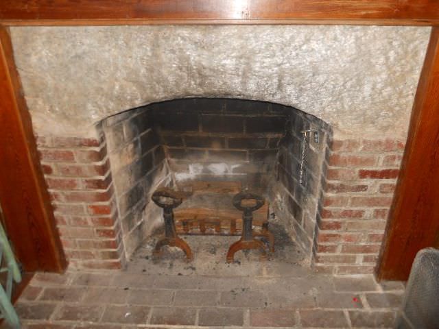

Bill Kibbel Posted April 9, 2011 Report Share Posted April 9, 2011 Click to Enlarge 43.91 KB Hopping Bill can identify this tool. It really looks like a treadle used to pump a blacksmiths bellows. This fireplace serves the original store (1799), but I don't think it's the original fireplace. The lintel stone is one dressed piece of stone. I don't think it was originally made for this fireplace. I feel it also was recycled from another property during the mid 1800's. Any thoughts Bill?I think the dressed stone is salvaged, but the fireplace itself is more recent the mid 1800s. Quote Link to comment Share on other sites More sharing options...

mgbinspect Posted April 9, 2011 Author Report Share Posted April 9, 2011 quote]I think the dressed stone is salvaged, but the fireplace itself is more recent the mid 1800s. I thought perhaps it started as a lintel over a door or window in some church, or such, and found its way to this lowly spot over a store fireplace. I do know this: having dressed stone by hand myself, that is a piece of work that took some sweet time to turn out. Quote Link to comment Share on other sites More sharing options...
