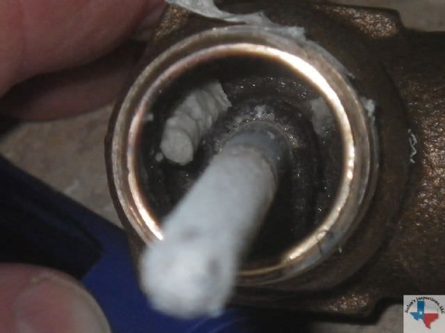

Nolan Kienitz Posted April 24, 2011 Report Share Posted April 24, 2011 Helped out a client and replace his TPR Valve that was leaking and would not reset. House and Water Heater are a 2006 vintage. Image shows inside of valve. Somewhat surprised at the amount of chemical mineral deposits. There was also a boatload along the threads when I removed the valve. It was a side mount unit. The particular water supply in this community must have high chemical content. Interesting things we keep running across. Click to Enlarge 33.43 KB Quote Link to comment Share on other sites More sharing options...

Bill Kibbel Posted April 24, 2011 Report Share Posted April 24, 2011 Wouldn't "mineral deposits" be more accurate than "chemical deposits"? Quote Link to comment Share on other sites More sharing options...
Nolan Kienitz Posted April 24, 2011 Author Report Share Posted April 24, 2011 Wouldn't "mineral deposits" be more accurate than "chemical deposits"? Bill - You are correct. I have such in my reports, but was having a brain lapse today. Thanks. Quote Link to comment Share on other sites More sharing options...

allseason Posted April 25, 2011 Report Share Posted April 25, 2011 I have seen mineral deposits at the base of the drain pipes attached to the TPR Valves in areas known for high mineral content in the water, usually a private well or a municipal source from deep wells. I will call it out as a leak or bad valve. It would lead one to think that if the minerals are making it to the base of the drain pipe then they are not obstructing the valve. I have also heard that the intermittent leaks at the valve are due to small increases in pressure from expansion and is cured with an expansion tank. Quote Link to comment Share on other sites More sharing options...
