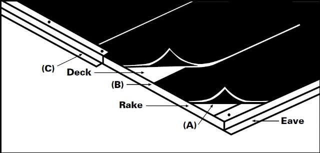

Erby Posted May 14, 2011 Report Share Posted May 14, 2011 Jon, where do you get that no underlayment is "totally permissible." Doesn't the Kentucky Building Code call for underlayment "STARTING AT THE EAVE". What am I missing. ========== R905.2.7 Underlayment application. For roof slopes from two units vertical in 12 units horizontal (17-percent slope), up to four units vertical in 12 units horizontal (33-percent slope), underlayment shall be two layers applied in the following manner. Apply a 19-inch (483 mm) strip of underlayment felt parallel with and starting at the eaves, fastened sufficiently to hold in place. Starting at the eave, apply 36-inch-wide (914 mm) sheets of underlayment, overlapping successive sheets 19 inches (483 mm), and fastened sufficiently to hold in place. For roof slopes of four units vertical in 12 units horizontal (33-percent slope) or greater, underlayment shall be one layer applied in the following manner. Underlayment shall be applied shingle fashion, parallel to and starting from the eave and lapped 2 inches (51mm), fastened sufficiently to hold in place. End laps shall be offset by 6 feet (1829 mm). ========== Click to Enlarge 79.86 KB Quote Link to comment Share on other sites More sharing options...

Erby Posted May 14, 2011 Report Share Posted May 14, 2011 Screw em. I call it every time anyway, even in Fayette County. ======= There is no roofing paper installed under the shingles at the low edge of the roof in some areas. Generally accepted nationwide building practices and most shingle manufacturers' installation instructions call for roofing paper to be installed all the way to the edge of the roof, OVER the metal drip edge at the bottom edge of the roof and UNDER the metal drip edge on rake edges. Consult shingle manufacturer for exact installation instructions and the effect this may have on the manufacturer's warranty. I recommend that roofing paper be installed in accordance with the shingle manufacturer's instructions. ====== Click to Enlarge 26.23 KB Quote Link to comment Share on other sites More sharing options...

Jim Katen Posted May 14, 2011 Report Share Posted May 14, 2011 . . . I recommend that roofing paper be installed in accordance with the shingle manufacturer's instructions. . . That seems like an understated way to phrase that particular recommendation. I mean, it's not possible to install roofing paper once the shingles are in place. So what you're really recommending is that all of the shingles be removed and new shingles be installed over roofing paper. Right? A roofer reading your recommendation will know exactly what's involved, but a customer might not *get* the rather large scope of work that's implyed by that sentence. Quote Link to comment Share on other sites More sharing options...
