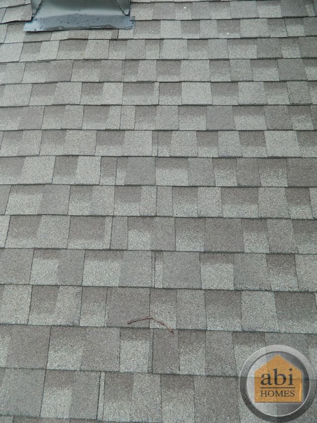

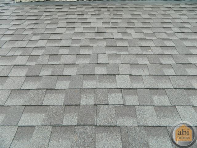

Ben H Posted May 12, 2011 Report Share Posted May 12, 2011 New(ish) roof. Dimensional shingles. I couldn't get an answer on what brand, though it seems it really doesn't matter. I checked the install manual for OC, Certainteed, and GAF. They all are basically the same. I've got what looks like a dimensional roof installed like a 3 tab. You can see the break line every other shingle. All the install guides I read says to use a 4-5 staggered course, so you don't have a solid line that runs up the roof. What say you? Click to Enlarge 149.11 KB Click to Enlarge 65.41 KB Quote Link to comment Share on other sites More sharing options...
Chad Fabry Posted May 12, 2011 Report Share Posted May 12, 2011 It's wrong no matter if it's architectural or three tab. Quote Link to comment Share on other sites More sharing options...
Ben H Posted May 12, 2011 Author Report Share Posted May 12, 2011 I have a feeling I'm going to have to butt heads with the contractor on this one. He had 'his' roofer, who did the install come out and look at it and of course he said it's fine. Big shocker there. The buyer is a real nice guy out of Denver trying to sort things out over the phone. There are no signs of leaks, and it's a few years old. So what are the problems that can/will happen when it's botched like this. Cosmetic only? Quote Link to comment Share on other sites More sharing options...

Marc Posted May 12, 2011 Report Share Posted May 12, 2011 It's likely cosmetic only. The same pattern on 3 tab is common practice. Marc Quote Link to comment Share on other sites More sharing options...
Mark P Posted May 12, 2011 Report Share Posted May 12, 2011 I would not butt heads, I would simply provide the intsall instructions and say its not done right, I don't know if it will leak or not. The manufacturer's warrenty will not apply of it does leak, because it is not done right. Quote Link to comment Share on other sites More sharing options...
Tom Raymond Posted May 12, 2011 Report Share Posted May 12, 2011 It's likely cosmetic only. The same pattern on 3 tab is common practice. Marc That doesn't make it right. If the roofer is too lazy to lay out the shingles right, what else did he screw up. Quote Link to comment Share on other sites More sharing options...
Jim Katen Posted May 12, 2011 Report Share Posted May 12, 2011 It's called the vertical racking method and it's generally allowed with single-thickness shingles such as 3-tabs. The advantage is that it's faster for the installer if he has a big crew because, instead of having to cover the roof row by row, he can cover the roof in vertical columns. The disadvantage is that, in each column, you have to lift up and bend back one shingle every other row to nail the shingle below it. (Hard to describe, sorry.) With 3-tab shingles, this isn't much of a problem, but with laminated ones it can damage the shingle because they don't bend well. So either you damage every other shingle at the end of each column or, if you're a particularly lazy roofer, you omit the nail at every other shingle at the end of each column. It doesn't cause anything to leak. At least not until the shingle damage or lack of nails manifest themselves years later. Jim Katen, Oregon Quote Link to comment Share on other sites More sharing options...
Ben H Posted May 12, 2011 Author Report Share Posted May 12, 2011 Jim's right on. The buyers sent my pics to a roofer here in town (not the guy who did the install) and he called the racking install as well. If I interpreted his email correctly, although not a common practice with laminated, it really won't cause much of a problem as long as they are sealed well. Quote Link to comment Share on other sites More sharing options...

Tom Raymond Posted May 12, 2011 Report Share Posted May 12, 2011 When I was roofer in a former life we called it booking, and only did it on roof overs and only with 3 tabs. It always looked like crap, you could see every column where each installer varied the exposure. I would frequently double nail the overlapped tab since it was way faster than lifting it-I was a teenager, I didn't know any better and the boss didn't care. Quote Link to comment Share on other sites More sharing options...
John Kogel Posted May 12, 2011 Report Share Posted May 12, 2011 When I was roofer in a former life we called it booking, and only did it on roof overs and only with 3 tabs. It always looked like crap, you could see every column where each installer varied the exposure. I would frequently double nail the overlapped tab since it was way faster than lifting it-I was a teenager, I didn't know any better and the boss didn't care. So where are all your former roofs now? [] I agree, that roofer was in a rush and did it the quick and easy way. There could be hidden problems, like missing underlay, missing nails, nails too short, poor flashing, etc. All we can do now is warn the client of possible future problems. Quote Link to comment Share on other sites More sharing options...
