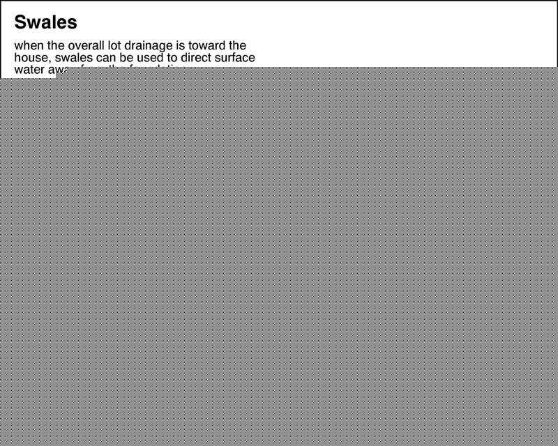

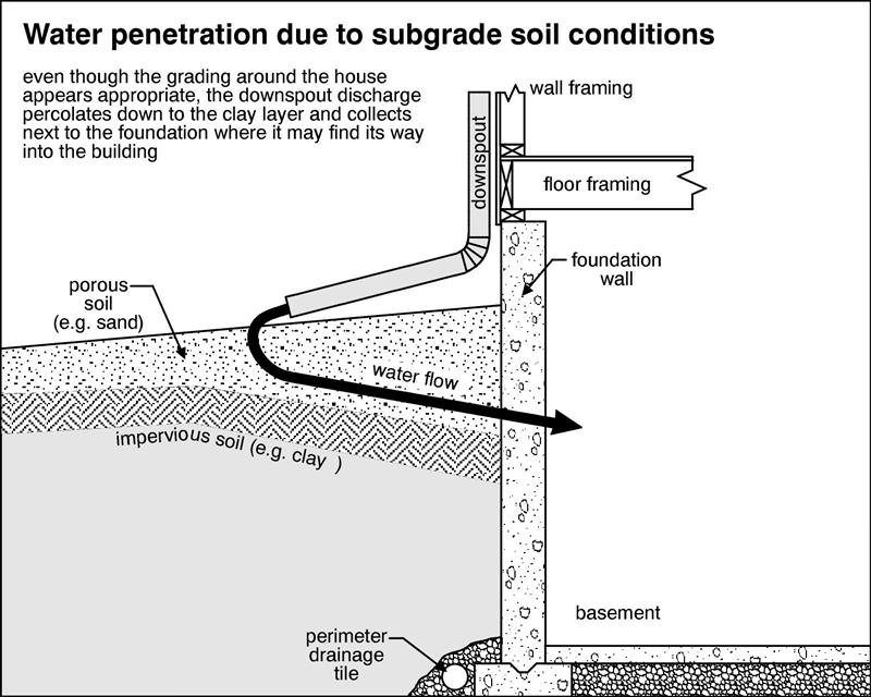

RobC Posted March 16, 2005 Report Share Posted March 16, 2005 Chris, What I see here is a two fold problem. 1. Moisture 2. Building Science Design To repeat what everyone has said because it's most IMPORTANT. Get rid of the H2O. If you have a round hole in the ground it's called a well. It's supposed to have water If it's square it's called a basement/crawlspace and it's met to be DRY. I'd say almost everyone here can help you with that. Here is something you may wish to add to your design if you so desire. Download Attachment: FdnSeepageTroughs_M.JPG 93 KB Adding leaders is a good idea providing they are effective. Notice the drainage tile around the perimeter of the footing. That may be something to consider if conditions demand it. On the bigger picture. Download Attachment: Swales_M.JPG 138.04 KB There is more but you get the idea. Now comes the difficult part of the remedial process and something I would not attempt to solve without further information. Here's a GREAT resource from my library. Builder's Guide to Cold Climates Details for design and construction by Joseph Lstiburek And lastly, I would drive around the hood and check out crawls that are working and copy their designs - no cost. Now, if it's a high water problem .......and you really want to see snow, have I got a deal for you. Quote Link to comment Share on other sites More sharing options...

chrisprickett Posted March 16, 2005 Author Report Share Posted March 16, 2005 Originally posted by RobC Chris, What I see here is a two fold problem. 1. Moisture 2. Building Science Design To repeat what everyone has said because it's most IMPORTANT. Get rid of the H2O. If you have a round hole in the ground it's called a well. It's supposed to have water If it's square it's called a basement/crawlspace and it's met to be DRY. I'd say almost everyone here can help you with that. Here is something you may wish to add to your design if you so desire. Download Attachment: FdnSeepageTroughs_M.JPG 93 KB Adding leaders is a good idea providing they are effective. Notice the drainage tile around the perimeter of the footing. That may be something to consider if conditions demand it. On the bigger picture. Download Attachment: Swales_M.JPG 138.04 KB There is more but you get the idea. Now comes the difficult part of the remedial process and something I would not attempt to solve without further information. Here's a GREAT resource from my library. Builder's Guide to Cold Climates Details for design and construction by Joseph Lstiburek And lastly, I would drive around the hood and check out crawls that are working and copy their designs - no cost. Now, if it's a high water problem .......and you really want to see snow, have I got a deal for you. Rob, The builder's done about 150 of the same design, and they all are built exactly the same. All have water. I'm getting cold feet (pun intended). Quote Link to comment Share on other sites More sharing options...

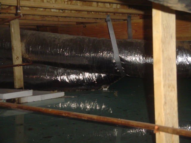

Corners Posted March 19, 2005 Report Share Posted March 19, 2005 Do you have any pics of the property? Quote Link to comment Share on other sites More sharing options...
chrisprickett Posted March 19, 2005 Author Report Share Posted March 19, 2005 Originally posted by Corners Do you have any pics of the property? Here's a few... Download Attachment: Ducting laying in water.JPG 155.87 KB Download Attachment: Crawl.JPG 145.31 KB Quote Link to comment Share on other sites More sharing options...
Jim Katen Posted March 19, 2005 Report Share Posted March 19, 2005 Originally posted by chrisprickett Originally posted by Corners Do you have any pics of the property? Here's a few... That water is unacceptable in a crawlspace. Ducts that have been in the water should be removed, discarded and replaced. I live, eat & breathe crawlspaces on a daily basis. What you have there is a big problem. - Jim Katen, Oregon Quote Link to comment Share on other sites More sharing options...
RobC Posted March 19, 2005 Report Share Posted March 19, 2005 AND I would add to Jim' post that the TrusJoists are met for dry application. In this constantly wet enviroment they could be compromised over time and fail. 150 wet crawls! Now that's something to be proud of. Quote Link to comment Share on other sites More sharing options...
