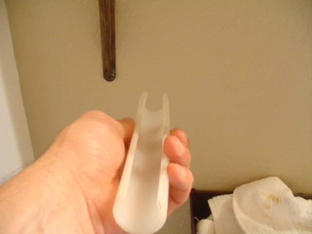

chrisprickett Posted March 24, 2005 Report Share Posted March 24, 2005 I hate to wait for tubs to fill to the overflow, and I'm always worried about leaving them to fill and forgetting to check(insert senility joke here). I've come up with a little trick that makes my life much easier. All it is is a 10" piece of 1 1/4 PEX with about at 3/4" vertical strip removed. I carry two of them anyway because I use them to protect my telescopic ladder when I lean it against a roof. They are beneficial because: 1. Saves time 2. Shoots water into the overflow so you can see if the top part of the overflow leaks 3. Eliminates forgetting to turn off tub 4. Your arm doesn't get wet up to the elbow from draining the tub 5. Also works on sink overflows 6. You can control the amount of water in case there IS a leak 7. Saves time Download Attachment: overflow thingy1.JPG 153.15 KB Download Attachment: overflow thingy2.JPG 134.22 KB Link to comment Share on other sites More sharing options...

Jim Katen Posted March 25, 2005 Report Share Posted March 25, 2005 Originally posted by chrisprickett . . . They are beneficial because: 1. Saves time 2. Shoots water into the overflow so you can see if the top part of the overflow leaks 3. Eliminates forgetting to turn off tub 4. Your arm doesn't get wet up to the elbow from draining the tub 5. Also works on sink overflows 6. You can control the amount of water in case there IS a leak 7. Saves time 8. Improves your aim when using a low toilet. - Jim Katen, Oregon Link to comment Share on other sites More sharing options...
Terence McCann Posted March 28, 2005 Report Share Posted March 28, 2005 Originally posted by Jim Katen Originally posted by chrisprickett . . . They are beneficial because: 1. Saves time 2. Shoots water into the overflow so you can see if the top part of the overflow leaks 3. Eliminates forgetting to turn off tub 4. Your arm doesn't get wet up to the elbow from draining the tub 5. Also works on sink overflows 6. You can control the amount of water in case there IS a leak 7. Saves time 8. Improves your aim when using a low toilet. - Jim Katen, Oregon 9. For those that have been cut on the bias. Link to comment Share on other sites More sharing options...

excalibur Posted May 9, 2005 Report Share Posted May 9, 2005 Good trick Chris... Link to comment Share on other sites More sharing options...
