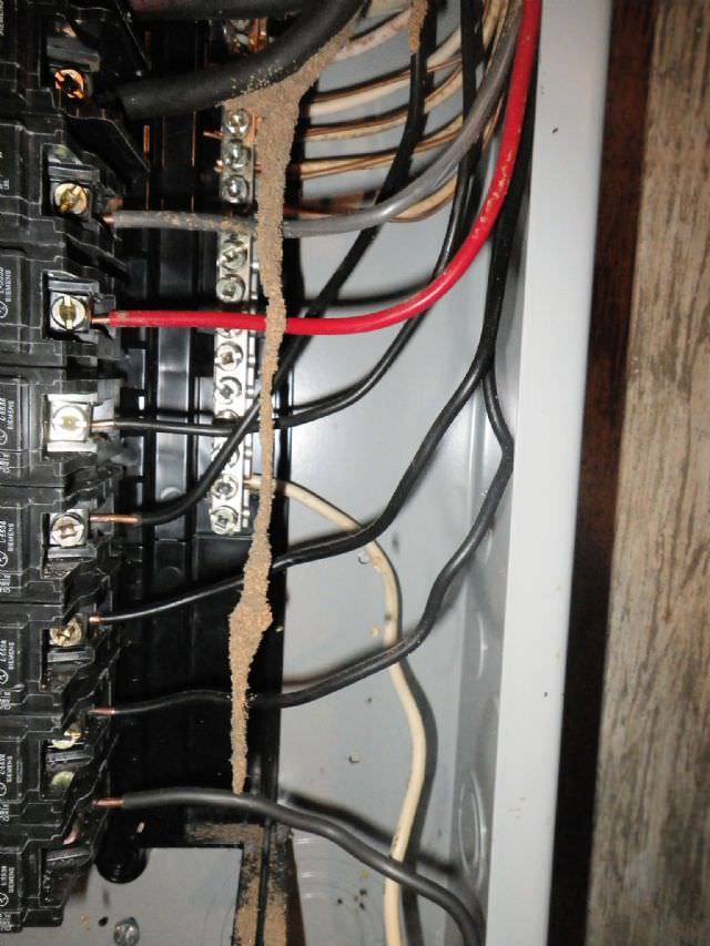

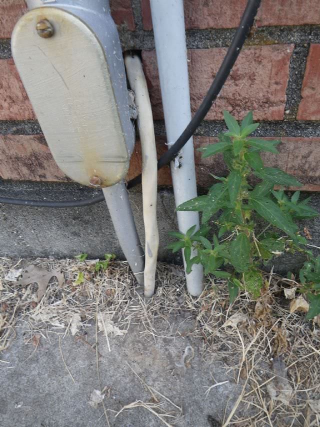

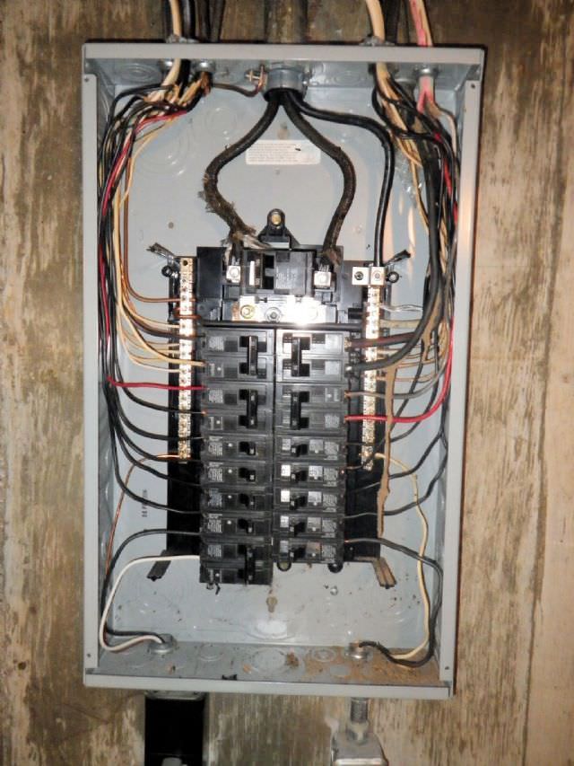

Mark P Posted August 2, 2011 Report Share Posted August 2, 2011 Wire disapears under the patio - no idea what it is for or where the other end is. Not for the ac and no yard lights. Click to Enlarge 128.14 KB Termites got inside the sheathing and were eating the paper. Click to Enlarge 50.02 KB Panel dated 2006 - so this is not to old. Click to Enlarge 106.24 KB No other signs of termites anywhere is the house. Click to Enlarge 96.65 KB Has anyone seen anything like this before? I can't really think it would be a problem with the wire - do you? Quote Link to comment Share on other sites More sharing options...

Jim Katen Posted August 2, 2011 Report Share Posted August 2, 2011 Mark, if you could, I'd love to have high rez versions of those pics - jim@amipdx.com I'd say that it's a big problem. For one thing, you now have a well-established termite highway into the building. *No one* can say how long it'll take the termites to figure out how to get from there to the house's wood framing. The termites will need to be treated. What chemicals are listed for use *inside* NM cable? Will they damage the insulation or the wires? Does any really know that the termites haven't damaged the insulation around the conductors? Termites are certainly capable of it. There are good reasons why NM cable isn't allowed to be used underground - even if it's in conduit. This is probably not one of the reasons that the code authors anticipated, but it's definitely the outcome of using the wrong product in the wrong place. Quote Link to comment Share on other sites More sharing options...
ghentjr Posted August 2, 2011 Report Share Posted August 2, 2011 while they are capable "of it" they will not eat the wire coating if paper is available. A chemical treatment on the exterior is the solution. Any of the chemicals used would be soil treatments designed to get to the colony. Never heard of the little buggers eating the wire coating. Once the colony is introduced to the chemical it would eliminate the problem. There is no evidence of termites eating non cellulose products that I am aware of. Quote Link to comment Share on other sites More sharing options...
John Kogel Posted August 3, 2011 Report Share Posted August 3, 2011 But it is the wrong cable for direct burial, so the outside portion needs to be replaced anyway. Nice catch, Mark. Quote Link to comment Share on other sites More sharing options...

Jim Katen Posted August 3, 2011 Report Share Posted August 3, 2011 while they are capable "of it" they will not eat the wire coating if paper is available. A chemical treatment on the exterior is the solution. Any of the chemicals used would be soil treatments designed to get to the colony. Never heard of the little buggers eating the wire coating. Once the colony is introduced to the chemical it would eliminate the problem. There is no evidence of termites eating non cellulose products that I am aware of. Termites don't eat plastic but they will easily chew through it if it makes it easier to get to the paper. I've seen them mine out vinyl flooring to get to framing. There's a very real danger that they chewed through some of the plastic somewhere in the cable. Sure a chemical treatment will probably kill the colony. But the damage to the cable is done -- and it shouldn't have been used underground or outdoors anyway. Of course the termites should be treated, but the cable should also be replaced. Heck, it should be replaced even if it wasn't damaged by the termites. Quote Link to comment Share on other sites More sharing options...
