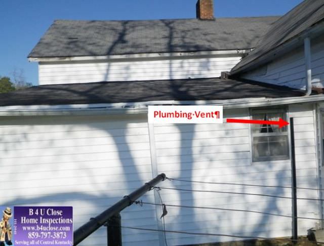

Erby Posted October 7, 2011 Report Share Posted October 7, 2011 C'mon now. Venting? What next? You gonna call for a grounding system too! Click to Enlarge 50.38 KB [:-monkeyd[:-monkeyd[:-monkeyd - Quote Link to comment Share on other sites More sharing options...
Bain Posted October 7, 2011 Report Share Posted October 7, 2011 C'mon now. Venting? What next? You gonna call for a grounding system too! Click to Enlarge 50.38 KB [:-monkeyd[:-monkeyd[:-monkeyd - I'm almost certain I looked at that same house for some people who walked. Quote Link to comment Share on other sites More sharing options...
Erby Posted October 7, 2011 Report Share Posted October 7, 2011 Irvine Road? Old farmer moving to town? Quote Link to comment Share on other sites More sharing options...
