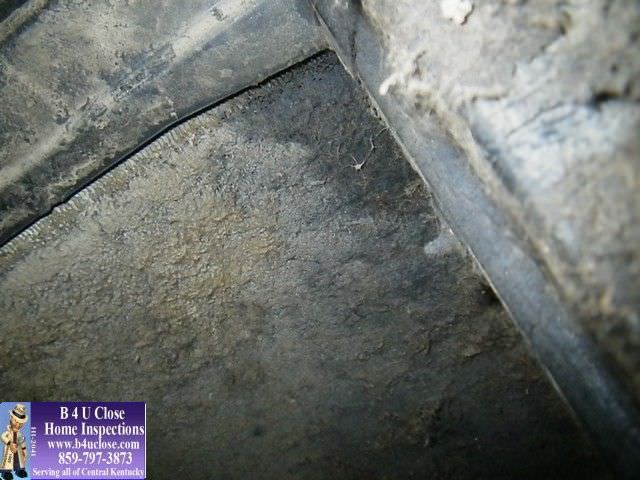

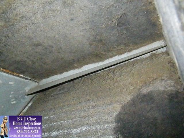

Erby Posted February 2, 2012 Report Share Posted February 2, 2012 There's a coil under that crud somewhere. Click to Enlarge 66.67?KB Click to Enlarge 65.24?KB Link to comment Share on other sites More sharing options...

Erby Posted February 3, 2012 Report Share Posted February 3, 2012 Here's the trip wire I look for on interior HVAC units. I can almost always get my camera in there. Click to Enlarge 59.91 KB When I see that, the coil is almost always the same. Click to Enlarge 27.86 KB ================= The main blower fan blades are covered with crud which impedes the operating efficiency of the unit. This has also usually allowed dust to come in contact with the wet air conditioning coils. Wet plus dust equals mud on the coils equals coils being partially blocked. I can't see the coils to verify this though. Get the unit serviced and cleaned (to include removal and cleaning of both the fan and the coils). ================= Link to comment Share on other sites More sharing options...
