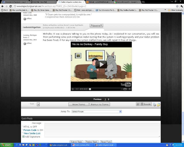

Michelle: It was a pleasure talking to you on the phone today. As I explained in our conversation, you will see from performing some post-mitigation radon testing that the system is working properly and your radon problem has been fixed. If for any reason the system malfunctions, we will repair it free of charge.
Matt, you removed the lovely video you had posted with this comment which completely changes the tone. Keeping it classy.

It certainly wasn't him. It was one of the moderators here "keeping it classy".
