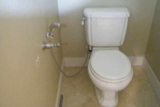

Brandon Whitmore Posted April 2, 2012 Report Share Posted April 2, 2012 This one gave me a chuckle today. I'm not sure if it was intended as a bidet, or if someone used it to shower while sitting on the throne Click to Enlarge 20.61 KB Link to comment Share on other sites More sharing options...
Scottpat Posted April 2, 2012 Report Share Posted April 2, 2012 Most likely to wash out a bedpan or something similar.. Link to comment Share on other sites More sharing options...
inspector57 Posted April 2, 2012 Report Share Posted April 2, 2012 Bidet, I see it quite frequently in certain ethnic/religious instances. Obviously they need to go, no backflow prevention and usually uses a self-piercing valve. Link to comment Share on other sites More sharing options...
Brandon Whitmore Posted April 2, 2012 Author Report Share Posted April 2, 2012 no backflow prevention That's the technical reason I told them it had to go. I have a feeling it will make a mess as well. The agent told me that this is quite common in some countries. usually uses a self-piercing valve. That's what I expected to see, but they actually used a compression T. Link to comment Share on other sites More sharing options...

Erby Posted April 2, 2012 Report Share Posted April 2, 2012 I'd go with Scott's explanation, not poor man's bidet. Water's too cold for that. At least, that's what the seller told me when I found one like that. Link to comment Share on other sites More sharing options...
