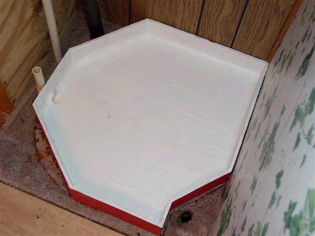

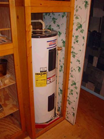

Brian G Posted June 6, 2005 Report Share Posted June 6, 2005 I needed an odd-shaped drip pan for the new water heater in my old mobile home, so I made one out of plywood. I had to have room to take the pipes through the floor (no place else to go) and it had to fit inside a false cabinet. The bottom is 3/4 plywood, thick enough to screw the 3/8 sides to. Then I slathered it with a thick layer of polyurethane caulk (50 year rated life, outdoors). I guarantee you it will not leak anywhere but the drain line. I gave that a plumbing vent...why not? I can't help thinking what many of us would say if we found such a thing on an inspection. I can hear Walter Jowers now..."Unconventional things behave in unconventional ways"...but I'm not worried about this one. Download Attachment: goodmanpan1.JPG 26.76 KB Download Attachment: goodmanpan2.JPG 38.26 KB Brian G. Great American Home Engineer [^] Quote Link to comment Share on other sites More sharing options...

Brian G Posted June 6, 2005 Author Report Share Posted June 6, 2005 What can I say, it was that or nothing. Since I own the trailer and my girl is moving in, nothing was not an option. The old water heater leaked once while I lived in it, but we caught it early. I was looking at that one while remodeling one day. It was 21 years old (bought it used 15 years ago), the water connections were semi-corroded, the relief piping was standard PVC and only went to the crawl space, there was no drip pan, etc.,etc.... I thought to myself, "I recommend replacing it with a nice, new, clean, more efficient one, with a drip pan and drain line to help protect my investment". Done. Brian G. Domestic Construction Artist [:-propell Quote Link to comment Share on other sites More sharing options...

Richard Moore Posted June 6, 2005 Report Share Posted June 6, 2005 Brian... Did you place anything between the water heater and caulk, or are you planning on moving before the heater needs to be pryed out? Quote Link to comment Share on other sites More sharing options...
Brian G Posted June 7, 2005 Author Report Share Posted June 7, 2005 Originally posted by Richard Moore Did you place anything between the water heater and caulk, or are you planning on moving before the heater needs to be pryed out? Two layers of aluminum foil, o' shrewd one from across the big pond. My Momma only raised one fool, an' he's my brother so don't start on him. [] Brian G. Semi-Clever Redneck [:-dopey] Quote Link to comment Share on other sites More sharing options...

Richard Moore Posted June 7, 2005 Report Share Posted June 7, 2005 Originally posted by Brian G. Two layers of aluminum foil... That will work. I shall never doubt your foresightedness(?) again. [:-taped] Personally, I would have gone with a raised "griddle" of ¼" Lexan strips set into the caulk, but that's only because I keep the stuff on hand for jigs, router bases, etc. Thinking about what I have readily available, I probably would have made the base with a nice cherry plywood and solid cherry sides and then used a clear epoxy resin for the finish. After admiring my handiwork for about a month, I would eventually, and very reluctantly, set the damn ugly water heater on it. Richard M. Selectively Anal [:-propell Quote Link to comment Share on other sites More sharing options...
