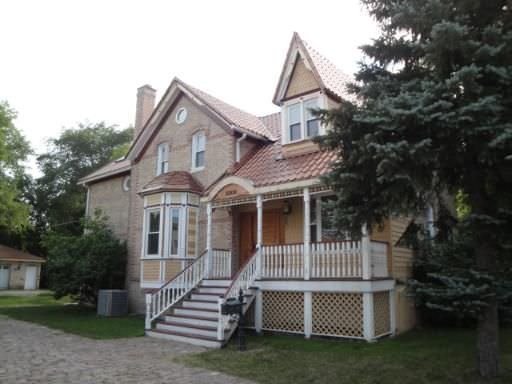

asihi Posted May 19, 2012 Report Share Posted May 19, 2012 I have a job next week with a home that has a metal roof. The buyer said that it was a copper roof. When I asked him if it's possible that the roof may be steel with a copper colored coating, he said no. He was told it was copper. Can someone give me some tips on how to distinguish a copper roof from a steel roof with a copper coating? I can't remember the last time I've seen a roof that wasn't wood or asphalt. I did find a picture of the listing, but it's not that great of a shot. Thanks for your help. Tony Click to Enlarge 35.42 KB Quote Link to comment Share on other sites More sharing options...
Mark P Posted May 19, 2012 Report Share Posted May 19, 2012 Copper is a very soft metal - I would take a small pocket knife and scratch into a shingle (when no one is looking of course) I would think that if it is a copper coating it would scratch off and reveal what is underneath. Just an idea as I have neer seen a roof like the one in the picture. You might also ask the seller for any information / documantion they have. I would not be shy about telling my customer I have never seen a roof like this and am no expert. Quote Link to comment Share on other sites More sharing options...

hausdok Posted May 19, 2012 Report Share Posted May 19, 2012 It could be copper. That would be a good choice on a period home. It might also be zinc-coated aluminum with a baked on finish. Bring a small refrigerator magnet to see if it will stick. If it does, you'll know it's not copper, in which case you'll have to figure out whether it's copper or aluminum. Get yourself a free subscription to Metal Roofing Magazine. Lots of good information about metal roofs in every issue. ONE TEAM - ONE FIGHT!!! Mike Quote Link to comment Share on other sites More sharing options...
Tom Raymond Posted May 19, 2012 Report Share Posted May 19, 2012 It's shiny like a new penny, it's painted steel or aluminum. Even brand smacking new copper sheets would have some patina on them and a less than uniform color. Quote Link to comment Share on other sites More sharing options...
Rob Amaral Posted May 19, 2012 Report Share Posted May 19, 2012 Like Mike said.. use a magnet.. R Quote Link to comment Share on other sites More sharing options...
Bain Posted May 20, 2012 Report Share Posted May 20, 2012 There's no verdigris on that roof, so I assume it's supposed to be fairly new. With today's copper prices, those shingles installed would cost somewhere between $2,000.00 and $2,500.00 a square. My money is on the "not copper." Quote Link to comment Share on other sites More sharing options...
kurt Posted May 20, 2012 Report Share Posted May 20, 2012 It isn't copper. No copper roof looks like that, even when new. There's a bunch of metal roofing going on in Chicago that's like this; copper color, steel or aluminum material. Quote Link to comment Share on other sites More sharing options...

asihi Posted May 20, 2012 Author Report Share Posted May 20, 2012 Thanks everyone. I was skeptical when I was told it was copper roof. The house is located in a nice blue-collar town. A copper roof would have been a fortune and would have been way over done for this neighborhood. I like the magnet idea. I'm going to give that a try. Thanks again. Tony Quote Link to comment Share on other sites More sharing options...
