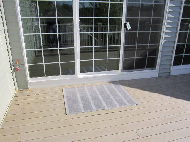

asihi Posted June 13, 2012 Report Share Posted June 13, 2012 I had a job at a new townhouse this afternoon. In the basement furnace room, the builder enclosed the foundation walls with extruded polystyrene. I was under the impression that this material cannot be left exposed. The certificate of occupancy was issued yesterday and I'm going to call them in the morning about this and a few other things. I just want to make sure that I have my facts right. Thanks for your help. Tony Click to Enlarge 55.03 KB Quote Link to comment Share on other sites More sharing options...

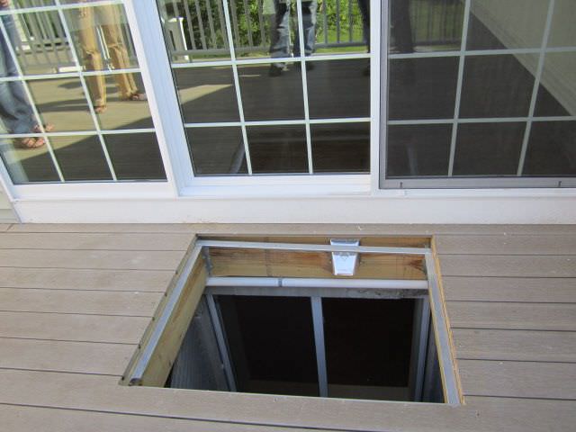

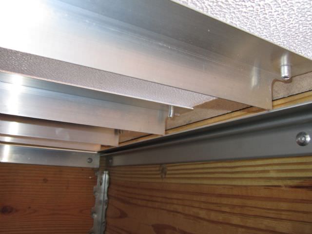

asihi Posted June 13, 2012 Author Report Share Posted June 13, 2012 Thanks for the information. That was very helpful and yes, that's a circulating loop to the 2nd floor fixtures. One other thing that has me scratching my head is the placement of the window well covers. They built a deck over the basement egress windows and were required to build an access that "a 7 year old can open" according to the village. These openings are directly in front of the operable panels for the dual sliding glass doors and are about 4'x4'. They built these covers out of some sort of plexi-glass and aluminum struts and set them in the opening. I weigh about 180lbs (give or take a few) and these panels flexed to the point to where I thought I was going to fall through. Plus they were loose. Anyone can lift them off. If the cover was left off for any reason, someone walking through the door can go right down the well. I find it hard to believe that this isn't a safety concern and that the village let this slide. I'm going to give them a call. I'd like to get some opinions though. Thanks again. Tony Click to Enlarge 47.58 KB Click to Enlarge 50.55 KB Click to Enlarge 51.83 KB Click to Enlarge 37.33 KB Quote Link to comment Share on other sites More sharing options...
kurt Posted June 13, 2012 Report Share Posted June 13, 2012 I'd want to see an engineers seal or other verification; could be just fine, could be bubba getting creative. Quote Link to comment Share on other sites More sharing options...
exploreparadise2 Posted June 13, 2012 Report Share Posted June 13, 2012 With that deck hatch in place, does the window still provide the ventilation requirements for the room? Quote Link to comment Share on other sites More sharing options...
Jerry Simon Posted June 13, 2012 Report Share Posted June 13, 2012 Who's the scientist who placed an escape window under a sliding door where one assumes a deck would be buiilt? That's truly f****'d up. Quote Link to comment Share on other sites More sharing options...
Tom Raymond Posted June 13, 2012 Report Share Posted June 13, 2012 Is the whole complex like this? No one caught this condition until the decks were built? That's an awful lot of imbeciles in one place. Back to the foam for a minute; Dirck's cite is about bugs, what about the smoke and flame spread index? I was under the impression it had to be covered. Quote Link to comment Share on other sites More sharing options...
asihi Posted June 13, 2012 Author Report Share Posted June 13, 2012 Who's the scientist who placed an escape window under a sliding door where one assumes a deck would be buiilt? That's truly f****'d up. Yeah it's a mess. This place is built on the bottom of a sloping lot. All the other townhouses in the complex either have garden basement windows or walk-outs. Whoever designed the ones at the bottom of the hill apparently didn't design them tall enough and needed to use egresses. As far as the foam board, I was doing a little research in the 2006 IRC and found section R314 Foam Plastics. Paraphrasing section R314.4 says that the exposed foam board needs to be separated from the interior with an approved thermal barrier minimum 0.5 inches thick. There are a few exceptions and I called the village to find out if they apply, but so far I haven't heard back. Quote Link to comment Share on other sites More sharing options...
asihi Posted June 14, 2012 Author Report Share Posted June 14, 2012 Just to do a little follow up, I did speak to the village inspector about this stuff. Regarding the well covers, he said that they have documentation from the manufacturer that those things are rated for 500lbs. I gave my client the number of a company that makes custom steel grates. He couldn't give me an answer about the foam board. I found the manufacturers requirements about covering the stuff and the code requirement saying the same thing. He agreed and said that the guy that approved this was out of town until next Friday. Maybe he has additional information. Here's my question; they want to close early next week. Once the CO is approved and issued, can or do these guys change their mind and make the builder change something? The buyer is worried that she'll have to pay for it once they close. Quote Link to comment Share on other sites More sharing options...
