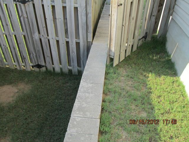

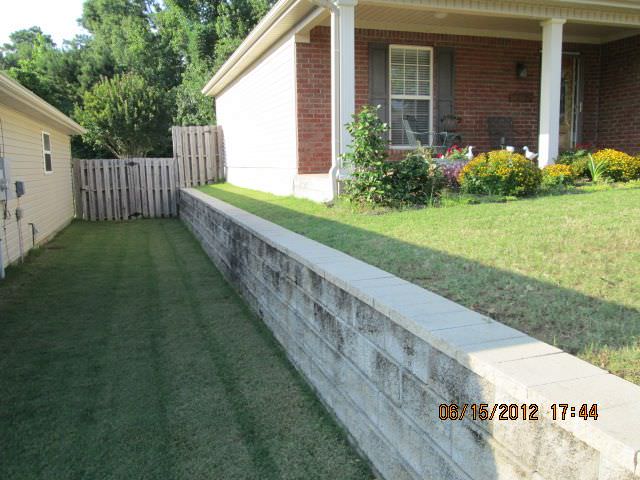

Phillip Posted June 16, 2012 Report Share Posted June 16, 2012 What comment would you make about this set up. I suggested that they move the gate to the other side of the house. Click to Enlarge 70.79 KB Click to Enlarge 70.76 KB Link to comment Share on other sites More sharing options...
fyrmnk Posted June 16, 2012 Report Share Posted June 16, 2012 Wow, those are playing tricks on my eyes. First pic looks like it closes over the top of the wall, then it's obviously hitting it in the second. They could fasten a post with the receiver latch to the adjoining fence and stair step the gate. Done pretty common here with a common shared fence to fasten both gates to one fence. Even if the gate is moved something similar would still need done if they don't want a gap at the wall, unless there is another full fence on this side of the wall as well. Link to comment Share on other sites More sharing options...
Inspectorjoe Posted June 16, 2012 Report Share Posted June 16, 2012 I'd recommend a guard rail at the top of the wall and not mention the idiotic gate setup. Link to comment Share on other sites More sharing options...
inspector57 Posted June 16, 2012 Report Share Posted June 16, 2012 I would not comment on the gate. I would say a partial opening gate is more useful than the solid fence likely to replace the gate. I would be a little more concerned about the distance of the foundation to the retaining wall, especially since around here a retaining wall that height would not be required to be engineered. Since the wall appears to be within the "angle of repose" of the foundation, it would need to be engineered to support the foundation, no? Link to comment Share on other sites More sharing options...
gtblum Posted June 16, 2012 Report Share Posted June 16, 2012 I'd suggest they make sure their mower fits through the opening, before buying the place. Link to comment Share on other sites More sharing options...
John Kogel Posted June 16, 2012 Report Share Posted June 16, 2012 After 5 or 6 relooks, I see the gate does swing over the wall. It just looks like it's hitting in pic 2. I'd mention the gate in passing, but would write up the proximity of the house to the wall, as Jim L. brought up. I like a gate on either side of the house. Link to comment Share on other sites More sharing options...
Phillip Posted June 16, 2012 Author Report Share Posted June 16, 2012 I am concern that someone could trip on the wall as they go out the gate. It did not catch on the wall when it opened and closed There was no signs of movement at the house or the retaining wall. The house is ten years old. Link to comment Share on other sites More sharing options...
John Kogel Posted June 16, 2012 Report Share Posted June 16, 2012 I am concern that someone could trip on the wall as they go out the gate. If they do that, they're trespassing. [] I know what you mean, though. Sometimes I will recommend putting up a trellis or a fence. A row of shrubs, maybe? Link to comment Share on other sites More sharing options...
Bill Kibbel Posted June 16, 2012 Report Share Posted June 16, 2012 I am concern that someone could trip on the wall as they go out the gate. Switch the hinges to the other side of the gate. Link to comment Share on other sites More sharing options...
Ben H Posted June 16, 2012 Report Share Posted June 16, 2012 I am concern that someone could trip on the wall as they go out the gate. Switch the hinges to the other side of the gate. Bingo. Link to comment Share on other sites More sharing options...
