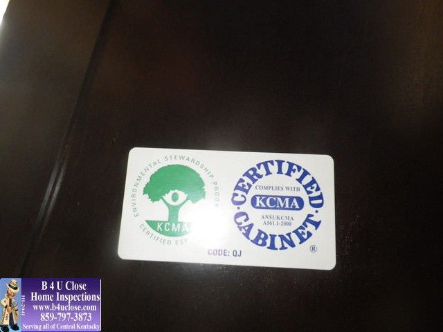

Erby Posted July 24, 2012 Report Share Posted July 24, 2012 Looks like this. Click to Enlarge 36.38?KB The code "QJ" (at bottom center) on this one identifies the manufacturer of the cabinet as: MC-2 (QJ) Masco/Quality Cabinets PO Box 1946, Adrian, MI USA Phone: (517)263-0771 www.qualitycabinets.com Code decipher at: http://www.kcma.org/index.cfm?fuseactio ... ode_Search The label is usually on one of the doors under the kitchen sink but sometimes on a bathroom vanity cabinet door. Link to comment Share on other sites More sharing options...
Marc Posted July 24, 2012 Author Report Share Posted July 24, 2012 Where's MC-2 on the label? There's no QJ at KCMA. What am I reading wrong? Also, does anyone have the citation regarding the need for escutcheons on plumbing stub outs? Marc Link to comment Share on other sites More sharing options...

Erby Posted July 24, 2012 Report Share Posted July 24, 2012 (QJ) follows the MC-2 (in parentheses) Link to comment Share on other sites More sharing options...
