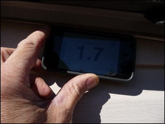

John Dirks Jr Posted September 24, 2012 Report Share Posted September 24, 2012 No no no....you should not have asphalt shingles on this roof section. Click to Enlarge 30.71 KB Link to comment Share on other sites More sharing options...

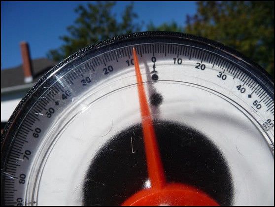

John Dirks Jr Posted September 24, 2012 Author Report Share Posted September 24, 2012 For accuracy, shouldn't it be ON the shingles. To some degree, not necessarily. The shingles don't always follow the same exact pitch considering the way they overlap each other. The trim under the edge is basically representing the pitch of the roof surface. I also used an angle gauge on the shingles. 2:12 = 10% so less than 10% should not have asphalt shingles. Click to Enlarge 81.4?KB Click to Enlarge 45.11?KB Link to comment Share on other sites More sharing options...
Steven Hockstein Posted September 24, 2012 Report Share Posted September 24, 2012 I tested my pitch gauge app with a 45 degree triangle and it did not read 12 on 12. Be careful when using this to check a roof pitch. Use a level and a ruler or You can also use an angle finder like this: http://www.homedepot.com/buy/johnson-pi ... r-750.html Edit-You beat me to it! Link to comment Share on other sites More sharing options...
John Dirks Jr Posted September 24, 2012 Author Report Share Posted September 24, 2012 I've found that the iphone app that I have works pretty good. It has a calibration feature where you position it on a level and set it to 0. Link to comment Share on other sites More sharing options...

rkenney Posted September 24, 2012 Report Share Posted September 24, 2012 2:12 is 7.5 degrees. I don't know what your 10% (% is the percent sign) refers to. So looking at your angle gauge in the second post you have a 2:12 roof. If they're the right shingles with cement it is an appropriate use. Link to comment Share on other sites More sharing options...

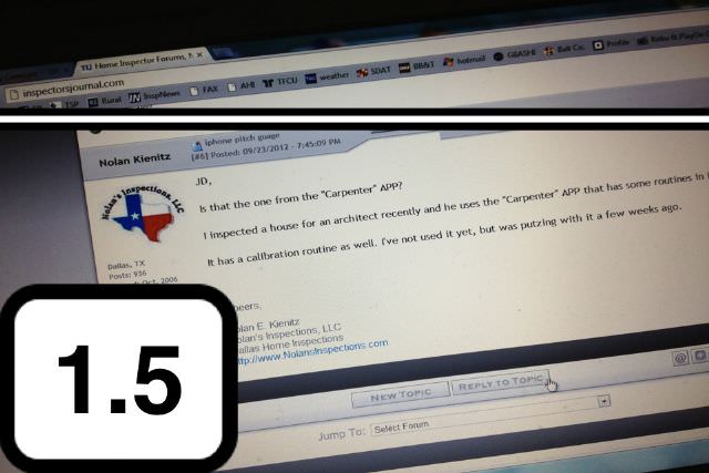

John Dirks Jr Posted September 24, 2012 Author Report Share Posted September 24, 2012 The one I have is Pitch Gauge 2.1 by Prolific Methods LLC It also has a built in calculator for material estimates and the like. Another cool feature is a camera function that shows the pitch reading in the frame. (gotta pay 99 cents for that version) Don't bother trying to measure the angle of the photo in this post. The computer screen was tilted back so the angle represented is misleading. Click to Enlarge 41.61?KB Link to comment Share on other sites More sharing options...

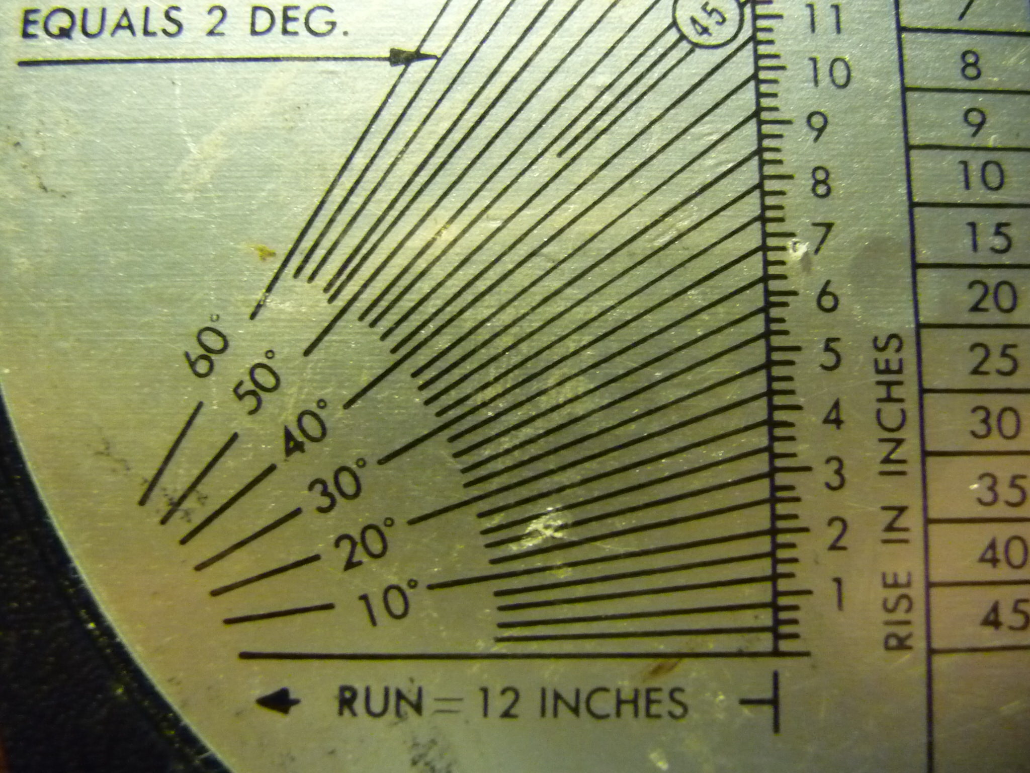

John Dirks Jr Posted September 24, 2012 Author Report Share Posted September 24, 2012 2:12 is 7.5 degrees. I don't know what your 10% (% is the percent sign) refers to. So looking at your angle gauge in the second post you have a 2:12 roof. If they're the right shingles with cement it is an appropriate use. How do you figure that? The scale on my pitch gauge doesn't say that. Here's the pic of it. Download Attachment: P1290990.JPG 1289.8 KB Link to comment Share on other sites More sharing options...
John Dirks Jr Posted September 24, 2012 Author Report Share Posted September 24, 2012 2:12 is 7.5 degrees. I don't know what your 10% (% is the percent sign) refers to. So looking at your angle gauge in the second post you have a 2:12 roof. If they're the right shingles with cement it is an appropriate use. BTW, you are correct in pointing out that I used the wrong symbol to represent degrees. However, 10 degrees is a heck of alot closer to 2:12 then 7.5 degrees is. Link to comment Share on other sites More sharing options...
rkenney Posted September 24, 2012 Report Share Posted September 24, 2012 12:12 is a 45 degree angle, half of that is 6:12 (22 .5), etc. etc. Point is, your protractor doesn't resolve to that accuracy (much less 9.46). Eyeball works much better, and unless you can find something more substantial to condemn the roof covering you are splitting hairs. Link to comment Share on other sites More sharing options...
Marc Posted September 24, 2012 Report Share Posted September 24, 2012 12:12 is a 45 degree angle, half of that is 6:12 (22 .5), etc. etc. 6/12 is 26.56 degrees. It's a tangential function, not linear. Error increase as.....never mind. Marc Link to comment Share on other sites More sharing options...
