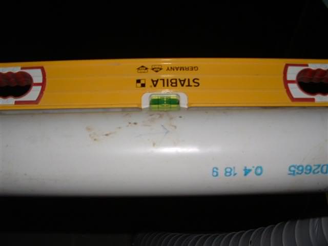

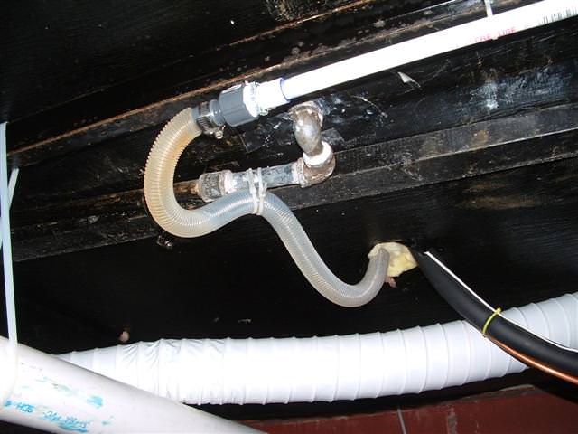

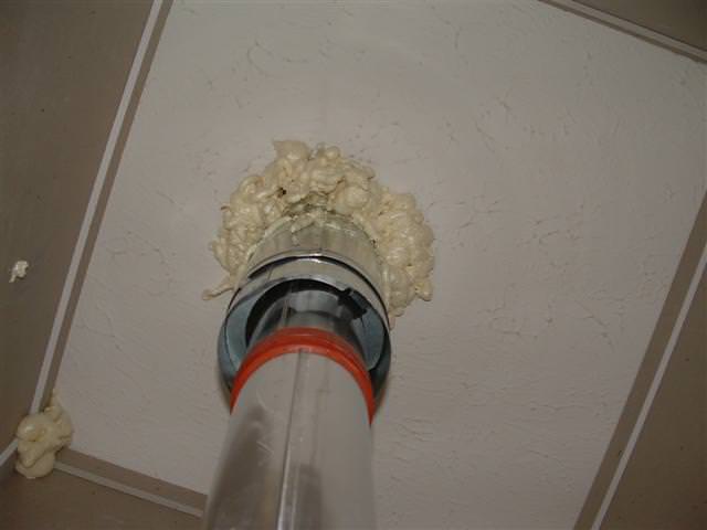

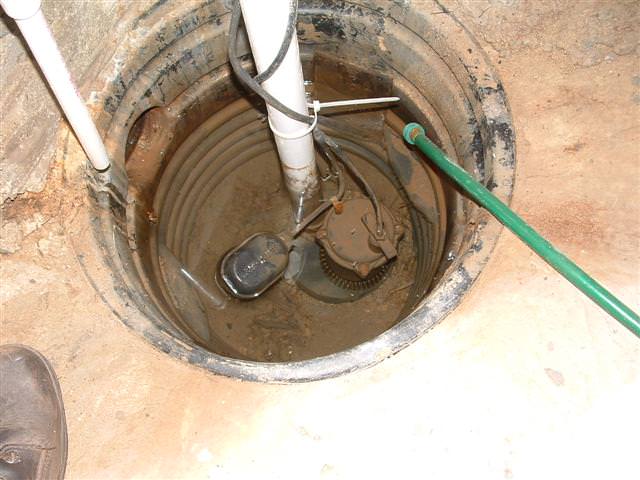

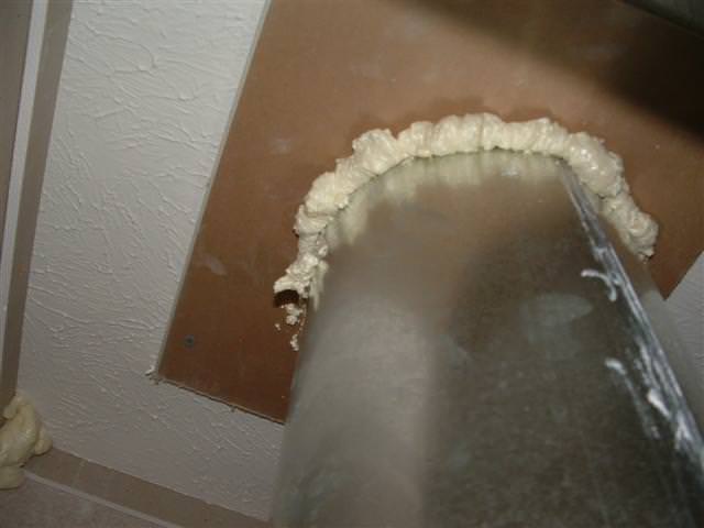

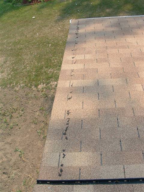

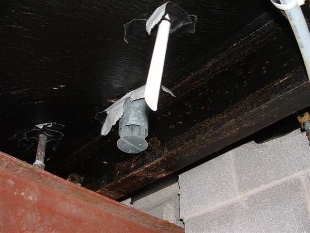

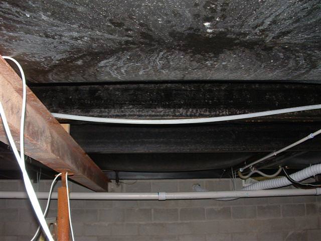

Chad Fabry Posted July 5, 2005 Report Share Posted July 5, 2005 I just inspected the first modular home of my career. I didn't know it was a modular before I got there or I'd have boned up on modular contruction beforehand. Who the heck would pay an inspector 400 bucks to inspect a modular? The roof was surface stapled at the gable ends and then the staples were gooped up..presumably to keep the roof on during transport. Is that normal? Download Attachment: blackstuff.JPG 77.72 KB The insulation below the floor was all sagging and about a foot away from the house. What bothered me more was it was all installed with the vapor toward the conventional style (wet) basement. If the modular is on a basement, shouldn't the vapor barrier be against the floor? Download Attachment: insulation.JPG 53.32 KB Here's the water heater discharge. The homeowner has work bench directly below this. The WH intake for combustion is the funky thing next to the discharge. Download Attachment: discharge.JPG 45.52 KB Here's the main waste line. I drew an arrow on the pvc to show direction of intended flow. Download Attachment: horizontal.JPG 19.8 KB Condensate trap: Download Attachment: contrap.JPG 48.34 KB I showed that photo because this is where the condensate goes. So is the trap even an issue? Download Attachment: sump1.JPG 54.02 KB Here are the furnace and WH flues. Download Attachment: foamflue.JPG 27.4 KB Download Attachment: foamflue2.JPG 22.98 KB The basement entry stairs have kickers made of OSB, would you call this, given the environment? It hasn't rained here for weeks. Download Attachment: osb.JPG 43.53 KB The basement was obviously wet. One wall was bowed in the middle and had a general lean from top to bottom of 3/4 of an inch. Someone was just there a week ago and parged the bottom course w/ hydraulic cement. The center of the bow in the wall has a mortar joint that's nearly an inch thick, but I honestly couldn't tell if the wall had been built crooked or has been pushed in and the resulting crack "touched" up. The masonry work is the sloppiest I've ever seen. How would you folks describe the condition? There is no felt or housewrap behind the vinyl siding. The back entry has no storm door and the door that is there(glorified storm door, trailer style) opens over a deck that it clears by an inch. Getting out that door when there's snow will be nearly impossible. The house is 9 months old. The client wants to use the report to sue the builder and with that in mind I want everything to be credible, and verifiable. This is a HUD home. Link to comment Share on other sites More sharing options...

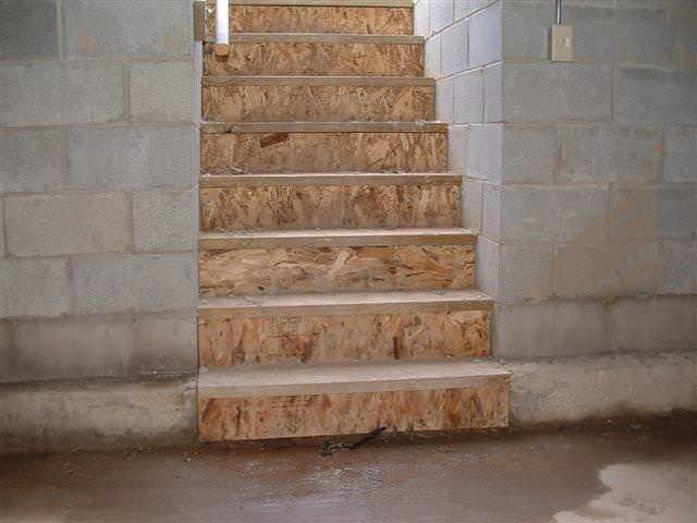

Steven Hockstein Posted July 5, 2005 Report Share Posted July 5, 2005 Hi Chad, Great photos. You are right in what you found. The construction is crap. I don't think the condensate trap is an issue because it dumps in the sump pit. I did not spend too much time studying the photos but a couple of other things jumped out at me. Are the adjustable support posts under the girder set on proper footings? The basement stair treads do not appear to have proper nosings (3/4" minimum- with solid risers) Be well. Steve H. Link to comment Share on other sites More sharing options...
patt Posted July 5, 2005 Report Share Posted July 5, 2005 Chad Manufactured not modular, Shingles Common problem, there was a air foil attached at the gable end See the Asphalt Roofing Manufacturers Associationââ¬â¢s Guidelines for Manufactured Housing. ARMA Guidelines, Sec. 4.0, Special Transit Considerations Para.2. ââ¬ÅSpecial Precautions should be used to protect the roof in transit, such as full roof covering with plastic sheet, or net,airfoils, nailer strips to hold shingles down. Any residual damage from these techniques, such as fastener penetration through exposed shingles, must repaired or replaced.â⬦â⬠Link to comment Share on other sites More sharing options...

patt Posted July 5, 2005 Report Share Posted July 5, 2005 Chad Insulation The "bottom material"/"belly paper" actually help hold the insulation in place, what you're seeing is standard. Many manufacturers place the duct work below the the floor joist and this creat a further sag in the bottom paper. The major problem you can run into is when there are tears in the material and the manufacturer uses loose insulation. Link to comment Share on other sites More sharing options...
homnspector Posted July 6, 2005 Report Share Posted July 6, 2005 Hi Chad, You are a lucky guy if this is your first "manufactured home". We call them "mobiles" here because it irritates the Realtors. Flues look wierd because they have an air space around them for relief air or combustion air. As far as I know, the condensate trap is installed to prevent bacteria growth in the evaporator, doesn't matter where it discharges, it should have a trap (remember the Legioneres deaths several years ago). Somebody correct me if I am wrong about this. Link to comment Share on other sites More sharing options...

Jim Baird Posted October 5, 2005 Report Share Posted October 5, 2005 Hey Chad, Our state regulates and monitors the maunfacturing "environment" where modular homes are made. When a "unit" comes off the line and gets "delivered" there is a certain amount of "assembly" that has to be done (big pieces crane lifted and set, then lagged together. ((sometimes squaring up is a problem and you get some funny looking sight lines)) When the pieces are together and the utilities hooked up, the installer has to put a little sticker on the inside of the electric panel (or other conspicuous location) that verifies the building has an issued production number). That gives you the comfortable knowledge that some inspection actually was carried out down at the plant. Down here in the GA woods we call those "kickers" solid risers. Those steps look to my eye like a site-built feature. They look sort of short in tread width and lacking in nosing. Link to comment Share on other sites More sharing options...
