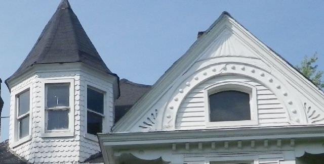

Tom Raymond Posted October 4, 2012 Report Share Posted October 4, 2012 Is that J channel around the quoins? Link to comment Share on other sites More sharing options...

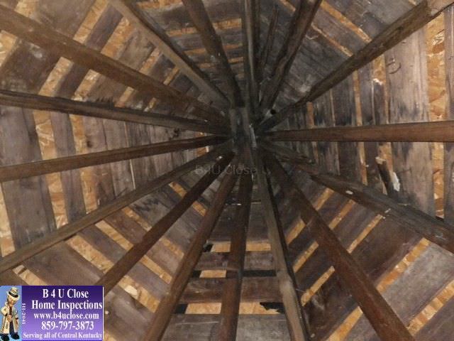

John Kogel Posted October 5, 2012 Report Share Posted October 5, 2012 Too bad they didn't add vents to that turret, now that it is sheathed solid with OSB. At least the space is accessible. Link to comment Share on other sites More sharing options...
kurt Posted October 5, 2012 Report Share Posted October 5, 2012 Very cool. I love that stuff. I see a number of these in Chicago, most sheathed with OSB. There's never any apparent problems related to lack of vents. Link to comment Share on other sites More sharing options...

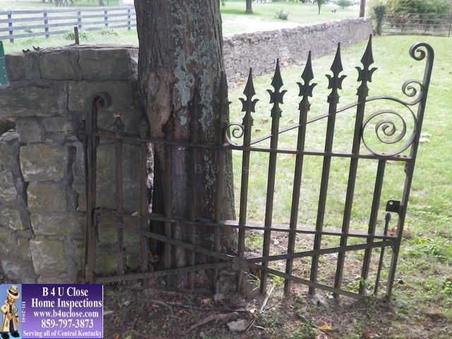

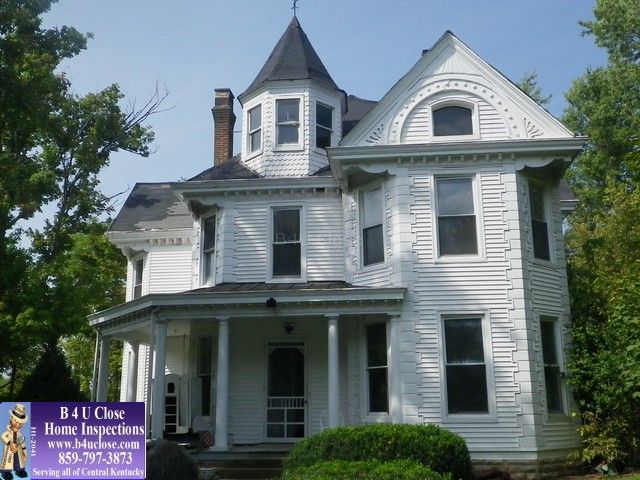

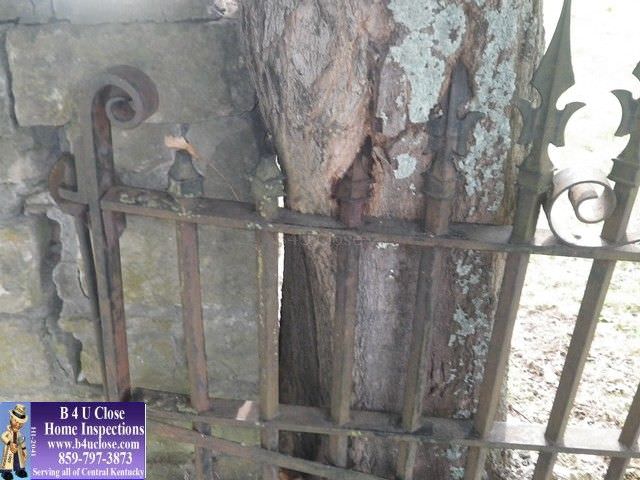

Erby Posted October 5, 2012 Author Report Share Posted October 5, 2012 Yes Tom, J Channel. Somebody's done covered most of the structure with vinyl siding. Here's a closer view of the outside of the turret and gable. The turret still has the original fish scale siding. Click to Enlarge 35.46 KB It's a welcoming place. The gate has been open so long the tree grew around parts of it. Click to Enlarge 83.47 KB Click to Enlarge 67.36 KB Link to comment Share on other sites More sharing options...
John Dirks Jr Posted October 5, 2012 Report Share Posted October 5, 2012 So it used to be wood shakes but was then converted to asphalt shingles, correct? Link to comment Share on other sites More sharing options...
Erby Posted October 5, 2012 Author Report Share Posted October 5, 2012 Yup, batten boards covered with OSB when they put the shingles on. Link to comment Share on other sites More sharing options...

Tom Raymond Posted October 5, 2012 Report Share Posted October 5, 2012 It was quite beautiful. I hope your client has the means to undo some of the injustices. If it were in that condition it my area it would be on the verge of becoming a triple. Link to comment Share on other sites More sharing options...
hausdok Posted October 5, 2012 Report Share Posted October 5, 2012 So it used to be wood shakes but was then converted to asphalt shingles, correct? More likely than not, it was cedar shingles, not shakes. ONE TEAM - ONE FIGHT!!! Mike Link to comment Share on other sites More sharing options...
hausdok Posted October 5, 2012 Report Share Posted October 5, 2012 Very cool. I love that stuff. I see a number of these in Chicago, most sheathed with OSB. There's never any apparent problems related to lack of vents. That might not be the case with this one. The moisture discoloration begins low and gets worse as one gets closer to the apex. Some of that wood higher up looks like it might already be in early second stage rot. Under the old wood shingle deck it would probably have breathed pretty well and been able to stay ahead of the moisture. Under the OSB covering, it might develop issues. I think Mr. Roofer was foolish if he didn't include a means to keep that deck dry. To be on the safe side, I think I'd have recommended a means to ventilate the turret. He might have placed some cedar breather membrane or something like it under the crest cap. In the photo you can just make out a dark line where the bottom lip of the crest cover meets the roof slope. There might be a narrow gap there filled with mesh. ONE TEAM - ON FIGHT!!! Mike Link to comment Share on other sites More sharing options...
kurt Posted October 5, 2012 Report Share Posted October 5, 2012 Maybe, I have no idea what happens in Kentucky. Around here, the skip sheathing always looks like that, usually because the old roof leaked. I'd also be highly doubtful that the old growth skip sheathing was in "early stages of rot"; I see this stuff when it's been soaking wet for a couple decades buried in joist pockets in solid masonry, and it still doesn't rot. Venting is fine if it needs it. I don't know that it needs it. If it does, vent it. Seems pretty simple. Link to comment Share on other sites More sharing options...
Erby Posted October 6, 2012 Author Report Share Posted October 6, 2012 I didn't see any rot, just water stains from past leaks. Only problem I noted was the broken rafter at the 4:00 position. These turrets are seldom vented around here. I don't see much problem from it. And hey, they actually remembered to put a guard around the attic stair case. People must have been shorter back then. Click to Enlarge 52.01?KB Hmmm, maybe I should have put all this in the Old House forum. Is it to late to change the forum? Link to comment Share on other sites More sharing options...
