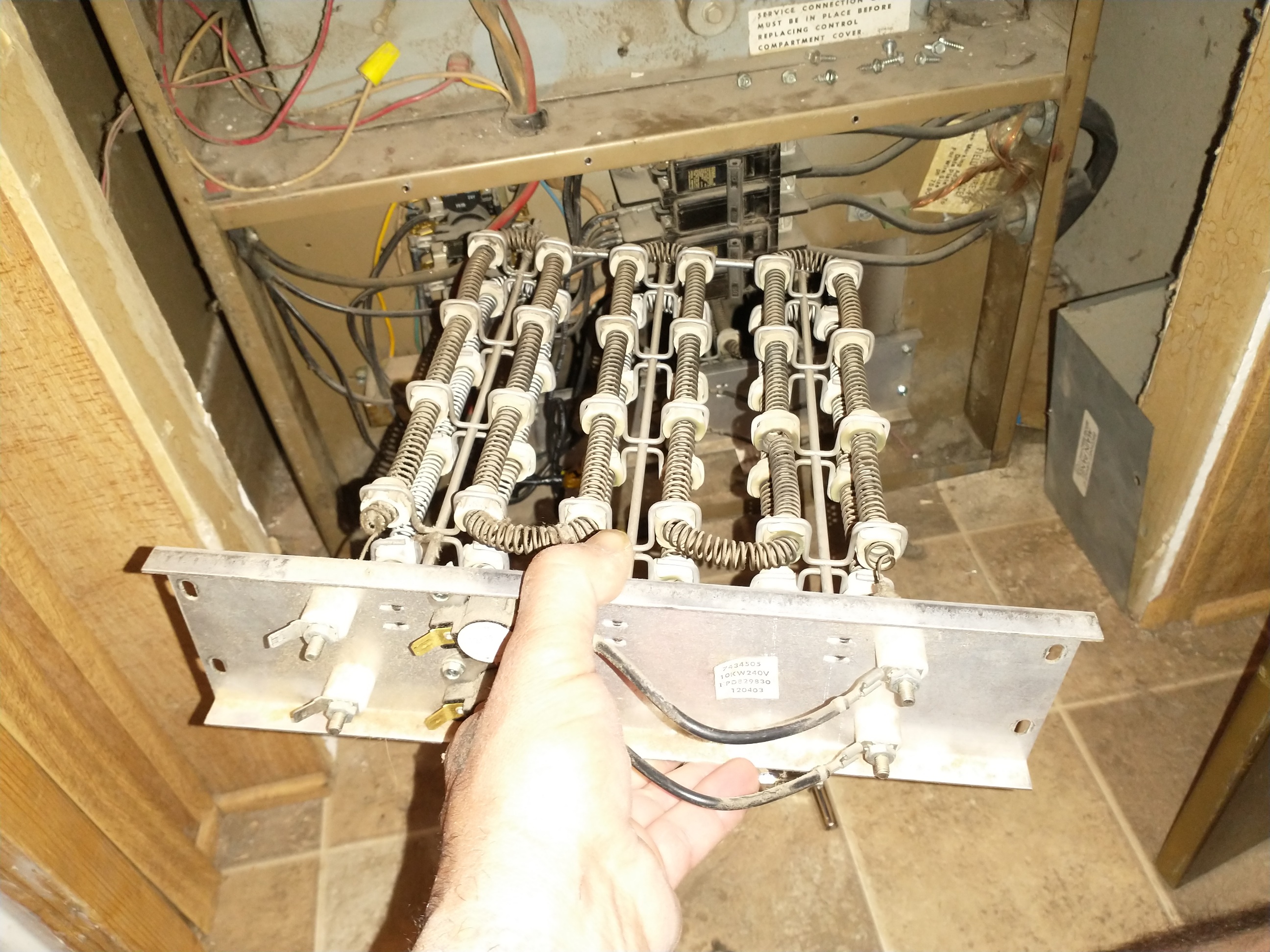

Donna L. Posted October 22, 2020 Report Share Posted October 22, 2020 (edited) Hello there. I know these posts are old but hopefully people here are still working with these Wesco heaters. We purchased a double wide mobile home and the Wesco 2100 heater does come on, blower seem to be working strong, but only warm air blows out. We are in Christmas Valley Oregon which is high desert and the winter will be brutal. The electrician that set up our power to the property looked at the heater and said we just needed the heating element (or filaments). We called a heater repair, told them what went on, they came out, charged us $200 for a diagnosis and said exactly the same thing, but wanted to replace the entire unit for $4000 instead and was not interested in the little job. I though if we could just purchase this entire tray we could install it ourselves, but can not find parts for it anywhere. Then I came across all of you who seem to know just what to do. Please give us some input or at least stear us to where we can get the parts. Thank you so much. D. Luther Edited October 22, 2020 by Donna L. add image Quote Link to comment Share on other sites More sharing options...
Jim Katen Posted October 22, 2020 Report Share Posted October 22, 2020 What's the part number? Kw rating? Physical size? You might give Vinje a call: http://www.doityourselfheating.net/ Quote Link to comment Share on other sites More sharing options...
Marc Posted October 22, 2020 Report Share Posted October 22, 2020 (edited) If an electric element is bad, you'll likely see where it's broken, just by looking at it closely, tracing the elements throughout their length. These heaters won't blow hot air, just warm air. Electric doesn't get as hot as gas-fueled furnaces. If you want to know if it works, turn it on and check the amperage. It'll draw about 16 amps for each element that's connected. For example, if three elements are connected, it'll draw about 50 amps, more or less. Still won't give hot air, just warm. Sometimes, not all elements are connected. Check to make sure they're all connected but don't connect any that are not already connected, let an AC guy do it to make sure you've enough wire to handle all elements. If you need parts, try asking Google. That's what my AC wholesaler does. Edited October 22, 2020 by Marc Quote Link to comment Share on other sites More sharing options...
Donna L. Posted October 22, 2020 Report Share Posted October 22, 2020 14 hours ago, Jim Katen said: What's the part number? Kw rating? Physical size? You might give Vinje a call: http://www.doityourselfheating.net/ Thanks for the response. I called the do it yourself heating people and they have no parts for electric heaters. I think the Wesco part # is 78804056 but I have not been able to locate that. The person that came out and looked at it said there were kits he could get to replace the elements. We looked up similar and they were about $25 each filiment, but there are 24 here on the rack and we do not know which ones are bad or if we should replace them all. Quote Link to comment Share on other sites More sharing options...
Donna L. Posted October 22, 2020 Report Share Posted October 22, 2020 Just now, Donna L. said: Thanks for the response. I called the do it yourself heating people and they have no parts for electric heaters. I think the Wesco part # is 78804056 but I have not been able to locate that. The person that came out and looked at it said there were kits he could get to replace the elements. We looked up similar and they were about $25 each filiment, but there are 24 here on the rack and we do not know which ones are bad or if we should replace them all. Oops the part number is 788 4056 Quote Link to comment Share on other sites More sharing options...
Jim Katen Posted October 23, 2020 Report Share Posted October 23, 2020 5 hours ago, Donna L. said: The person that came out and looked at it said there were kits he could get to replace the elements. We looked up similar and they were about $25 each filiment, but there are 24 here on the rack and we do not know which ones are bad or if we should replace them all. You don't have 24 filaments. That's a 20 kw furnace. It has 4 filaments in two sections. The section that you're holding in your hand in the picture is a 10 kw module with two 5kw filaments. I think that I can see a break in the upper filament. What about this Goodman/Amana module: https://controlscentral.com/tabid/63/ProductID/682253/goodman-amana-parts-bt1420034-10kw-heat-element-kit.aspx?gclid=Cj0KCQjw28T8BRDbARIsAEOMBcyrvft4o9OmPGYv7_54WN4vZL0_zAcSLWwXD2xOYq00DV8MSeOunR4aAvaUEALw_wcB It looks very similar, just check with the seller to be sure that the dimensions will be the same as your Wesco. Quote Link to comment Share on other sites More sharing options...

Donna L. Posted October 26, 2020 Report Share Posted October 26, 2020 On 10/22/2020 at 5:22 PM, Jim Katen said: You don't have 24 filaments. That's a 20 kw furnace. It has 4 filaments in two sections. The section that you're holding in your hand in the picture is a 10 kw module with two 5kw filaments. I think that I can see a break in the upper filament. What about this Goodman/Amana module: https://controlscentral.com/tabid/63/ProductID/682253/goodman-amana-parts-bt1420034-10kw-heat-element-kit.aspx?gclid=Cj0KCQjw28T8BRDbARIsAEOMBcyrvft4o9OmPGYv7_54WN4vZL0_zAcSLWwXD2xOYq00DV8MSeOunR4aAvaUEALw_wcB It looks very similar, just check with the seller to be sure that the dimensions will be the same as your Wesco. Thank you . Closest I have gotten to an actual part and we did order it. Crossing our figures now. Dimensions are a good fit. Quote Link to comment Share on other sites More sharing options...

1942 Handymans Special Posted December 20, 2020 Report Share Posted December 20, 2020 I went ahead and ordered a Restring Kit 2 elements for ~$30. Only 1 element is broken but I will just replace both. https://www.amazon.com/2-Pack-Napco-Heater-Restring-volt/dp/B0758PCK9Q I will do my best to check back in after I get the parts and install them. Quote Link to comment Share on other sites More sharing options...
