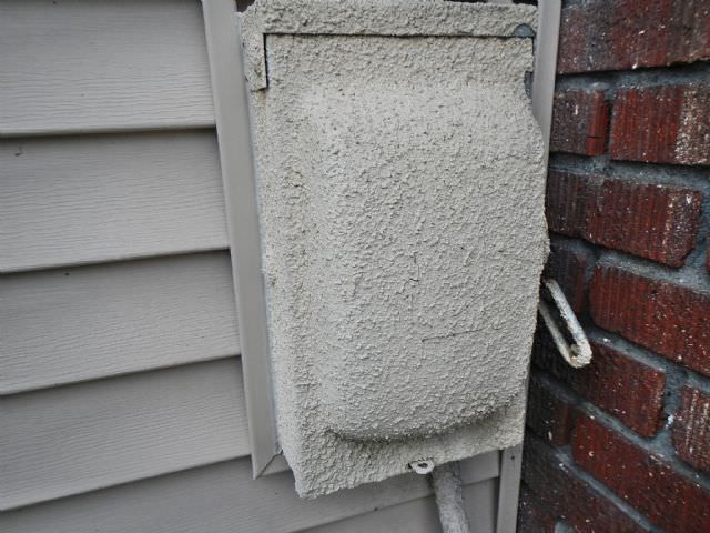

Robert Jones Posted April 22, 2013 Report Share Posted April 22, 2013 Home built in 1925. All window frames and "exposed surfaces on the exterior were sprayed with this "texture". I was told that it is under the vinyl siding as well. Guessing asbestos. Does it have a name? Click to Enlarge 46.94 KB Click to Enlarge 63.78 KB Quote Link to comment Share on other sites More sharing options...
Les Posted April 22, 2013 Report Share Posted April 22, 2013 Rob, I think the time line will be a little suspect. ie: the electrical stuff shown is not original and it was in place when the bldg was "sprayed". I don't know of any reason to splatter spray asbestos on bldg exterior. Quote Link to comment Share on other sites More sharing options...
Scottpat Posted April 22, 2013 Report Share Posted April 22, 2013 Looks like a spray on stucco finish coat. Quote Link to comment Share on other sites More sharing options...
John Kogel Posted April 22, 2013 Report Share Posted April 22, 2013 There is a brand name for that stuff - like durocoat or durok or something like that. [?] Yes, it could have been applied a couple of years ago, no way to be sure. Quote Link to comment Share on other sites More sharing options...
Wasden Posted April 22, 2013 Report Share Posted April 22, 2013 Could it be "Tex-cote"? Is it like a rubber coating? It was supposed to be better than paint. Tex-cote was sprayed on every school bungalow in So Cal that I went to (1960's-70's) and everyone peeled off. I don't know why but it was all the same color too, pale puke pink. Incredibly they are still in business. Quote Link to comment Share on other sites More sharing options...
