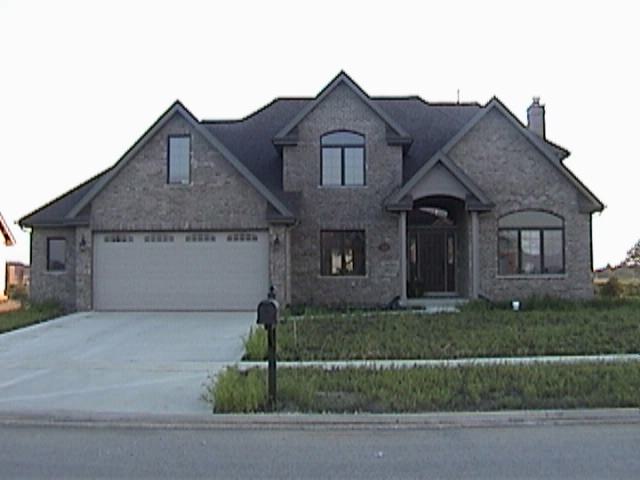

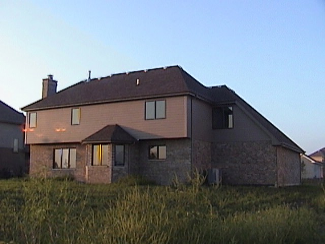

itsiceman Posted August 17, 2005 Report Share Posted August 17, 2005 I was looking for some advice on how to repair a brick veneer. I have water leaking over the top of the foundation wall around the whole house (depending on rain/wind direction)and I have found water entering through interior window trim at the top of a first floor window. My best guess is that I have multiple problems. The weep holes have been cleaned out and more added, but I thought weep holes are there to let air behind the wall not as a drain as I've been told. I have found many spots where the foundation wall is set past the brick about an inch, many serface cracks in bricks and spots where tuck pointing is required. Does the foundation look like it might be a problem? Does the cracked brick right above where the leak through the wall look like a problem? I have also noticed the second floor window sill above the leak does not have much pitch on it. Problem? Thank You in advance for any advice. Quote Link to comment Share on other sites More sharing options...
Jim Katen Posted August 17, 2005 Report Share Posted August 17, 2005 Originally posted by itsiceman I was looking for some advice on how to repair a brick veneer. I have water leaking over the top of the foundation wall around the whole house (depending on rain/wind direction)and I have found water entering through interior window trim at the top of a first floor window. My best guess is that I have multiple problems. I guarantee you have multiple problems. The weep holes have been cleaned out and more added, but I thought weep holes are there to let air behind the wall not as a drain as I've been told. You've been told wrong. Weepholes do help to equalize pressure, but their primary purpose is to let water out from behind the wall. However, they're absolutely useless in that regard unless they're paired with through-wall flashing just below the weep course. Without the flashing, water running down the back of the bricks won't know to go out the weepholes. Oh yes, adding weepholes almost always makes the problem worse since the drill usually penetrates the building paper behind the brick. I have found many spots where the foundation wall is set past the brick about an inch, many serface cracks in bricks and spots where tuck pointing is required. Does the foundation look like it might be a problem? Does the cracked brick right above where the leak through the wall look like a problem? I have also noticed the second floor window above the leak does not have much pitch on it. Problem? Thank You in advance for any advice. The lack of pitch below the window is a big problem. It should be pitched at least 15 degrees. Cracked bricks are unimportant as are minor flaws in the mortar. With brick veneer, we just count on the fact that water will penetrate the brick and run down the backside of the veneer. There's nothing in particular wrong with the foundation ledge extending past the brick. However, if this is an indication that the brick was set too far back, in contact with the wall, (without the required one-inch space) then that's a great big problem. What's that stuff that your finger is holding back at the foundation ledge? An attempt at through wall flashing? From your description and pictures, I'd say it's time to strip off the brick and start over. On the bright side, those bricks will make some fine looking garden paths. - Jim Katen, Oregon Quote Link to comment Share on other sites More sharing options...

itsiceman Posted August 19, 2005 Author Report Share Posted August 19, 2005 Thanx Jim Sounds like there isn't much I can do to repair anything wrong with the flashing[:-banghea. This is on a new home any thoughts on how to find out what is wrong for sure. Guess I need to find a good lawyer and a few good inspectors ( or maybe they will find me [:-jump2] ). Quote Link to comment Share on other sites More sharing options...
Jim Katen Posted August 19, 2005 Report Share Posted August 19, 2005 Originally posted by itsiceman Thanx Jim Sounds like there isn't much I can do to repair anything wrong with the flashing[:-banghea. This is on a new home any thoughts on how to find out what is wrong for sure. Guess I need to find a good lawyer and a few good inspectors ( or maybe they will find me [:-jump2] ). So you're the homeowner, eh? I'd thought you were an inspector. It just so happens that I saw a house with a sub-standard brick veneer job today. Here are the exact words that I put in the report (after describing the deficiencies in the installation): There's a chance that the rowlock-flashing-weephole issue could cause water damage behind the veneer. Repairs are not practical. Either accept the risk or re-install the veneer from scratch following the requirements of the building code and the BIA technical standards. My advice to you is the same. But I'll add this: the amount of risk is proportional to the amount of brick and the direction it faces. If there's a lot of brick, particularly if it's a multi-story elevation and if it faces into the weather, the risk of damage is much greater than if it's a little brick and it's on the lee side of the building. Any chance you can post full elevation shots of the house? - Jim Katen, Oregon Quote Link to comment Share on other sites More sharing options...
itsiceman Posted August 20, 2005 Author Report Share Posted August 20, 2005 sorry Jim and anyone else. Is ok to post here? Was up late trying to research this problem and came across this site. I have become more active in investigateing this problem. We have had water in the front three times and once in the back (depends on th wind)in three months(and we are in a drought!). It has been going nowhere slow with our builder. It has been brought up by are super about a sealer but I thought this would be a bad cover up. Any thoughts? Any way I've about had it with being patient with the builder. Thank you Jim for being so helpful.Can anyone recomend an inspector? Quote Link to comment Share on other sites More sharing options...

itsiceman Posted September 16, 2005 Author Report Share Posted September 16, 2005 Jerry, Thank you again for coming all the way down here. I told my builder about the thermal image test to try and find where the water is coming in. They might get one done. Just checking for any more info on who can do the testing. Anyway the pitch on the sill above the dining room has been corrected. Today it rained with the water hitting the front of the house and we have water entering again in multiple spots! Yesterday it rained in the back and water was entering in multiple spots! This is the most expensive Tee-Pee I've ever owned.[:-weepn] Quote Link to comment Share on other sites More sharing options...
Jim Katen Posted September 16, 2005 Report Share Posted September 16, 2005 Originally posted by itsiceman . . . Anyway the pitch on the sill above the dining room has been corrected. Today it rained with the water hitting the front of the house and we have water entering again in multiple spots! Yesterday it rained in the back and water was entering in multiple spots! This is the most expensive Tee-Pee I've ever owned A thermograph might show where water is entering today, but it might not show where water will enter tomorrow. Besides, keeping water out from behind brick veneer is sort of a fool's errand. The water *is* going to get back there. You've got to have a method of capturing and disposing of the water once it's gotten back there. I'm afraid that the proper solution here is to strip off the brick and start over. I'll bet that you've got some reverse lapped felt or Tyvek behind it as well as probably a half dozen other installation screw-ups. (General rule of home construction: When a builder screws up the parts of the house that you *can* see, there are always more screw-ups in the parts that you *can't* see.) I'd get a lawyer. - Jim Katen, Oregon Quote Link to comment Share on other sites More sharing options...

kurt Posted September 16, 2005 Report Share Posted September 16, 2005 I'm flattered to have been mentioned by Jim as someone who could figure it out, but from all I've read, Jim (and everyone else) already has it nailed. If there's no flashing, that's it. Period. Forget caulk & sealants; they will NOT correct the problem. Sorry to have to utter these words, but it's time to put the builders feet in the fire. Quote Link to comment Share on other sites More sharing options...
Jerry Simon Posted September 16, 2005 Report Share Posted September 16, 2005 I met with Iceman yesterday, and he will end up having to take all the brick off the home. Some of the areas where the water shows up indicate the wall cavity is full of mortar droppings, and aside from all the other weep and flashing problems, the water can't even get down to the weeps. A thermal imaging, right after a rainfall or a soaking-down with a hose, will show where the water gets in (multilple areas), where it travels, and where it ends up. I imagine it will show water ponding atop the mortar-filled wall cavities. Short of tearing off a lot of brick, this should be definitive proof of the problem, and all the ammo he'll need to start from scratch. Too bad...nice folk live there. Quote Link to comment Share on other sites More sharing options...

itsiceman Posted November 1, 2005 Author Report Share Posted November 1, 2005 Update: I have asked the builder to start over from scratch with the brick install. They proposed taking off the first four rows of brick in four foot sections, replacing the flashing around the whole house and then sealing the brick on the whole house. My gut feeling is not to accept this offer. Any thoughts? P.S. I found a spot for a peek behind part of a wall (air gap). Quote Link to comment Share on other sites More sharing options...
Jim Katen Posted November 2, 2005 Report Share Posted November 2, 2005 Originally posted by itsiceman Update: I have asked the builder to start over from scratch with the brick install. They proposed taking off the first four rows of brick in four foot sections, replacing the flashing around the whole house and then sealing the brick on the whole house. My gut feeling is not to accept this offer. Any thoughts? P.S. I found a spot for a peek behind part of a wall (air gap). The four-foot-at-a-time-replacement thing is actually from the BIA tech notes. It's their recommended fix for installing through-wall flashing retroactively. Unfortunately, you've got more than just missing through-wall flashing. There're issues around windows as well. Also, as your latest picture shows, they've got blobs of mortar touching the Tyvek. (Another no-no.) Also, we're hearing about sealer again. Oy! It's like a guy who is facing triple bypass surgery who asks his doctor if he can't solve the problem by eating some oats. They're good for his heart, aren't they? If you don't already have one, get a lawyer. No, wait, get two. Mean ones with sharp teeth. Tell them to convince this builder that he has to strip off every brick and start over, while your inspector documents the entire job. - Jim Katen, Oregon Quote Link to comment Share on other sites More sharing options...
