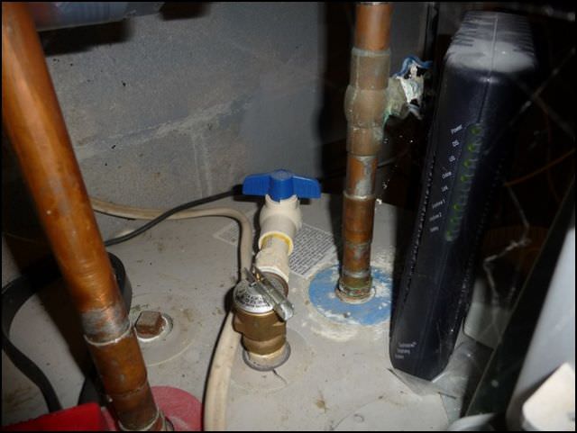

Steven Hockstein Posted May 14, 2013 Report Share Posted May 14, 2013 Really? Click to Enlarge 40.18 KB Quote Link to comment Share on other sites More sharing options...
Robert Jones Posted May 14, 2013 Report Share Posted May 14, 2013 Did you stage that? Quote Link to comment Share on other sites More sharing options...
Steven Hockstein Posted May 15, 2013 Author Report Share Posted May 15, 2013 I promise that this was not staged although it is astonishing how blatant this was and I felt the need to share it. I took this photo at my inspection this morning. Quote Link to comment Share on other sites More sharing options...
Erby Posted May 15, 2013 Report Share Posted May 15, 2013 Picture is blurred out with the flash. Can't hardly read what it says. Quote Link to comment Share on other sites More sharing options...
kurt Posted May 15, 2013 Report Share Posted May 15, 2013 It's an AHJ Plumbing Approval slapped on a TPR that lacks a discharge pipe. Kind of an art piece. Quote Link to comment Share on other sites More sharing options...
