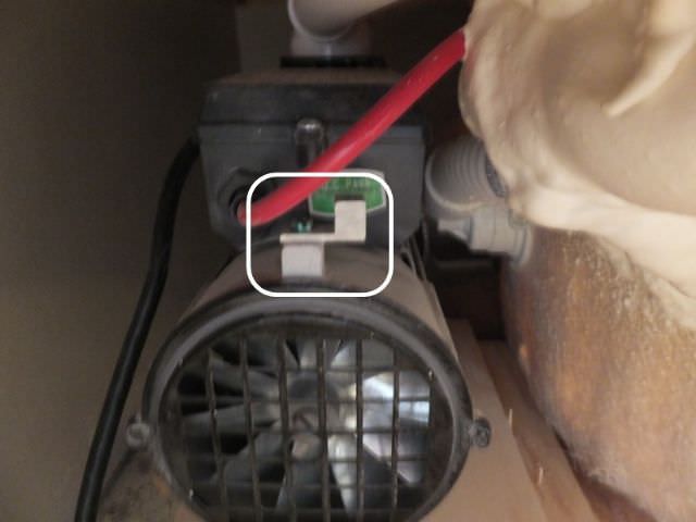

Marc Posted February 26, 2014 Report Share Posted February 26, 2014 Can someone point me in the general direction of cites relating to the grounding of jacuzzi pump motors? Today's jacuzzi had a ground lug so I'm assuming it isn't a double insulated model. The fresh water supply is PEX but I suspect PEX doesn't make it ok to leave that ground lug hanging. Thanks. Marc Click to Enlarge 31.97 KB Quote Link to comment Share on other sites More sharing options...
Bill Kibbel Posted February 26, 2014 Report Share Posted February 26, 2014 I don't have a reference in front of me, but that external terminal is for bonding, not grounding. The motor should be grounded with the cable's ground conductor. Hydromassage pump motors are to be bonded to associated metal parts and metal piping systems. If there's no metal for supply and drain or other tub parts, there's nothing to bond. Quote Link to comment Share on other sites More sharing options...
Marc Posted February 26, 2014 Author Report Share Posted February 26, 2014 Makes sense. The faucets are metal. I'll see if I can return to look again. Thanks. Marc Quote Link to comment Share on other sites More sharing options...
Scottpat Posted February 26, 2014 Report Share Posted February 26, 2014 Makes sense. The faucets are metal. I'll see if I can return to look again. Thanks. Marc The faucets are a moot point if you have PEX and PVC! No need for bonding....... Quote Link to comment Share on other sites More sharing options...
kurt Posted February 26, 2014 Report Share Posted February 26, 2014 Throw in the other fact that all the piping for the spa is plastic, and water by itself isn't conductive, and the need for bonding is arguably silly. Isn't it? Quote Link to comment Share on other sites More sharing options...
mjr6550 Posted February 26, 2014 Report Share Posted February 26, 2014 The NEC used to say that bonding was not required on residential installations, unless required by the manufacturer. I don't know if that is still the case. I would go with what the manufacturer requires. My pool pump is bonded and all of the connecting piping is plastic, which is typical. Quote Link to comment Share on other sites More sharing options...
John Kogel Posted February 26, 2014 Report Share Posted February 26, 2014 How do you connect a bonding strap to a faucet? You don't. If there is no copper pipe over 10 feet in length, a plumbing bond is not required. Don't quote me, but that is a rule of thumb if you can't find a better one. As Bill said, the electrical is grounded/bonded by the grounding conductor. Quote Link to comment Share on other sites More sharing options...
mlparham Posted February 26, 2014 Report Share Posted February 26, 2014 Throw in the other fact that all the piping for the spa is plastic, and water by itself isn't conductive, and the need for bonding is arguably silly. Isn't it? Very silly and useless. Certainly a "Top 10" bad finding by home inspectors to ask for bonding in this situation. Quote Link to comment Share on other sites More sharing options...

Jack Davenport Posted February 27, 2014 Report Share Posted February 27, 2014 I will assume you are talking about a Hydromassage Bathtub as Jacuzzi is a brand name. The bonding of such is covered in Part VII of section 680 in the NEC. From the 2011: 680.74 Bonding. All metal piping systems and all grounded metal parts in contact with the circulating water shall be bonded together using a solid copper bonding jumper, insulated, covered, or bare, not smaller than 8 AWG. The bonding jumper shall be connected to the terminal on the circulating pump motor that is intended for this purpose. The bonding jumper shall not be required to be connected to a double insulated circulating pump motor. The 8 AWG or larger solid copper bonding jumper shall be required for equipotential bonding in the area of the hydromassage bathtub and shall not be required to be extended or attached to any remote panelboard, service equipment, or any electrode. The 8 AWG or larger solid copper bonding jumper shall be long enough to terminate on a replacement non-double-insulated pump motor and shall be terminated to the equipment grounding conductor of the branch circuit of the motor when a double-insulated circulating pump motor is used. Quote Link to comment Share on other sites More sharing options...

Jim Katen Posted March 1, 2014 Report Share Posted March 1, 2014 . . . probably overthinking this, but - isn't there metallic contact within the pump (shaft, etc.) and the circulating water? No. There isn't. The water only touches plastic - at least in the one that I took apart. Quote Link to comment Share on other sites More sharing options...
Jim Port Posted March 1, 2014 Report Share Posted March 1, 2014 I agree that no bonding would be needed with the plastic pipe. I could also make the same claim even with copper feeding the tub since it is not touching the circulating water. Quote Link to comment Share on other sites More sharing options...
Jack Davenport Posted March 2, 2014 Report Share Posted March 2, 2014 I don't think the pump shaft is energized normally, unless of course, the windings are shorted to it, that's possible. So if there is 120 volts on the shaft, it will take the path of least resistance back to the source. It is not going to flow though a foot of water if it can take the metal path back to the junction box and the cable. But the rule isn't worded very clearly, I agree. The current will take ALL paths to get back to the source, not just the path of least resistance. There may be more current on the path of least resistance but the will be current on all paths. Saying that current will take the path of least resistance is incorrect and misleading. Quote Link to comment Share on other sites More sharing options...
Jack Davenport Posted March 2, 2014 Report Share Posted March 2, 2014 Ok here's when you need to bond the hydromassage tub. The requirement for bonding applies ONLY if you have two (2) things: (1) a motor that isn't double insulated and (2) a metallic water piping system. IF you have BOTH of these you need to bond them together. If either of those two items is not there you can't possibly bond them together since one of them is nonexsitent. Quote Link to comment Share on other sites More sharing options...
