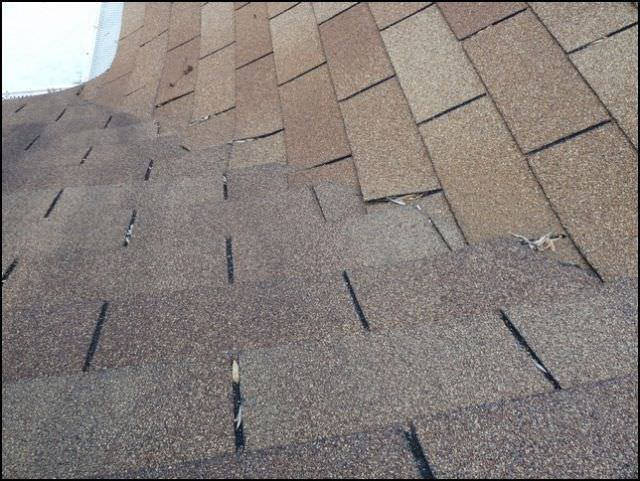

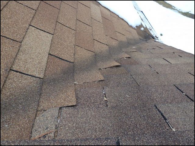

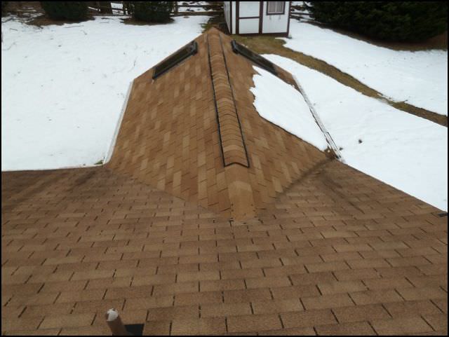

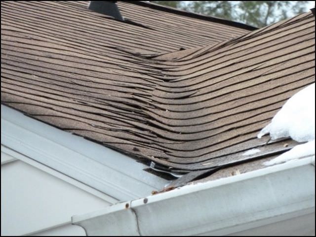

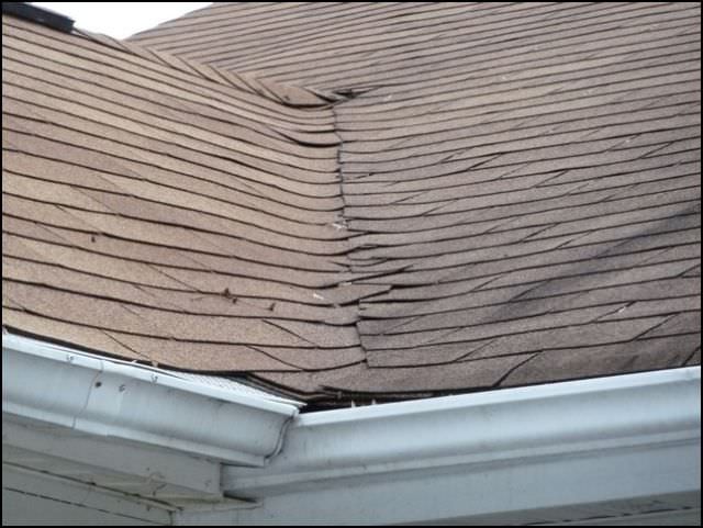

John Dirks Jr Posted March 2, 2014 Report Share Posted March 2, 2014 The overall condition of the shingles on this roof was not all that bad. I gave them at least 5 yrs remaining life. Obviously, the valley work where the porch roof was installed (at a later date) looks unprofessional. What would be the minimal involvement in getting this corrected? How far up each slope would shingles need to be removed before re-installing a decent valley? Click to Enlarge 47.55 KB Click to Enlarge 80.87 KB Click to Enlarge 66.51 KB Click to Enlarge 65.69 KB Click to Enlarge 80.08 KB Quote Link to comment Share on other sites More sharing options...
David Meiland Posted March 2, 2014 Report Share Posted March 2, 2014 What's with the black outline around the ridge vent? Is that cor-a-vent exposed because the ridge caps are too small? That's a couple days of work to repair--a long day with a helper, two if alone. Assuming nothing else was wrong (like the ridge vent or the skylights) I would strip both sides of each valley one shingle wide, possible a little wider depending on what's found underneath, and then re-install it either as a cut or metal valley. It is really painstaking to tuck new shingles under existing and get them fastened. It's around a couple thousand dollars, and if it goes to hell.... more. If there are only five years left, there's a strong argument for a new roof. Quote Link to comment Share on other sites More sharing options...
John Dirks Jr Posted March 2, 2014 Author Report Share Posted March 2, 2014 Thanks for your response and assessment David. I have no idea why they even put a ridge vent on there. Probably to charge more money. It isn't even needed since roof is covering an exterior screened porch and the ceiling is vaulted pretty much up to the roof deck. Airspace gap is the width of the rafter I suppose. Quote Link to comment Share on other sites More sharing options...
Marc Posted March 2, 2014 Report Share Posted March 2, 2014 The remodeler cut corners. It you're going to recommend repair, I'd suggest remove all shingles within 20 inches of the center of the valley (3 foot width plus a little)and do it over. Follow all recommendations of the shingle manufacturer, in regards to both shingles and flashing. Marc Quote Link to comment Share on other sites More sharing options...
John Kogel Posted March 2, 2014 Report Share Posted March 2, 2014 I see they cut some and wove some in the thrd or 4th pic. [:-party] I wouldn't feel much confidence in any of that addition roof. I will bet they fudged on the underlay as well. Who knows how many nails per shingle and where they placed them. To repair, they need to bend the old shingles up to nail below, as David described it, mucho trouble that might still lead to leaks. I would tell them what the roofer will tell them, tear it off, sorry about that. They can cut the large side, but it won't get renailed all that well. A roofer wants to guarantee his work, tough call there. Quote Link to comment Share on other sites More sharing options...

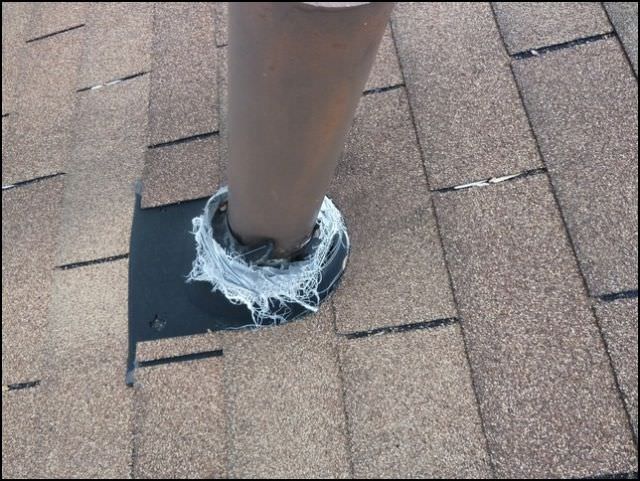

John Dirks Jr Posted March 3, 2014 Author Report Share Posted March 3, 2014 Why did you only give it 5 years? I gave them "at least 5 years". The owner moved in in '93 and those were the shingles on the main part, not including the porch addition. So, they are already 21 years old. Albeit, they were in good shape for that age. Good granular adhesion but beginning to get a little brittle. The pipe collars were totally shot. Owner had wrapped duct tape around them and it was worn away too. Click to Enlarge 84.88 KB Quote Link to comment Share on other sites More sharing options...
