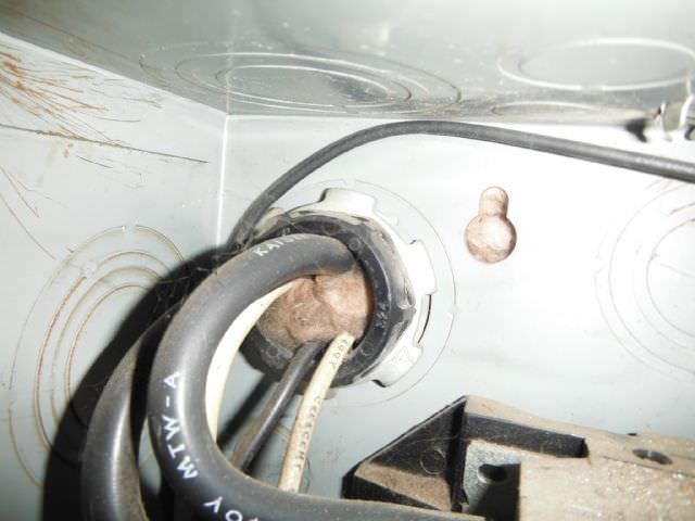

Mike Lamb Posted July 31, 2014 Report Share Posted July 31, 2014 I think I have seen this asked before but do not remember the answer. Is it okay to back feed wires into the meter box? In this case a pipe runs out of the meter to the air-conditioning. Click to Enlarge 41.63 KB Quote Link to comment Share on other sites More sharing options...
Marc Posted July 31, 2014 Report Share Posted July 31, 2014 230.7 Other Conductors in Raceway or CableConductors other than service conductors shall not be installed in the same service raceway or service cable. Marc Quote Link to comment Share on other sites More sharing options...
