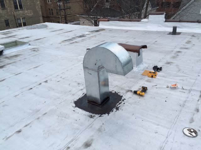

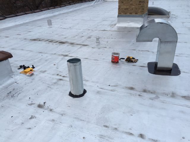

kurt Posted December 18, 2014 Report Share Posted December 18, 2014 Thought this was nice. Fabricated with hand tools. Every seam and edge hemmed and the soldering is perfect. Delivered pre-primed. Just gotta torch and strip it this weekend. Click to Enlarge 42.88 KB Click to Enlarge 46.87 KB Quote Link to comment Share on other sites More sharing options...

Mike Lamb Posted December 18, 2014 Report Share Posted December 18, 2014 What does the goose exhaust? Quote Link to comment Share on other sites More sharing options...
kurt Posted December 18, 2014 Author Report Share Posted December 18, 2014 An 800 cfm range hood. New range with an 18,000 btu wok burner needs good exhaust. 8" pipe straight up out of the fan, through the roof. The radius minimizes turbulence and static pressure. The sucker really moves some air. Quote Link to comment Share on other sites More sharing options...

Chad Fabry Posted December 18, 2014 Report Share Posted December 18, 2014 An 800 cfm range hood. New range with an 18,000 btu wok burner needs good exhaust. 8" pipe straight up out of the fan, through the roof. The radius minimizes turbulence and static pressure. The sucker really moves some air. I have an 800 cfm fan too. I get agita very time it's on in the winter. It's a fancy thing and it turns itself on in response to high temp or high humidity. It'll suck the heat out of your house like every door is open. It ain't your standard range hood. Quote Link to comment Share on other sites More sharing options...
kurt Posted December 18, 2014 Author Report Share Posted December 18, 2014 Nice. What about noise? Baffled? Metal looks cool when it is new and can tell stories when it gets a little patina. It's a little loud when it's in full burst mode @ 800 cfm. At lower rpm's it's remarkably quiet. There's a baffle on top of the hood, and we stuck another one in the 8" duct....gasketed, springs so it doesn't rattle. Quote Link to comment Share on other sites More sharing options...
David Meiland Posted December 18, 2014 Report Share Posted December 18, 2014 I like the roof access too. What's the round pipe? Quote Link to comment Share on other sites More sharing options...
kurt Posted December 18, 2014 Author Report Share Posted December 18, 2014 That's the 8" out of the fan. The gooseneck (9" square) slides over it. Standard back porch hatch to the roof. I'm going to have a garden up there next Spring. Tomatoes mostly. Quote Link to comment Share on other sites More sharing options...
