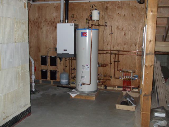

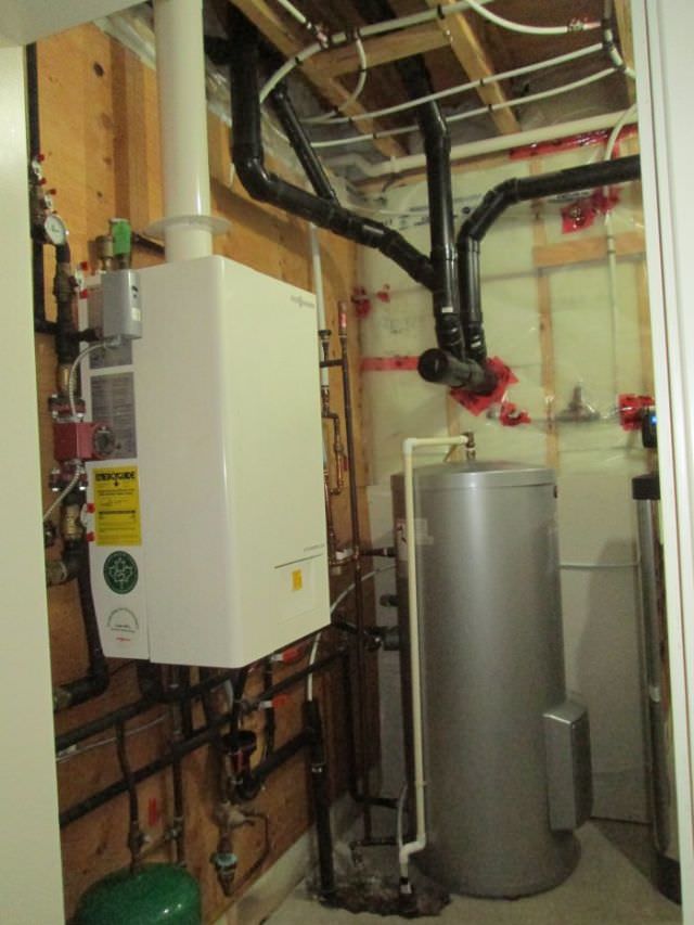

Marc Posted January 23, 2015 Report Share Posted January 23, 2015 Anyone have a diagram or description of how a tankless heater, regular heater, radiant heating system and fresh water supply are all connected together? Marc Quote Link to comment Share on other sites More sharing options...
John Kogel Posted January 23, 2015 Report Share Posted January 23, 2015 Marc I could search for pics. The domestic supply is kept separate by running a pipe with a check valve to the heating loop. That supply Tee will have a shutoff valve and the check valve supplies make-up water to the closed loop when it is needed. Here are two systems both with tanks added. The first was a residence of about 2400 sq ft. This was a repo, not completed. The big Veismann system 3rd pic was in a colossal residence with a theatre and games room but only 3 bedrooms. Click to Enlarge 47.89 KB Click to Enlarge 37.04 KB Click to Enlarge 74.99 KB Quote Link to comment Share on other sites More sharing options...
