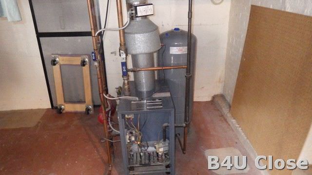

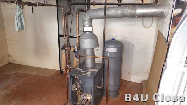

Erby Posted February 27, 2015 Report Share Posted February 27, 2015 I see one maybe every two years. Don't know a whole hell of a lot about them. Any thoughts on this one. Click to Enlarge 49.19 KB Click to Enlarge 40.4 KB Click to Enlarge 61.72 KB Click to Enlarge 42.9 KB Click to Enlarge 34.78 KB Click to Enlarge 40.5 KB Click to Enlarge 44.81 KB Click to Enlarge 40.78 KB Click to Enlarge 42.92 KB Click to Enlarge 54.51 KB Click to Enlarge 53.67 KB Click to Enlarge 48.27 KB Quote Link to comment Share on other sites More sharing options...

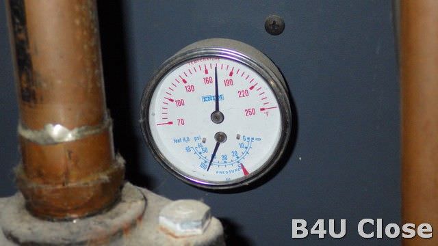

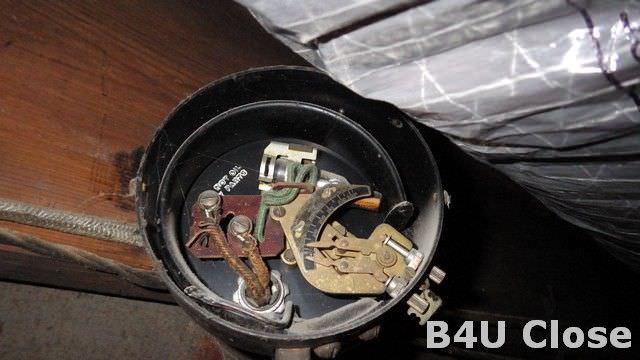

John Kogel Posted February 27, 2015 Report Share Posted February 27, 2015 Just think of it as a glorified moonshine still and you'll do ok. [] Weil-McClain is a good brand of boiler, IMO. The pressure seems to be high, IMO. Maybe the gauge is hooped (faulty). That other control unit looks unreliable. It is all about 40 or 50 years old, and maybe the pipes are even older. The tank up in the ceiling is old school and there is a new pressure tank installed. The prerssure relief valve ought to be replaced for safety. I think the whole installation needs to be serviced by a competent boilerman. Quote Link to comment Share on other sites More sharing options...
Tom Raymond Posted February 27, 2015 Report Share Posted February 27, 2015 How big is the house? In my climate anything over 1000sf or more than one floor would have multiple loops. With a single loop you could have balance issues. Quote Link to comment Share on other sites More sharing options...

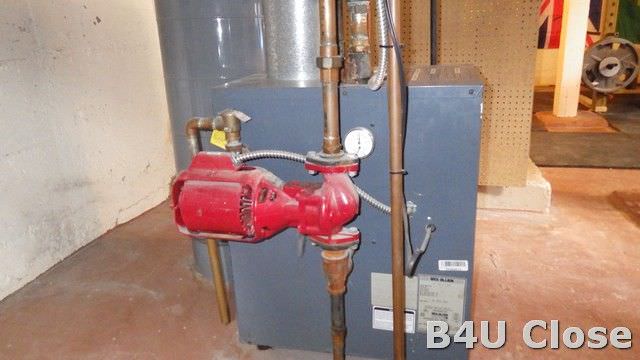

kurt Posted February 27, 2015 Report Share Posted February 27, 2015 Pressure gauge is whacked, otherwise the TPR would be spewing. Otherwise, reasonably tidy...nice Bell & Gossett circulator. I like Weil McLain. My steam boiler is a Weil Mclain LGB series. Flush and service, it's common to get 30+ years out of them. Boiler people get real obsessive, and it's fashionable to diss Weil Mclain in favor of Buderus, Burnham, some folks like Peerless, etc., etc. IMO, they're all chunks of cast iron and life is totally dependent on the guy putting the sections together. If they did it right, they last, if they didn't, they don't. I look at Weil Mclain like a Chevy...a decent working man's boiler. Where do you get 40-50 years old? CG Series 1 was manufactured from 1999 to present. At most, it's about 15 years old. The whacked pressure gauge is from the old unit, the tank in the ceiling is the old abandoned expansion tank. I'm sure I could find odds and ends if I got obsessive, but it's looks reasonably tidy. Circulation issues would be my main concern, as Raymond indicated. That said, sometimes you can do it "wrong" and everything still works OK. Fire it up, wait a half hour, go around and check all the radiators. If they're hot at the bottom and cold on top they need bleeding. Not hard to figure out that part. Check all the valves...pretty common to find them stuck open. Quote Link to comment Share on other sites More sharing options...

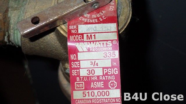

kurt Posted February 27, 2015 Report Share Posted February 27, 2015 Gauge sez 40psi, TPR rated to blow @ 30 psi. Whoever works on it gets to figure out if it's the gauge or the TPR. Gauges are highly fallible, TPR not so much. Of course, one might refer it to a competent qualified hairdresser and dodge the call.....but I don't usually do it that way. Quote Link to comment Share on other sites More sharing options...
mjr6550 Posted February 27, 2015 Report Share Posted February 27, 2015 I assume the old limit control is not used. A control is inside the boiler. The expansion tank is larger than needed for almost any size house, but that is not a problem. If the pressure gauge is reading correct, then I'd be real concerned. Gauges seldom go bad, but it does happen. Pressure relief valves can plug up. Quote Link to comment Share on other sites More sharing options...
kurt Posted February 27, 2015 Report Share Posted February 27, 2015 I see the opposite. Failed gauges all the time. Constantly. TPR's, especially one that's about 15 years old....not likely. Quote Link to comment Share on other sites More sharing options...
Bill Kibbel Posted February 27, 2015 Report Share Posted February 27, 2015 The pressure/gauge is an issue. pressure should be around 5 PSI per 8' rise. Weil Mclain is a simple but good boiler. The push nipples between the cast iron sections can fail on older models at about 20-35 years. Now they use O-rings that can fail at about 20-35 years. There's a white sticker on W/M boilers with numbers after "CP". Enter the numerals for the age here: http://www.weil-mclain.com/en/weil-mcla ... cp-lookup/ Quote Link to comment Share on other sites More sharing options...
Rob Amaral Posted February 28, 2015 Report Share Posted February 28, 2015 Not that old... see these all the time... amen to all the above.. I'd have checked the boiler aquastat 'set temp' vs the 'gauge' temp... looks like the boiler might be kind of small for the load?? These are usually set to run at 180 Deg F (and this gauge says that.. which would be good).. but what is the 'set temp'? The pressure-reading may just be a faulty gauge.. I tap those a few times..often,, it will change right in front of your eyes.. No thimble at the chimney breech area... huge expansion tank.. was this a huge house Erby??? Those older larger-diameter distribution pipes impose a substantial load.. especially likely being un-insulated pipes... Quote Link to comment Share on other sites More sharing options...

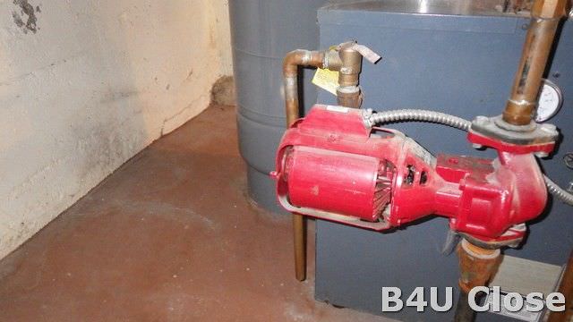

Hearthman Posted March 5, 2015 Report Share Posted March 5, 2015 Sediment trap on gas gas pipe may not be properly supported Is the shutoff within 6ft of the appliance valve? Merchant coupling on gas riser vent connector not supported Is this chimney lined with a listed liner? Regardless, there should be a reasonable access to the base of the chimney and that shiny pipe sticking out of the wall means either a joint in the wall or inadequate access. If unlined, it should be lined Where's the clean-out if unlined? behind pegboard would be too low Ensure min. three equidistantly spaced screws per joint on vent connector Need backflow preventer Need low water cutoff should have some means of air removal even though not code That's a pressure relief valve-not a temperature/ pressure relief or TPR as used on water heaters. Good pickup on the 40lb. gauge pressure on a #30 relief. Watts recommends replacing PRVs about every three years anyway. While legal, the circulator on the return is less desireable than putting it on the supply. Get Dan Holohan's book on "pumping away. Need to check expansion tank to see if it is water logged or not and if drain and isolation valves work. Need isolation valves on that indirect tank with a check valve for one-way flow. Need drain cock on the indirect loop Ideally should have primary/secondary piping when this boiler replaced or at min. a bypass with a globe valve to temper the return water. These old Weil-Mc's are all over Philly and chug along. Not especially efficient but they get the job done. The burners do crud up so get it serviced. The relay and the vent damper are the common failures in these units over time. How do you vent an appliance with a 7" vent connector into a masonry chimney with a nominal 8"x8" flue that has an actual 6.5" x 6.5" ID? This is why I disdain W/M boilers. They always oversize their vent connectors and draft hoods. A 7" for 140 MBH? Ridiculous. It would need only a 5" B-vent. Do you have you MUA at 50 cubic feet x 140? That's about a 1,000 square foot basement required or MUA. Grounded 120 vac service outlet within 25 LF of boiler? Switched light to space with sufficient lighting for service? Electrical disconnect within sight in same room clearly identified? FYI, you can test pressure gauges for accuracy by attaching your simply hose bib pressure gauge on the boiler drain and opening the cock to read the actual static pressure and compare. I put an isolation valve on all boiler tricator gauges because they are so prone to failure. Quote Link to comment Share on other sites More sharing options...
